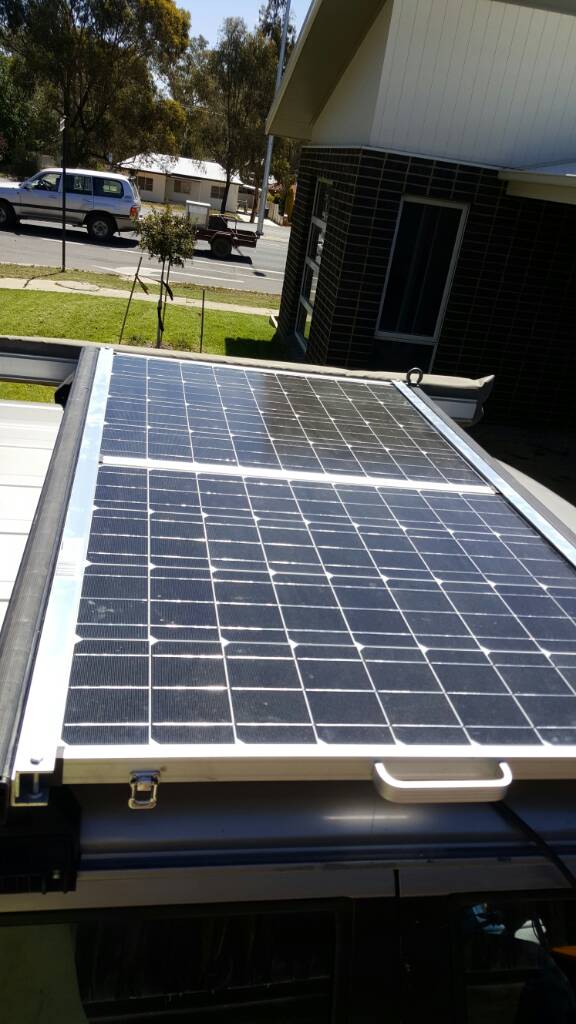

    what size panel I have a spare 80 watt here I may do similar with lol ??
    I have a 160w foldable mounted on rhino roof racks and removable.

    Now would you run this to your AUX battery or have it switchable so the start can get some love as well

    Up under the front deflector is that too far away from the battery for you ???
    If you need to weather proof it whip done to Safeways and grab a tupperware
    dish to suit.
    I wouldn't put it on the roof anywhere, MPPT should as close to the Aux Battery as practicable
    @sooty_10
    I currently have a piranha dbs which has no interconnect or dual sense. Also contemplating down the track upgrading to the redarc sbi212d dual sense one. Currently looking at hooking only through aux.
    Yeah not going roof mount for it. Either under bonnet/behind dash or in rear on cargo barrier.

    Yeah I was led to believe the closer to the battery the better, how about in
    the foot well on the left hand kick panel. Its only a short run to the Aux battery from there.
    Yeah one of my contemplated options. I might even add a fusebox / junction in behind there somewhere.
