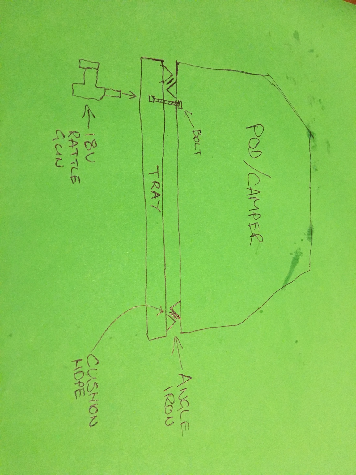

    Another wacky drawing below for easy left and right alignment via opposing offset angle iron steel when loading the camper on your own.
    And just back up against a tree to shove it forward more if needed, then bolt her down :-)

    @MB loving the rattle gun, which ever way you decide I'd be using some conveyor
    belting to insulate it so you dont have steel on steel.

    Impact driver/Rattle gun was @Old Wal 's idea above TD, I just captured it artistically :-)
    Conveyor belt rubber is great but can be a bit hard to slide over especially if on your own. I'm a big fan of HDPE & LLDPE as was pictured in my scribble. Very hard wearing, especially HDPE and both are slippery as for hip & shoulder tackle alignment.
    http://www.dotmar.com.au/hdpe.html
    Haven't purchased off Dotmar before but they have a great range of extruded profiles on their web too.
    http://www.dotmar.com.au/extruded-pl...-profiles.html
    Something like R125 profile to cap angle iron could work hopefully.
