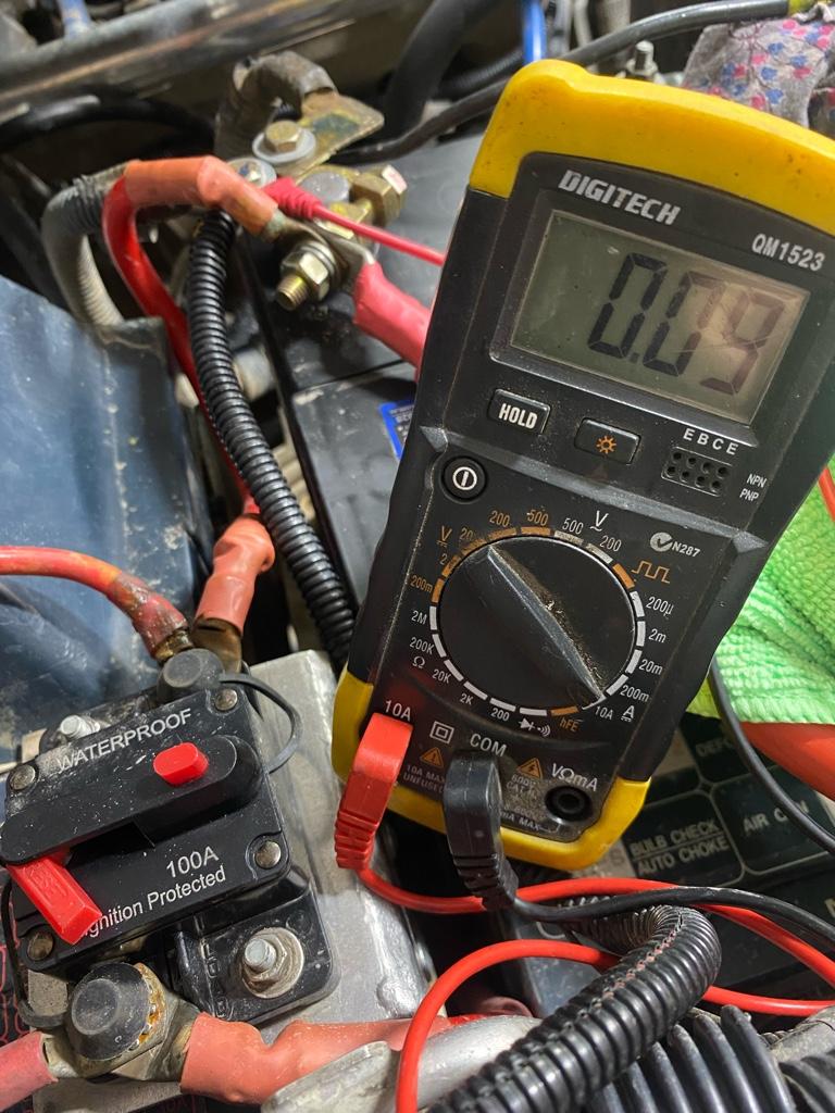

    So I have found the culprit, but not sure how to fix it.
    This first pic looks of the dmm you can see the circuit breaker is off.
    This breaker is fed from the main battery and goes to a fuse block, this fuse block feeds power to each relay, Oem and aftermarket in the original relay housing.
    Probably 10 years ago I modified the relay box to house all the added relays that were strewn all through the engine bay. It has worked really well.
    This is what happens when i activate the breaker.
    I tracked it down to fuse number 4, which feeds the relay for the spot lights.
    I remove the fuse, the reading drops. I put the fuse back in and remove the relay. Nothing. It stays the same!
    Why?
    This is about as far as my lecky knowledge goes with fault finding.
    Any ideas for what to do next?
    I removed every relay also with no change.
