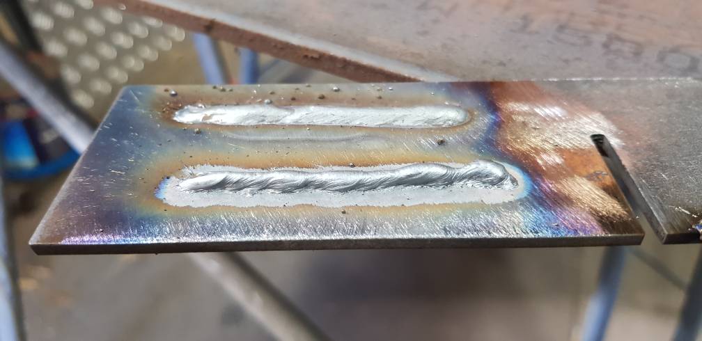

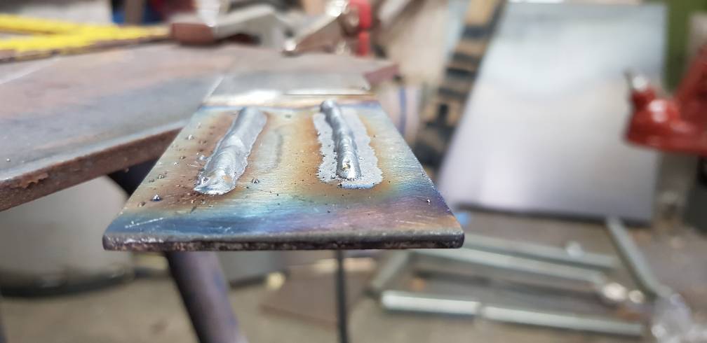

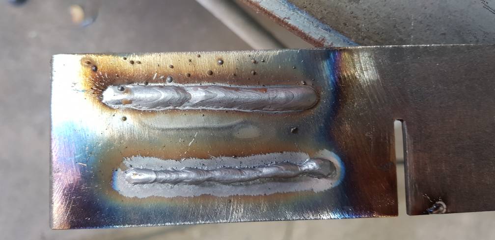

    As you'll see below the argosheild is a far smoother, flatter and consistent weld.. (left and top)
    I simply swapped to argon, and left everything else the same, even the 12lpm flow rate.
    As you can see it's much rougher, taller and looks cold. (Right and bottom)
    You can also noticeable hear the difference..
    You can also see the wide silver ring around the argon. That's the arc wandering. Because argon doesn't carry the arc as well it wanders, which creates that cold affect as the heat is wasted..
