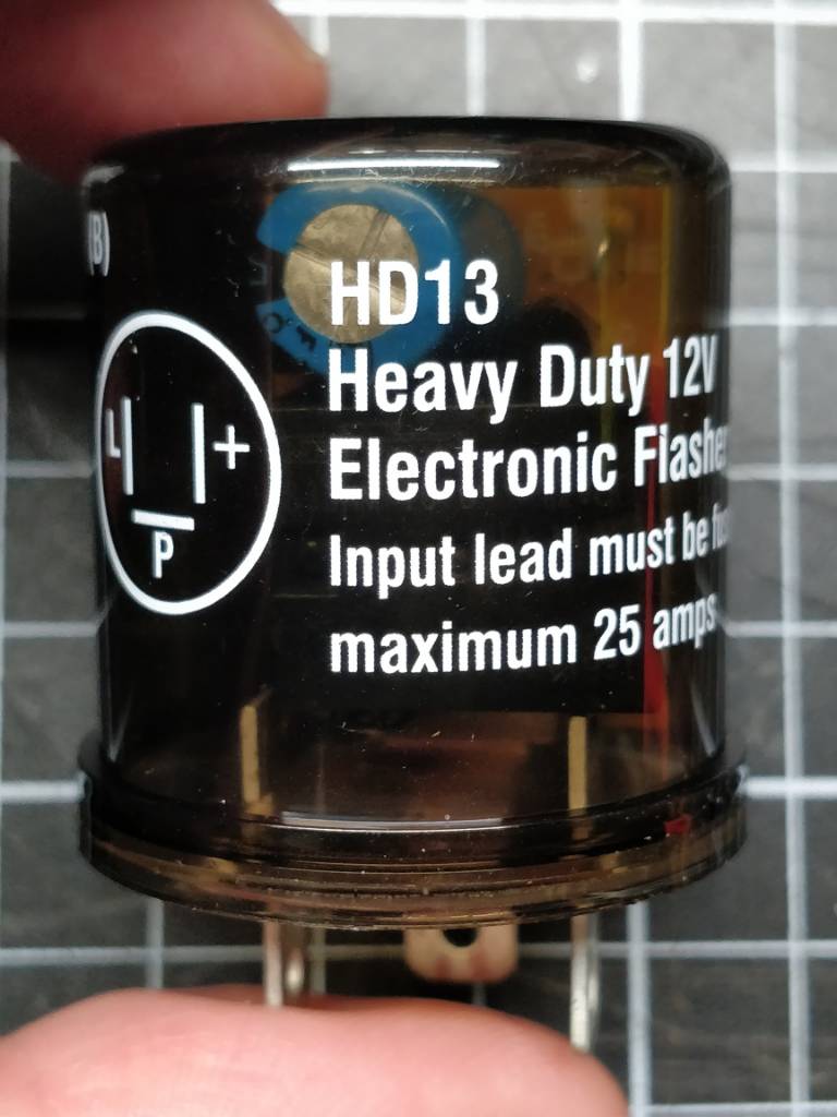

It worked, flashing at the correct speed, but I saw it glowing a little and it released a small amount of smoke.
Turning it off and disconnecting it, I saw that a small resistor looked like it had burnt.

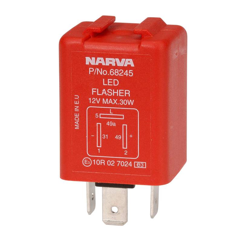

I saw that Narva also make one.

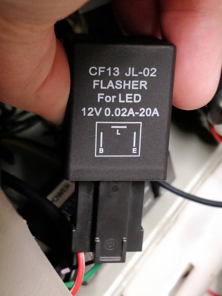

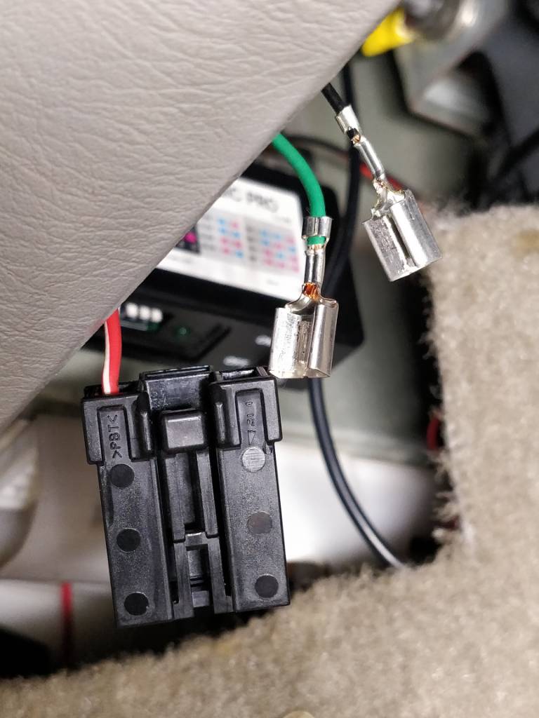

Just so others are aware, it's a direct plug into the factory socket, no need to change any of the pin configurations.
B L E, battery, load, earth, are the same as the factory relay.
The Tridon HD13 unit that I tried first was labelled + L P, which is actually battery, load, and P is a low voltage output. So that would explain why it glowed and smoked when I connected to earth to the P terminal. It just shorted the resistor on that terminal.
And of course, I couldn't work that out from the information on the pack.

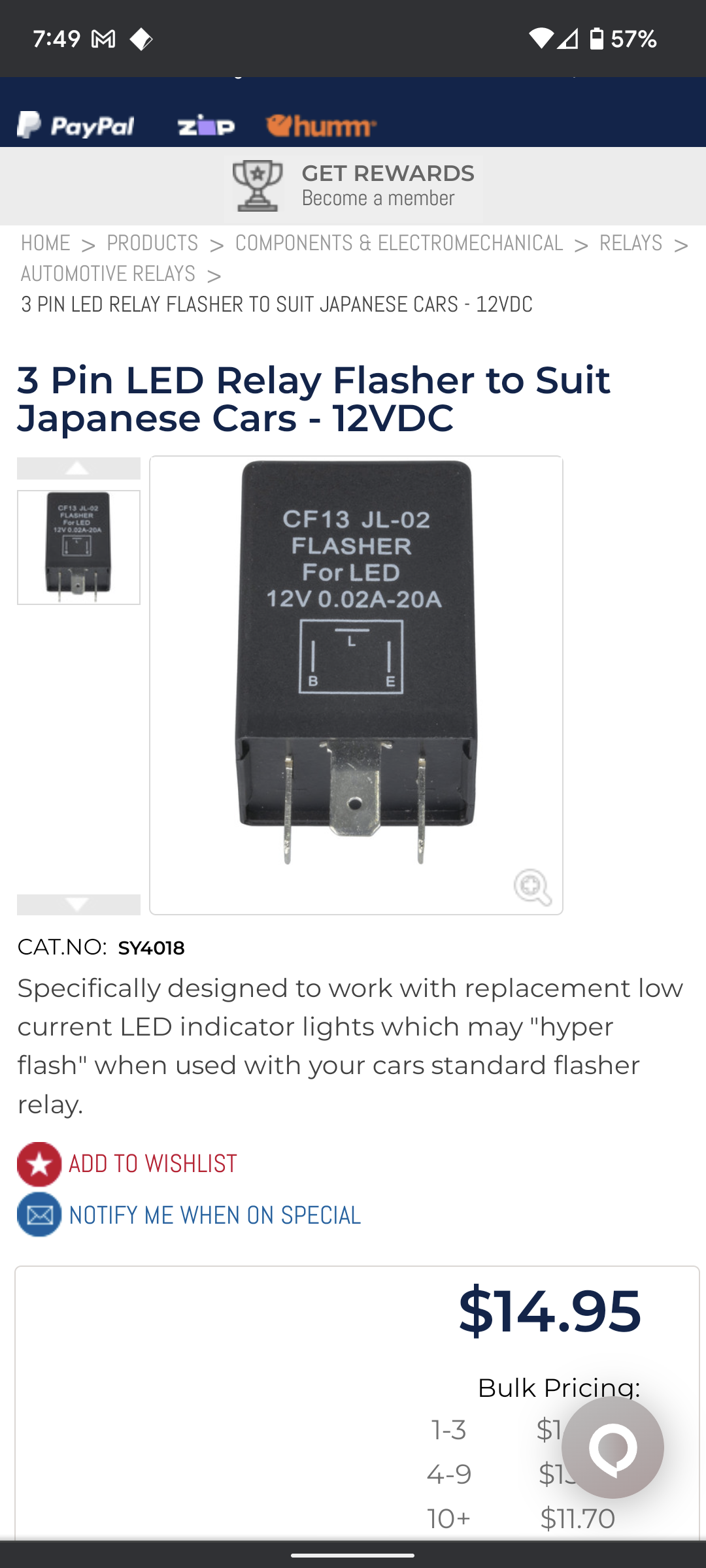

My very first led flasher was a eBay special . And it worked but it flashed slower than factory.
As I visit Jaycar regularly, thought I'd try theirs and it was perfect.
