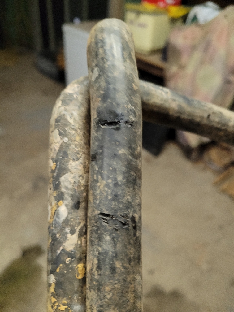

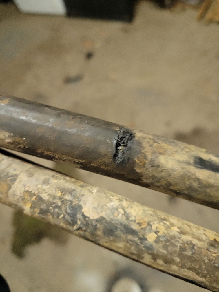

    Pulled the bull bar off this morning and only snapped half the bolts in the process.
    The UHF antenna even came off easier than expected thanks to rats having chewed it's cable in half behind the battery.
    Plan is to replace the DTS air box with a Radius air box when it arrives and install the FMI & oil catch can, along with trying to direct more air through the rad while I'm in there.
    Not sure the old rust bucket is worth it but at this stage it's all good fun.

    Yep bloody rats!
    They ate Rosscos heater lines, MB's brake fluid cap and they even ate my bread maker machine haha

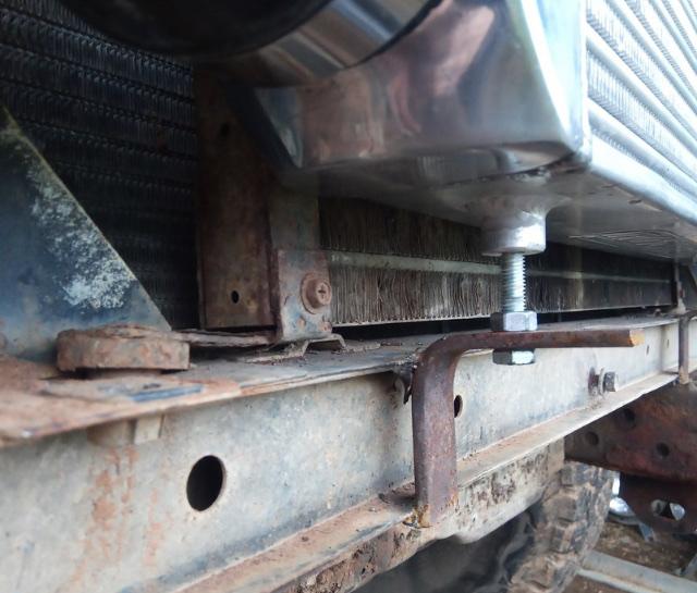

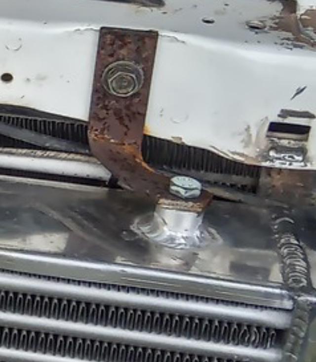

    Finished of the intercooler mounts.
    Picked up two 45 to finish the last stretch of pipping into the manifold but it was too close to the power steering so I used a 90 that was left from the original DTS intake but it looks to need a little trimmed off so that it is not pushing into the battery, tomorrows job.
    The 90s above the manifold do touch the liner but I am not sure how hard they pres against it, should probably look into that.

    Looking Great Dasa Mate
    Wondering/imagining/possibly your real corrugations home area roads your IC might appreciate some vibration shielding Brother
    Rubber washer (homemade) either side of your L bracket retained by a washer top and bottom and maybe a longer stud required to allow 2 x nuts underneath to lock off without over compression of the rubber anti-vibe homemade goodies

    Same same just noticed too on the top of your beautiful New IC Brother
    Never ceases to amaze nuffy me what corrugations in your top neck of Australia can do to lighter beautiful metals
