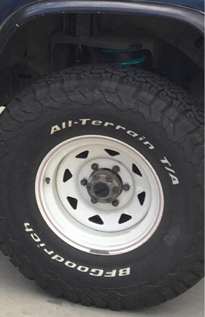

    Was hoping to depart for urgent NSW work early in the morning utilising the little TB45NA tug boat weapon for our Kanga trailer and gear. Picked up some new 2” shocks and 2” GU springs to handle my guesstimated weight needs with front steel work awaiting fitment ASAP. Whoops…..it’s standing proud at 4” lift now and its rear mini shorty tailshaft unladen is near 5 degrees at least uni joint uneven and vibrating badly
    A quick run in another vehicle to Patrolapart to pickup gearbox crossmember dropdown spacers (12mm) and will steal upper adjustable control arms off my GQ ute in the morning for hopefully a half day only delayed departure needed

    Cheers Rossco, any chance I can ask a quick run out to your shed measurement pretty please Brother
    I’m trying to ascertain what the front measurement from an OEM hard plastic guard base/underneath to our GQ hubs centre is from factory backtracking ? This thing is currently sitting at circa 610mm prior to steel bar and winch fitment tomorrow morning.
    Picture with 250kg rear ball weight and no front steel work yet
