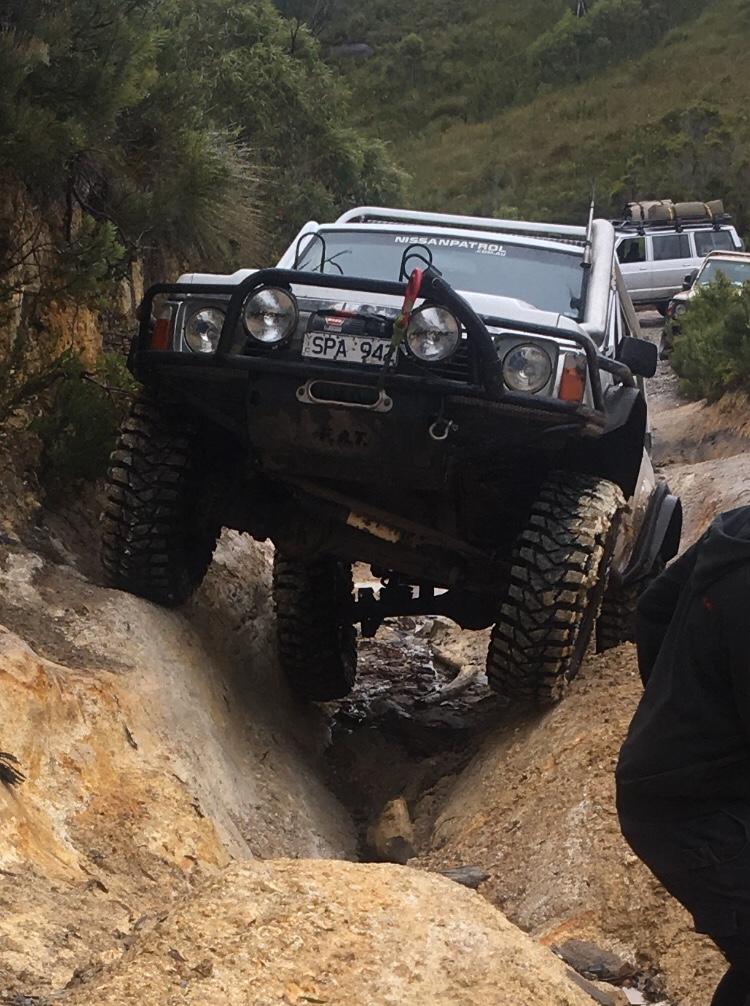

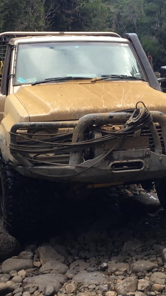

    Currently working on trying to find a way to create easily highway removable ‘winch horns’ atop of the new bullbar as you’ve kindly shown the Legendary pre-bog rope preparation length guesstimations with easier haul out fast skills
    Without horns, I became a tangled mess
    I do have two spare unused OEM Stealth spotlight plates welded behind the new top bar hoop and thinking that like the Polyurethane winch donkeys (aka dildos) two mini vertical Polyurethane donkey wrap ‘sticks’ (not big dicks) could flex forward on a super fast needed run out?
    Probably makes no sense, happy to draw a diagram if needed ?
    Yeah I have been thinking about your setup. I would make something up with winch horns welded to the top of a piece of flat plate with 2 mounting holes ans screw the flat plate across those 2 light mount tabs you have there. Easily added and removed and stored as a single piece. Note that mine are actually just U brackets bolted upside down mate.

    Could it possibly benefit both of us/all if winch horns were slightly flexible to assist slippery boot sprinting Navi’s I meant Brother?
    Yeah maybe, not really though. Mostly just make sure the horns are vertical. If they splay out to each side they just lock the whole lot on top. The rope is not ever really tight around them, just looped. Lift and throw for the win.
