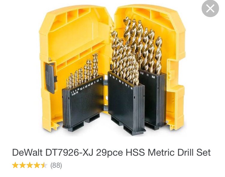

    For steel onsite @10G mate we use these Dewalt ones in our little game.
    Used to buy them for under $100 per kit ‘direct’ from the Dewalt service centre in Chirnside Park-Vic. They’ve since moved to the other side of town so need to find out where as we’re also due to restock up.
    Great things they are as the Torpedo Pilot drill tips save heaps of time out there although inexperienced hands still do snap the poor buggers.
    Dewalt IMO also make the best reciprocating saw blades for steel too, pack of 5 are under half Suttons or any other Yankys 2 pack prices and last 4 times as long proven to us
