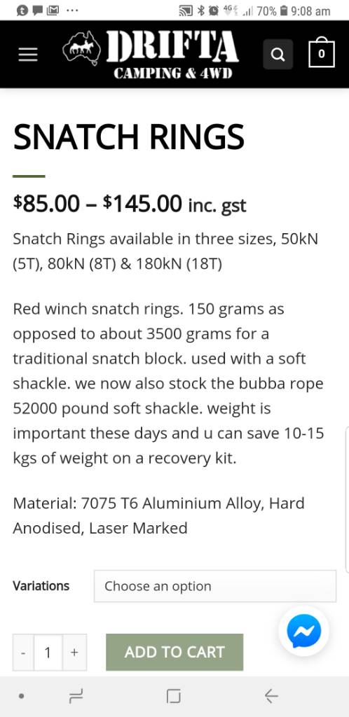

    Not cheap, available from Drifta check here

    Yeah a snatch block of decent quality will coat you $100 too though. Not too bad

    I'm not a fan at all. High load, rotationg alloy steel on thin synthetic strands.
    It will melt it.
    And grit will make it worse.
    The anodising will wear into it.
    Blocks using bearings are a far better idea as there is no sliding parts. It's all rotating..
    Hard Anodizing too
