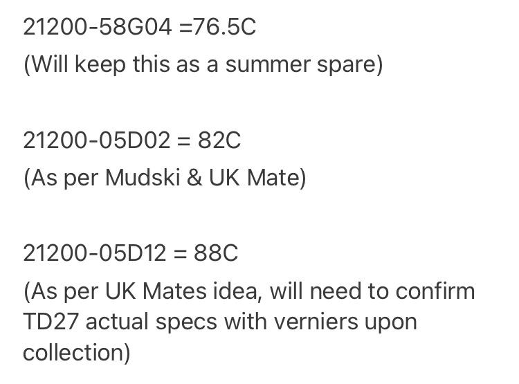

    Which Thermostat you running these days Old Mate?
  7. #14
    The master farter
    mudski's Avatar
    15,613
    8,673
    Thanked 11,298 Times in 6,438 Posts
    461 Post(s)
    Latest purchase was the Dayco DT79A. 82c opening temp, spaced out the bypass as per interwebs advice. Made F.A difference, went back to the Tridon Hi Lfow 78c stat, which was removed to fit the DT79A. Slightly better with the Tridon, ever so, than the Dayco...

    I’m surprised you haven’t trialled the OEM 82C as of yet mate, it was your helpful findings of the part number back in 2019
    I put the Dayco DT79a in. Same stat but with the longer bypass. Did FA.
