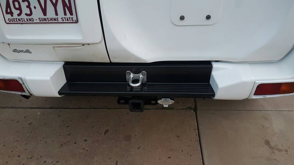

    Refit my tow bar from when I fitted up the long range tank, painted the rear step and rear plastic trims. installed now trailer plug. Ordered all the piping to build a 3" exhaust.
