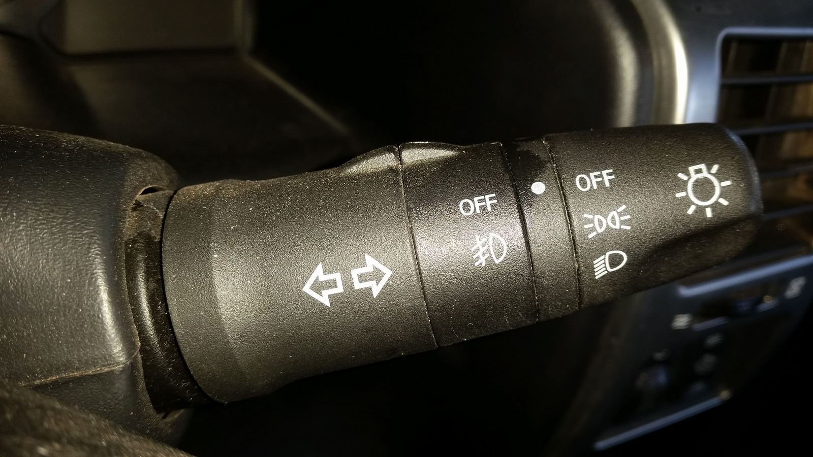

    Where is the factory fog light switch located? I've never seen one??
    Ha! Welcome to the late comers! That's actually the point of the thread mate! I have No Idea!

    On the stalk..

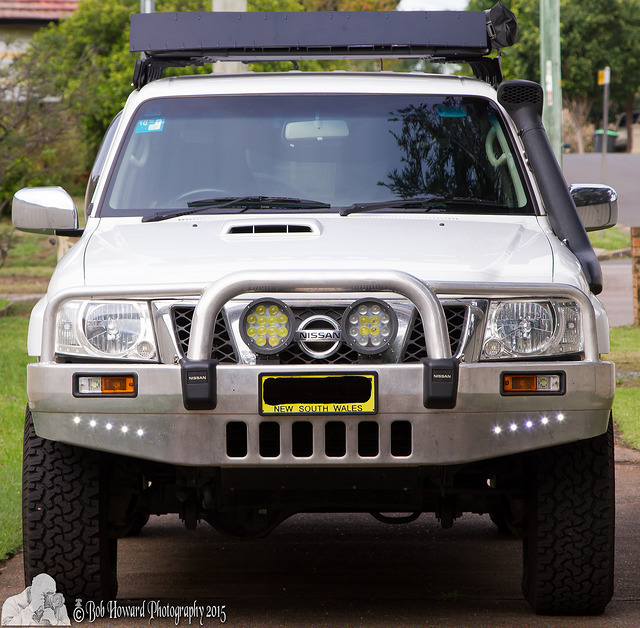

    In my 2010 GU, the fog light switch is integrated into the headlight switch but no sure when that was introduced....
    fog
    by Bob Howard, on Flickr

    Im not sure how they should be fitted from factory or ARB but DRLs can be wired in via ignition so they're on when the car is on or via a switch.
    I thought that DRLs had to turn off when the headlights were on, so ignition to one side of the relay coil, other side of relay coil via a diode to headlight +ve, or x2 diodes for low & high beam +ve.

    For my DRL's I used a 5 pole relay. So the DRL's work when the relay is not energised (and the ignition is turned on). The relay operates when the headlights turn on and consequently, the DRL's are turned off. The DRL's still work when the parking lights are on....
