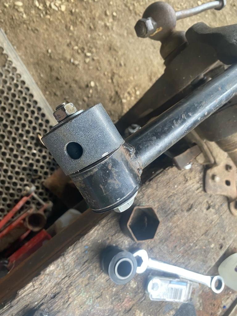

    Eureka!
    I finally solved the nasty wobbles.
    Just replaced the panhard rod bushes and it now drives like a bloody dream!
    They felt fine with no movement but closer inspection showed some wear and they were nolathane too.
    Anyways, Its such a pleasure to drive now!!!
  14. The Following 5 Users Say Thank You to AB For This Useful Post:
    Cremulator (29th December 2023), Maxhead (28th December 2023), MB (29th December 2023), PeeBee (28th December 2023), Touses (29th December 2023)
  15. #2168
    28,086
    13,595
    Thanked 20,773 Times in 8,582 Posts
    581 Post(s)
    I made up this little tool today which easily removed and installed the bushes too.

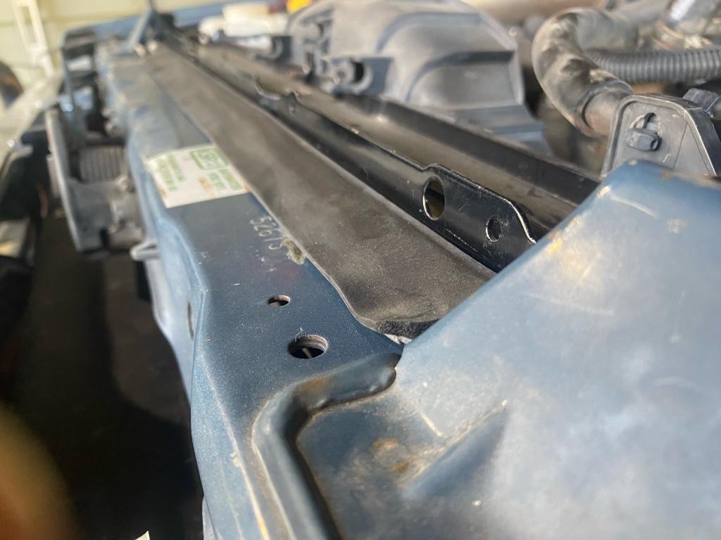

    AB's new GQ is finally here
    Found a good extrusion that works well with the top radiator today from Clarky.
