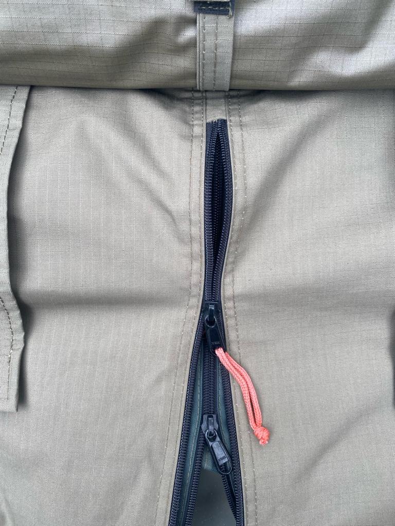

    The bloody zipper on the RV5 is not grabbing anymore.
    Does anyone know of any magical trick to get it to work again by chance?
    I’m assuming I need to pull the stitching off at the end to get it to grab again?

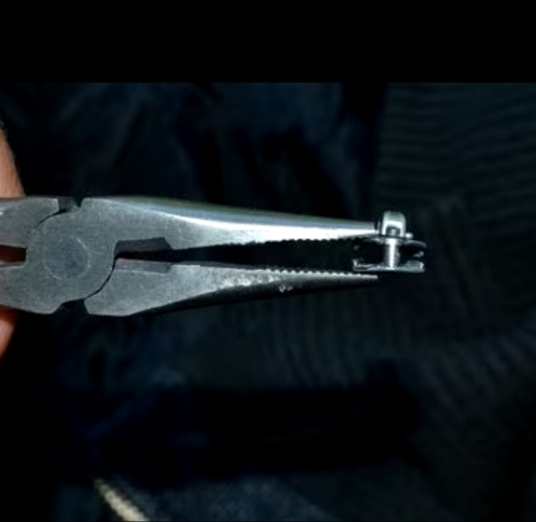

    I have had success in the past by crimping the zipper with some pliers without removing it from the zip.
    Just try to close the sides that slide along the teeth by putting the pliers on either side of the zipper while it is still in place.
    I do like that idea.
    I’ll try that, thanks mate!

    Didn’t work but closer inspection I reckon Lachy has damaged some teeth at the top unfortunately.

    There’s a few damaged teeth in various places unfortunately.
    There’s a company in Ferntree Gully who repairs these pretty cheap that @MB has used.
    I’ll find out there contact details
