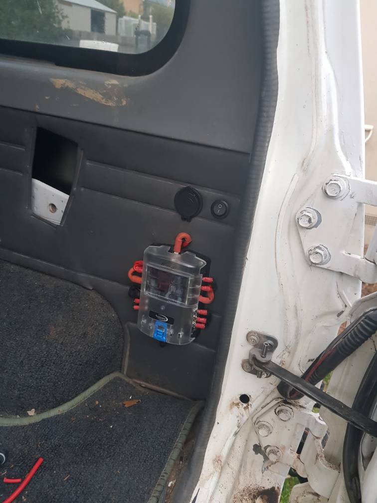

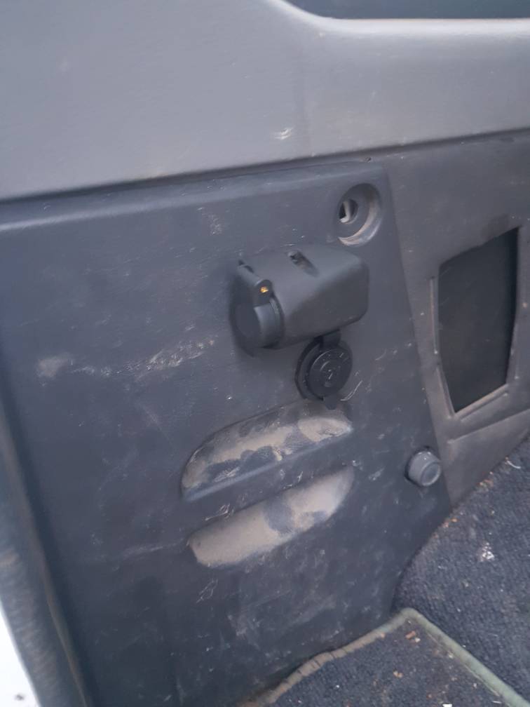

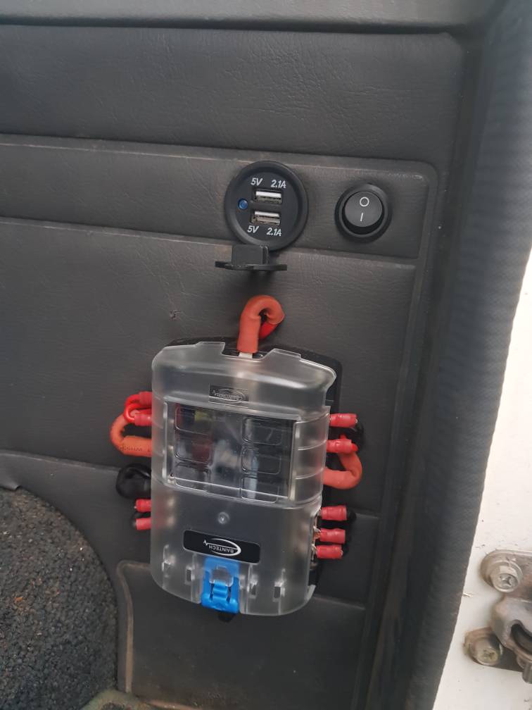

    cheack out my post in the link above. go down and see the pics a uploaded

    Quote Originally Posted by Fireblade View Post
    http://www.nissanpatrol.com.au/forum...use#post767969
    Attachment 76374Attachment 76375
    Remove all the old inline use holders and went with an ebay eBay box for $20
    Led lights come on to show if a fuse is blown. Much cleaner, I’m so happy.
    I also trimmed the factory fuse box lid as it was a pain to remove, it kept catching on the factory harness. Can’t even tell it’s cut but it’s so easy to remove and refit now.
    Any Narva type fuse block will be fine. Run a new fused supply to the block and then go for your life mate

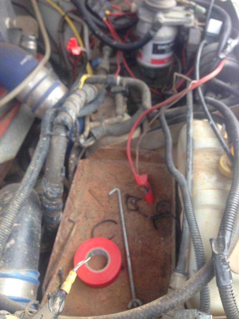

    Here is some work i did on the passenger side of my GQ to make way for a new bigger airbox with through bonnet snorkel.
    From This
    To This.

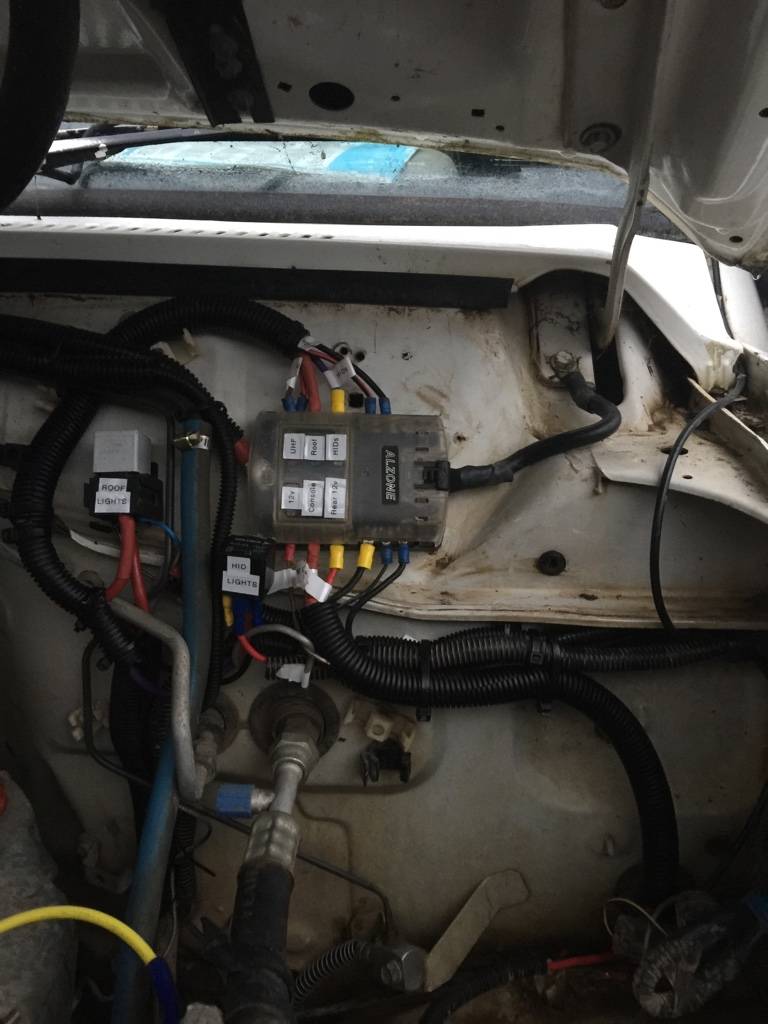

    In the back of the GQ i ran a new 25mmsq supply to another fuse block for all my rear stuff
    Fuse the supply and go for your life mate

    Hi ya mate, what label maker did you use, looks very neat!
