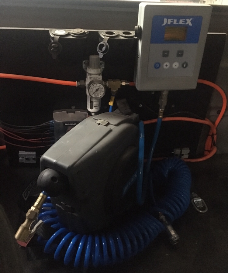

    My utes 20L tank is primarily used for instant 150psi short blasts for coil less rear on air bag suspension needs and the likes of tyre bead reseating and or paddock maintenance etc...
    Good quality hardwired or mechanical compressors are the real hero for normal tyre inflation although you can still save only a few extra measly minutes between each corner overall as the tank will recharge slightly found depending on how quick you move to the next tyre.
    Tanks absolutely must have a water separator as ET kindly suggests as I once came undone with blocking my locker solenoids in our mountains pre-installation of below.
    The Bunnings bought JFlex 9M reel works an absolute treat with its companion 240v automatic inflator plugged into my 12v inverter. (a loud ‘beep beep beep’ it says ready)
    Have kept the annoying spring coil hose that came with it for now as my seperate direct line/link to tank for blasting needs.
    (A work in progress:-)

    A wee bit boring/slow but here’s the pre-installation tests using a crappy little shed ‘Stanley’ 240v compressor that’s only half as good as the utes in cab (a/c comfort) mounted ARB 12v twin.
    https://youtu.be/i7CGMYmN9qQ
    Deflation is just way too easy these days, set and walk away forget!
    https://youtu.be/FqSqq69jtWk
    Inflation same same story never looking back with my crook knees hating squats:-)
