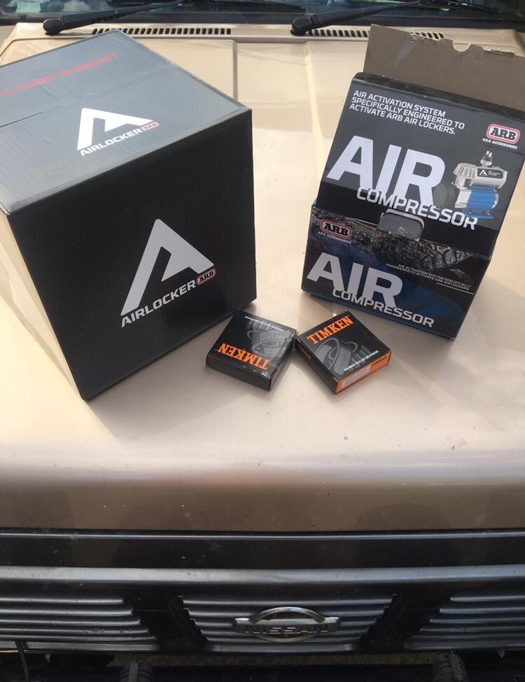

    Decided to give Grandpa Spec his first shot of Viagra tomorrow....look out Ladies

    You are an absolute mad bastard MB!

    Bloodey el Markie, no stopp'n ya

    You installing @MB - need my tap for the diff fitting? Watch out for the location, sure you won't get caught twice?. Sing out if you need it. Is this for front or rear?
