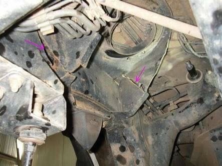

    So where do the towers give out? Is it up the top where the shock would push up and pull down?? Or someplace else??

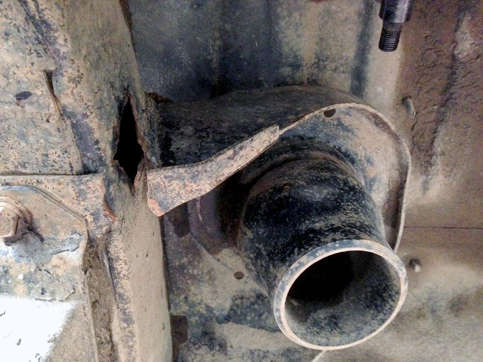

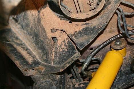

    They rip the welds from the side of the chassis. @MudRunnerTD posted some pics of a tower failure, along time ago.
    One bolt on solution http://www.nissanpatrol.com.au/forum...=tower+failure
    The only problem I have with fitting these is that I have a 2" lift and the extra width of the plate will raise the rear beyond legal height, with out an engineering certificate.

    Those are pics I found online.
    Vvvvv these are from my GQ

    So it's the coils and not the shocks. Gee that looks pretty crappy.

    That looks like the sort of thing you could get a bolt onable kit for to fit before that problem occured. It doesn't look like it would need alot of extra strength & support.
    Yes there is a couple of bolt in kits. Click on the link Mudnut posted above for info about n the Bolt in kit.
