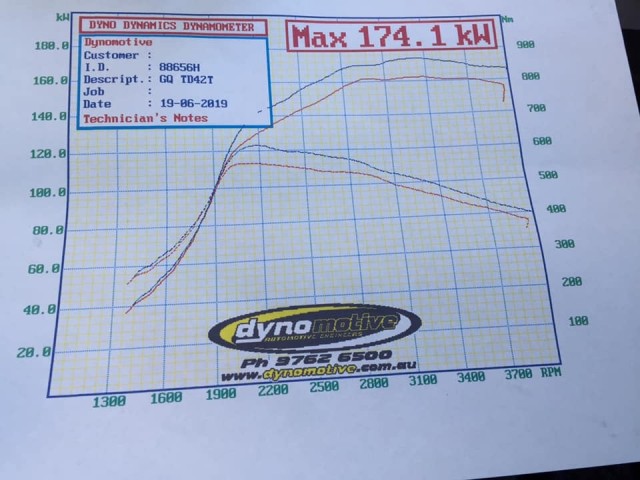

    The tuner kept it overnight last night, but finally good news!!
    Picked it up today, over the moon, I was aiming for 200hp and smashed my goal
    174.1kw/610nm at 25 psi on 35s
    Great results mate, gotta be happy with that!

    Thanks guys, I’ll look at upgrading the clutch after winter.
    It’s fine for now, but will need to do something about it. If it was an old clutch it wouldn’t like it, but was brand new 3,000kms ago. Only an eBay special but didn’t think I’d get through the power mods so quick lol

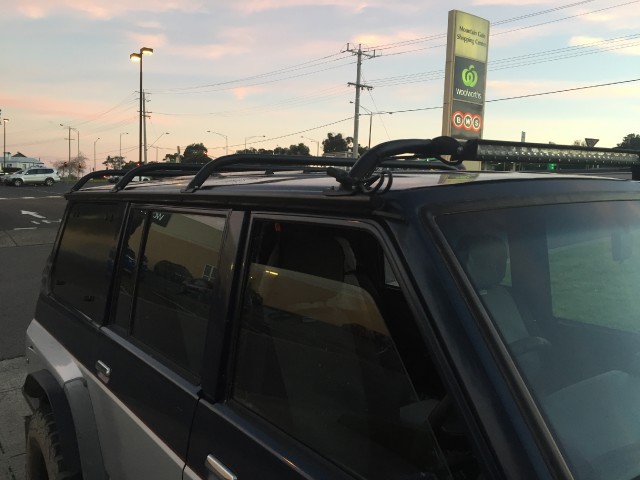

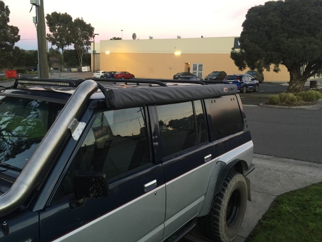

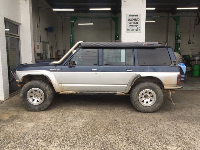

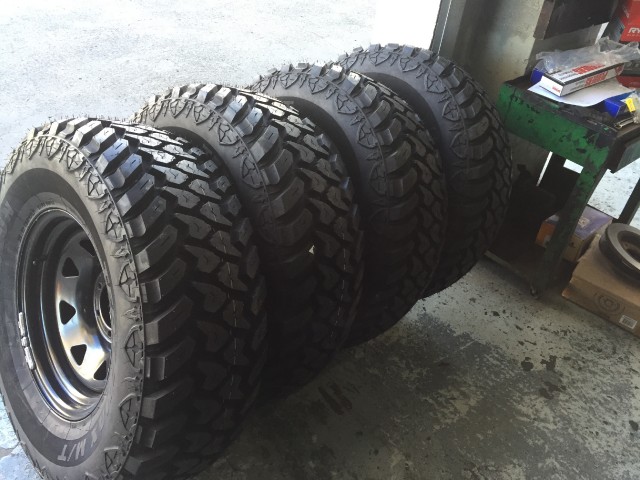

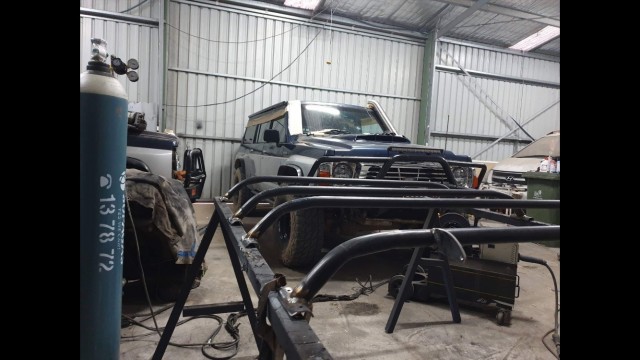

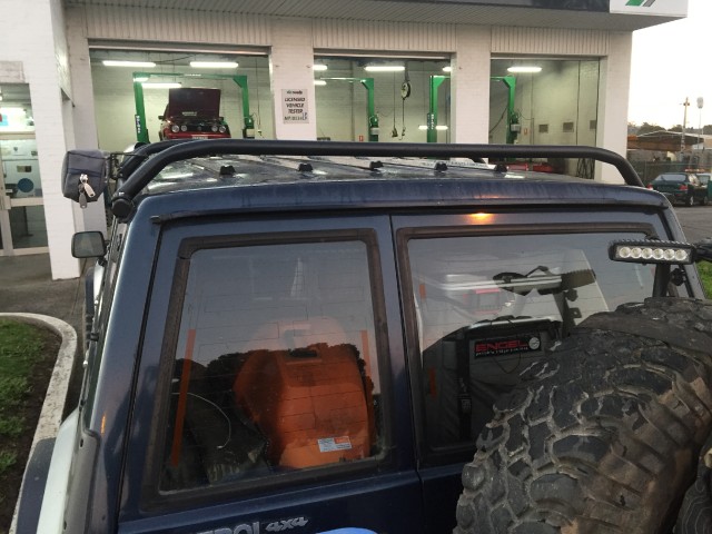

    Picked up my car yesterday from the fabricator, had a new roof rack/cage made, nice and low to the roof line!!

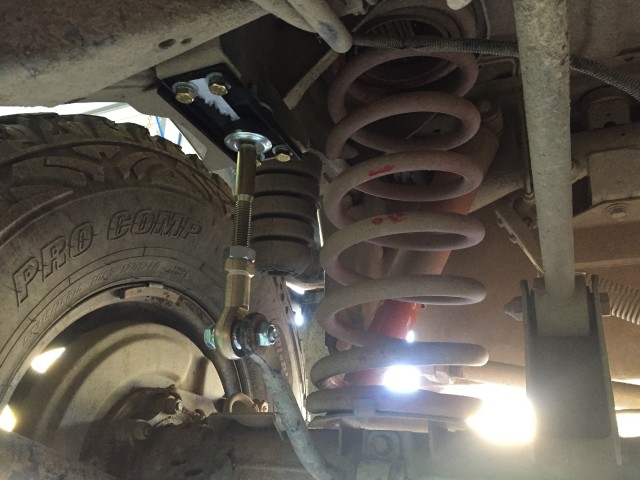

    Now with the extra oomph it has, I needed it to handle a bit better on the blacktop, Refitted the rear sway bar, bought a plate from Nissan to ditch the factory disconnect and just ran a standard type link.
    Then fitted new tyres, 35x12.5 17 Sailun Terramax Muddies, not expecting a lot for the price but will do for now
    Also found my small steering play that I’d been chasing for ages, loose panhard to chassis bolt, obviously I’d forgotten to tighten it after fitting the panhard a couple of 1,000 kms ago

    Nice mate, look'n good, I do like that rack nice and low profile. .
