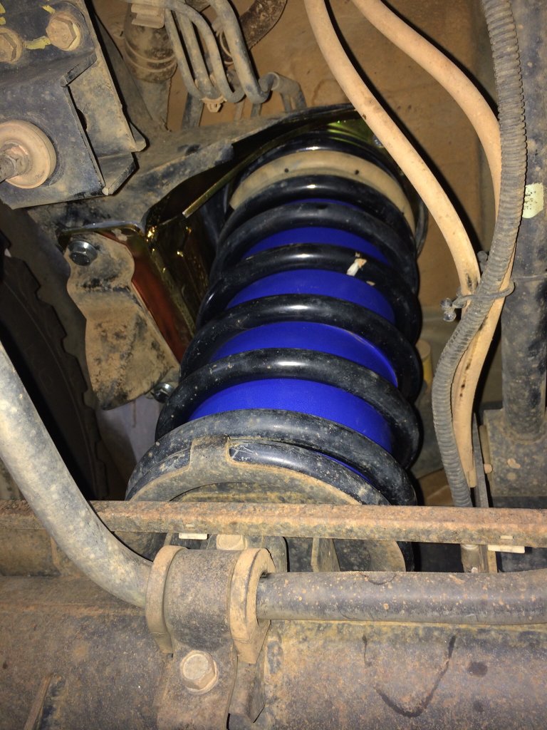

    I just installed my boss braces today while upgrading my springs on the gu.
    Patrol is only a couple months old so installed them as a preventative measure as I tow a camper.
    Word of warning to anybody looking to install the kit. I would recommend installing the bump stop bolts first before tightening the 4 upper bolts. I nearlly stripped a bump stop bolt by tightening the smaller upper 4 first. Had to lossen them back up to get the bumpstop bolt in correctly.
    Not sure if it was the same for every body else who has installed them but it was only has to be slightly out to strip the bolt.
    I also used locktight for safe measure

    Installed my Boss braces on my 2012 GU today too! Also installed a new set of Firestone Coilrite airbags as we tow an off-road camper.
    Job was pretty straightforward once the car was up on the axle stands and lowered the back axle - a little bit of caution to others, as had to remove some of the brake line mounts and diff breather etc. to drop enough to get springs all the way out (2" lift). Braces and bags went in no problem... thankfully nothing bent from earlier.
    Good piece of mind if nothing else!

    I bought the CR5042 from Airbagman off eBay $310. The bags don't have spacers like some other kits for 2" lift.
    I think they're about 13.5" long from memory. Hard to measure now.
