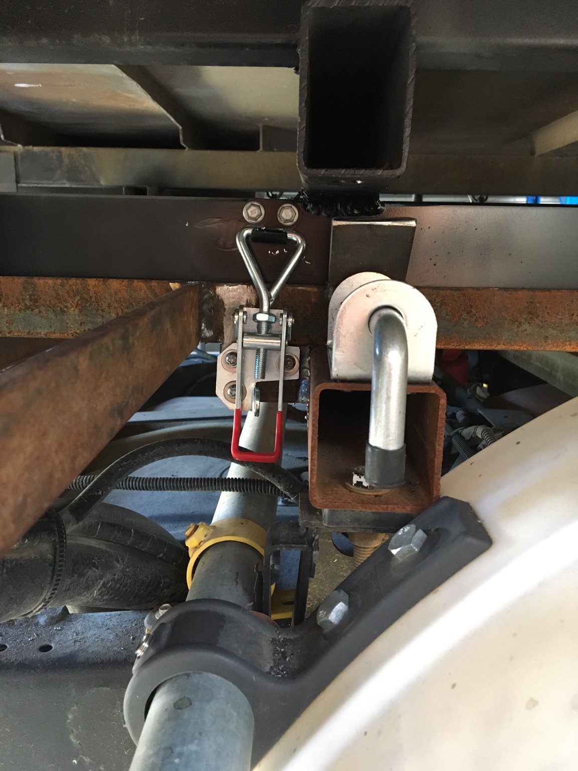

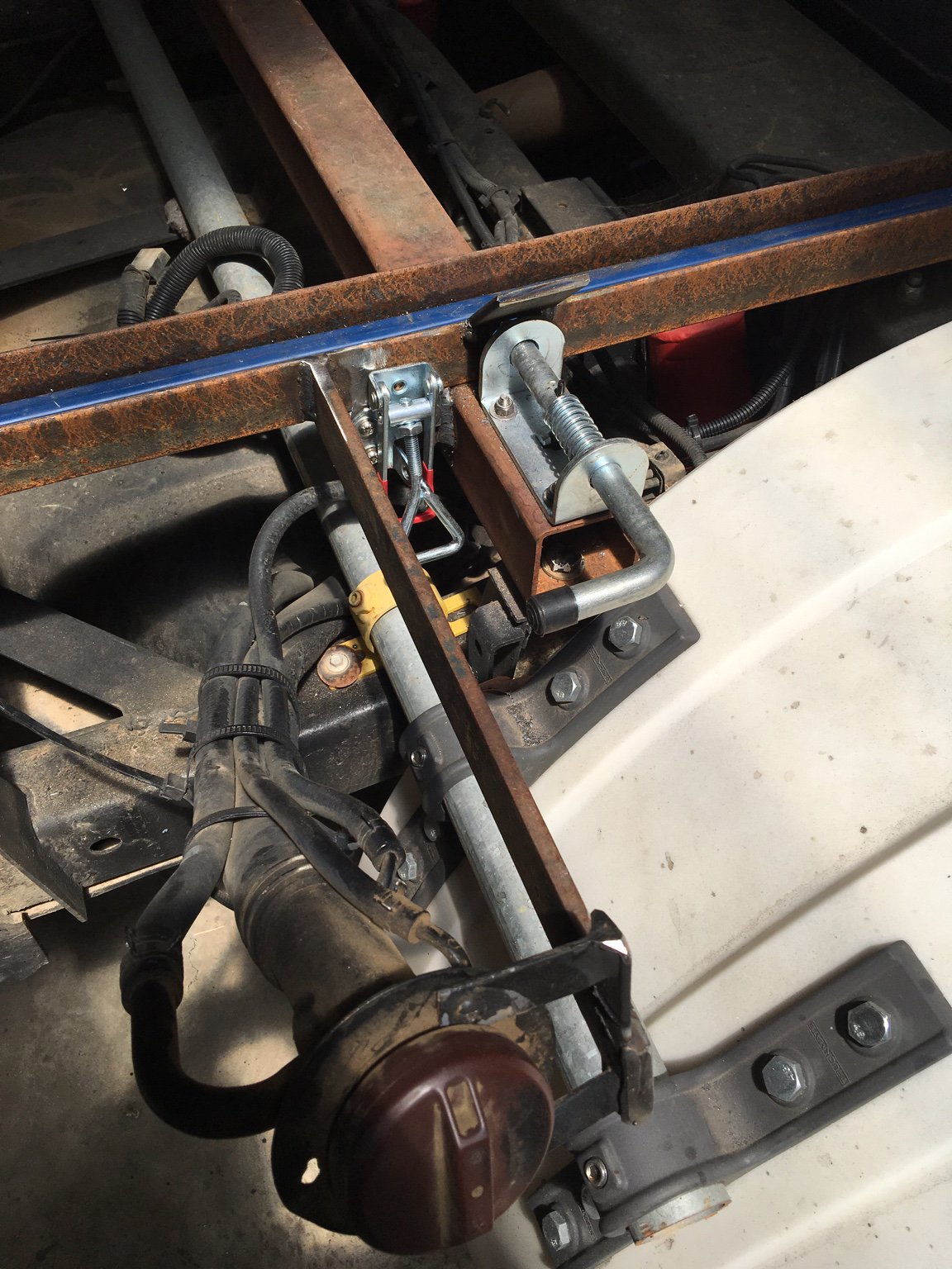

    They're the same ones I believe I got off your mate Scotty in Tullamarine thanks again TD :-) It's not for a slide on camper but the entire tray slide on wacky contraption 3/4 finished below:
    Added the 16mm lock pins into the design for peace of mind. Reckon the 'catches' would need to be much chunkier/rated if relying solely on them. Bolting down may well be the cheapest, easiest and probably toughest option for a slide on camper.
  16. The Following 2 Users Say Thank You to MB For This Useful Post:
