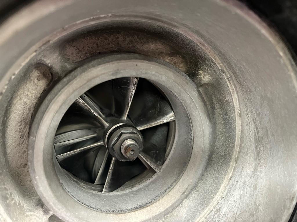

I've been hearing a tinny rattling sound from the turbo area under boost for the last 3000kms and just cottoned on that it might be the turbo.
Hypothetically, which direction should I go if a replacement is required? Is the OEM repairable? It's a CRD with 219,000kms & Garret GT2052V turbo.
I've heard aftermarket (UFI) can be good for handling higher boost, currently running 18.5psi. Went to their website and can only find an OEM replacement.
Is CCT a brand worth looking at?

Take off the air inlet to the turbo and see if there’s play with the shaft first just to confirm that’s it turbo.
There shouldn’t be any play at all.

What do you notice on this picture, specifically MB? Nothing seem to be scratching/interfering to my nuffy self.
