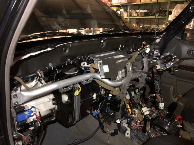

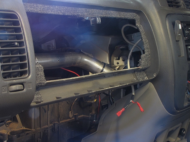

    If you remove the glove box, you can see up under the dash area, or alternatively under the steering column area. You could potentially put a GPS under the plastic of the dash to get clear signal through the windscreen.
    (Reference photos from Cuppas second glove box install and JFF45s heater box replacement)

    I agree, under the steering column would not be a good location. What I was referring to, which I should have been clearer about, was under the dash on either side of the car.
    If you can't get access looking up past the steering column, maybe removing the instrument cluster and mounting it behind there?
    Ideally, mounting it somewhere that takes some time to access when you install it will make it less likely or harder to find if someone steals the car
    The air bag is above the glove box and I really don't want to disturb that. And there is not much room that is reasonably accessible on the driver's side, and as others have mentioned it is the first place someone would look. Hence the search for somewhere else that is not a 'normal' location for these.
