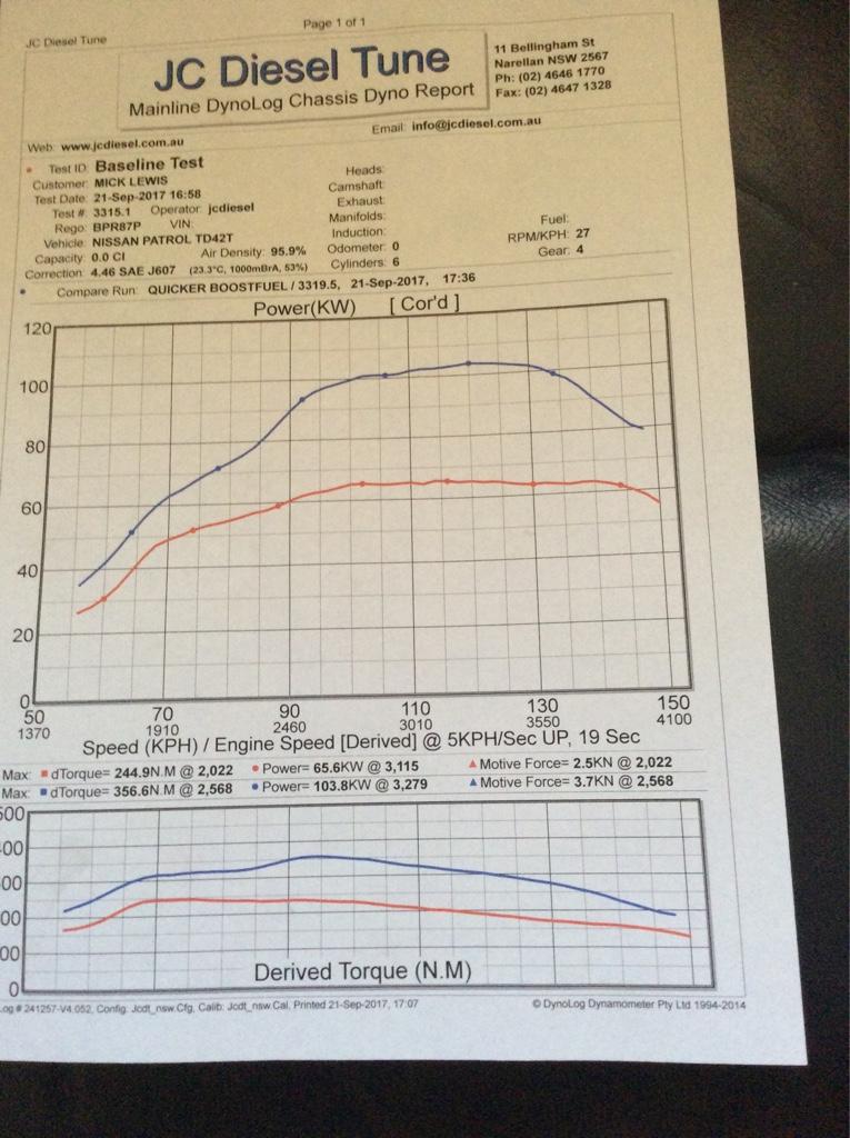

    I’ve got an ‘05 4.2td wagon had since new. Never had anything done other than a 2” lift.
    Around the 210000km mark I found it under power towing my heavy camper trailer.
    Took it to a reputable diesel bloke in Narellan and had a good talk.
    Fitted 3” dump pipe, 3” Redback exhaust, new injectors and dyno tune.
    Result = a powerful new truck.
    This was my experience, but you may be different.

    How much did that set you back in $?
    What sort of results did you get on the Dyno?
    It’s on long ago to remember the exact cost but I do know that it was reasonable for what was done. I’ll look for receipt, but don’t like my chances.
    This was the dyno print out and I have been very happy with the vehicle’s performance since having this little bit of work done
