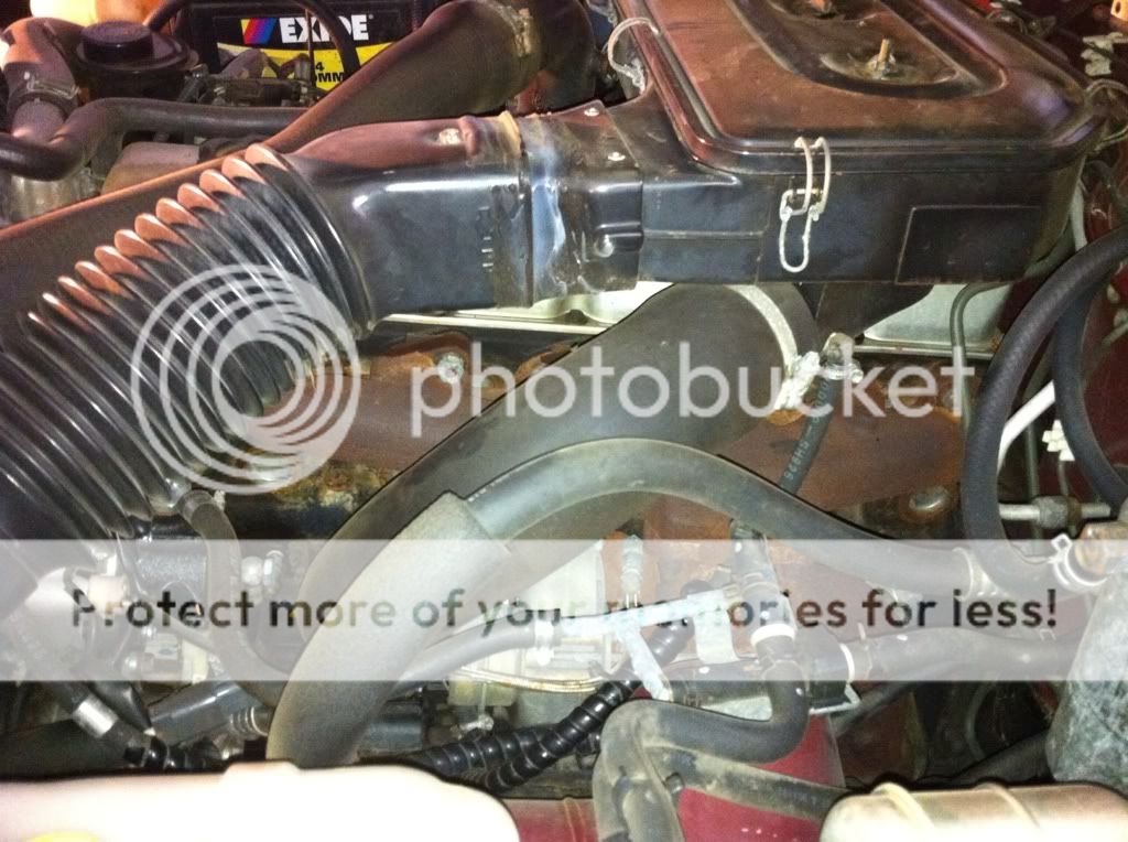

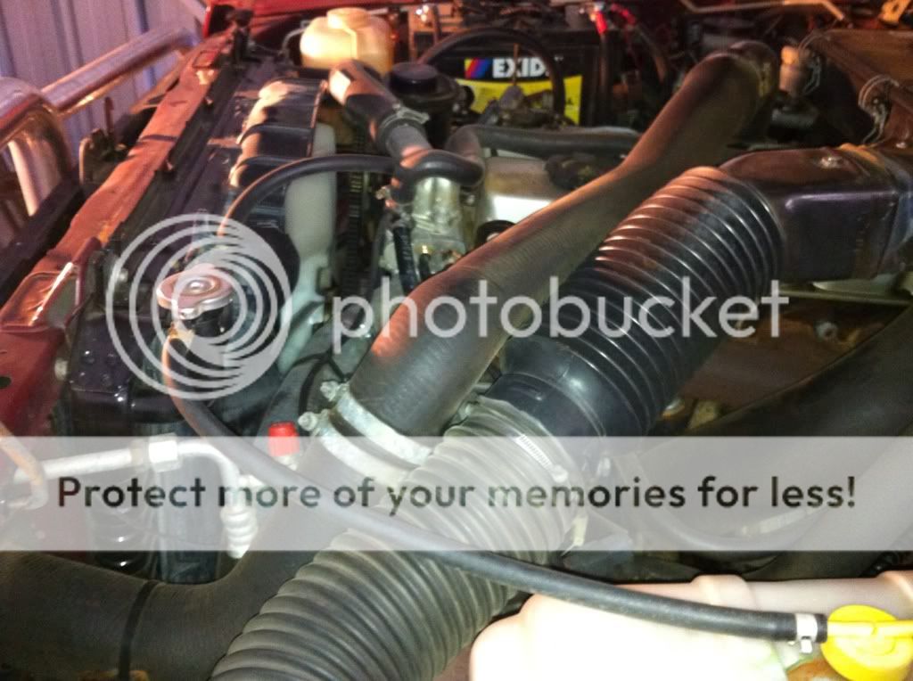

    Here are a few shots of my bay.,

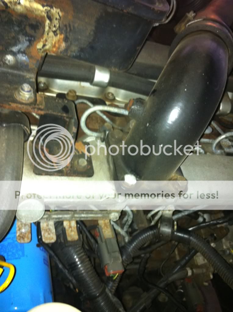

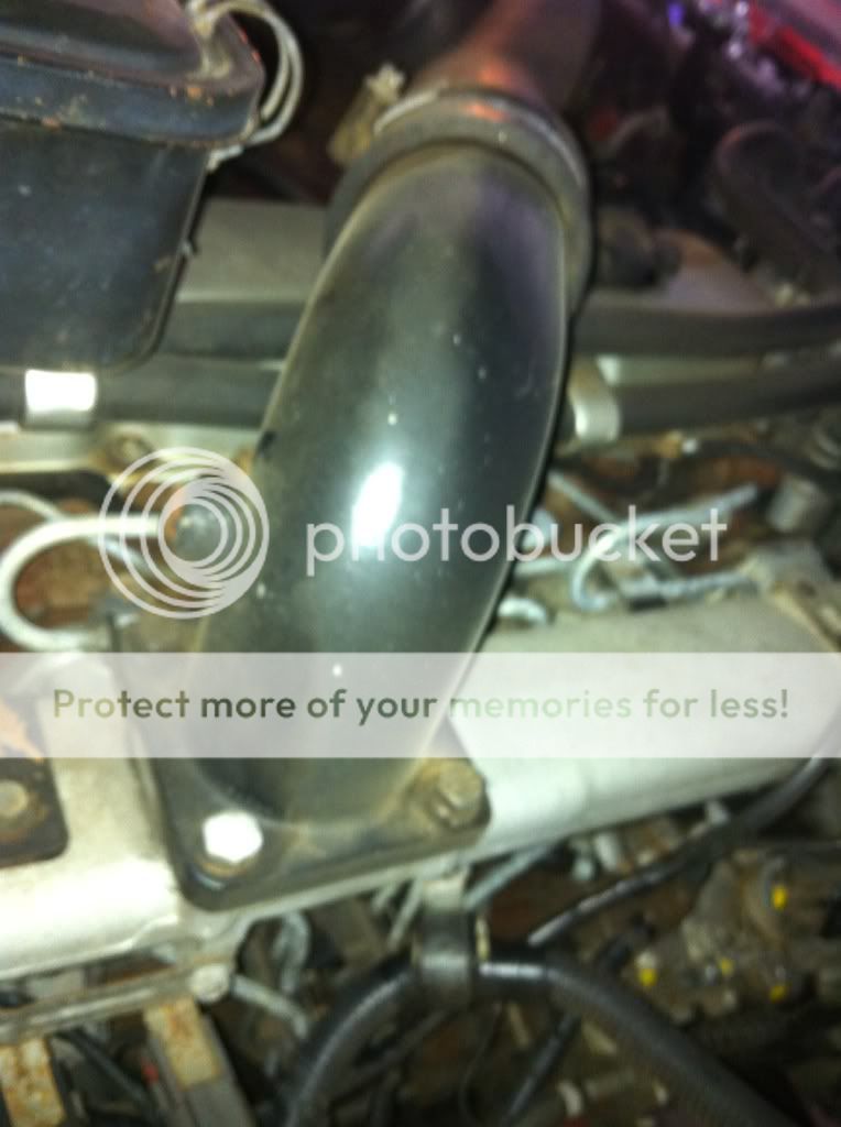

    This is a shot of the intercooler hose running into the blot, it seems to have a bolt in it and i was wondering if i could get a piece for this and hook up, not sure if it is the best place to pick up a legit reading from though?

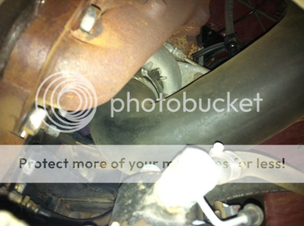

    Here are a few shots of the motor / turbo
    Any help would be great.

    Thinking about drilling and welding in a bit of small pipe to that black pipe in the first pick, thoughts?

    Quote Originally Posted by Dozer View Post
    Yep that will be the best spot mate. Ferret wrote in another thread the other day that you could drill a hole in it and install a tubeless tyre valve and strip the valve out and you have a thread. Simple and easy.

    cheers Mudrunner, i read that one. Just not too sure about doing something like that and thinking welding a solid bit of tube coming off would be the best option. Im sure this fitting is steel and not alloy so should be a simple job.
