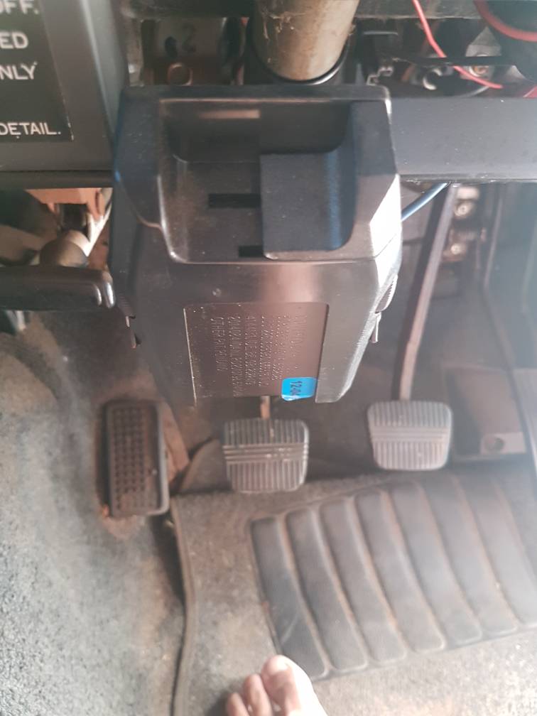

Can anybody tell me what the stabilizer is on a gq? Looks like a hand brake lever.
Also can anybody tell me what this is? Is it part of stabilizer?

Is that a trailer brake controller??

T handle is the factory rear stabiliser bar disconnect.
Allows you ti disconnect the rear stab when off road for more travel
Black box is an eleccy brake for trailers.
I reckon the proportioning rate is the knurled knob on teh side and the slider is teh manual override

Thanks Mate.
