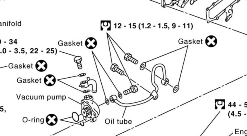

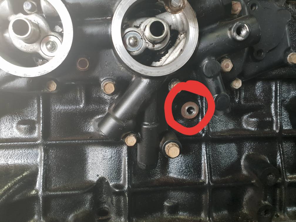

    Can someone confirm that this is the oil feed port for the vac pump? Does the vac pump have an oil drain? I can't see where it would go into the block.
    Edit: I can see the pump would just drain into the timing case.

    The vac pump does not need any feed or drain. The pump mounts to rear of timing case and uses oil in there to lube gear.
  11. #1060
    15,821
    7,275
    Hmm you sure? It definitely drains into the timing case but I reckon it needs an oil feed.
