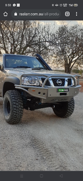

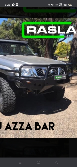

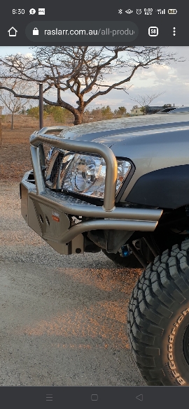

    What do you recommend.
    I'm getting raslarr sliders and scrub bars, but I'm not convinced on their bars. The black bar is the old style and the tan colour is their new style. They look the same to me.

    1st & 2nd photo don’t appear to be working on my icrapple?
    Tube bars IMHO (front & or rear) although extremely functional and cost less generally I believe they might attract extra unneeded attention from Mr Plod down here in the Mexican Alps outskirts
    Not sure what reasonably priced plate/folded functional bars are available for GU’s these days though?

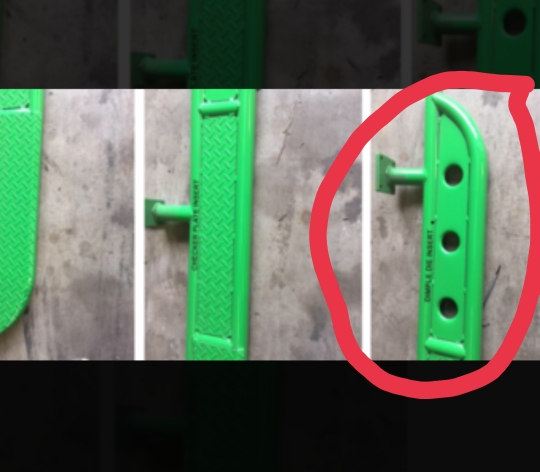

    Gday JC. Same as MB couldn't really see anything in your pics but I checked the website. I would be asking what wall thickness they're using on their sliders. Anything less than 4mm I'd be expecting budget pricing and not expecting stiffness. Do not go for open sliders. You will get sill damage from strong sticks or branches that get caught up in them and rotate around to gouge your sills out. Seen it happen. Scrub bars I suppose could be less structural depending on panel clearance and if you're not leaning against buffalo in the NT!
    Sliders are made out of 50mm od with 3.2 mm wall and I'm getting these top plates, but not green..

    FWIW: 40NB - 3.25mm wall thickness on sliders specifically is my believed happy medium weight minimum as long as the trailing end (B Pillar) backwards has adequate design support.
    The vast majority of impact witness marks I find on proper rock working forward trucks is the second half of their outer slider rails
