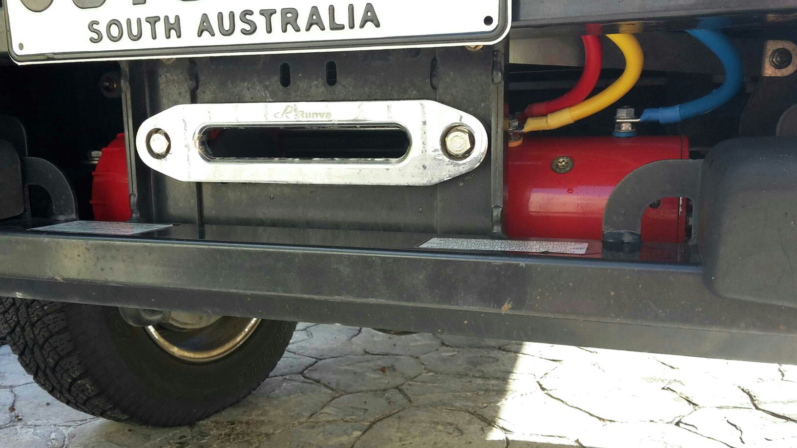

    Hey Kallen. I had to face mine up as it was fouling everywhere facing towards the front, except at the very back which was pointless as you cannot reach it by hand. I was just gonna heat up and bend the handle or cut it down a bit... and leave it at 12 oclock. Howevrer, I now have the different Runva winch I got today with a different clutch handle and can be rotated all around, unlike the original one which cannot be rotated past a certain point on the front.
    Here is how my 11Xp is fitted you can tell the selector switch fouls on top of that bull bar. ANd second photo is of my new winch.
    Ok first up how the fark did you get your grill out. The top 4 cluos are easy but those down next to the lights have stumped me...
    Next, So how have you installed your the right way up and still get the rope out up high?
    Have you reversed your spool direction??

    My trick with the bottom 2 tabs on the grille is to pull it like a 15 year old ...
    As for the spool direction mine spools at the bottom. So I had to change nothing except the clutch lever rotation.

    Mine also normally spools from under but the fair lead has to be mounted at the top in the nissan bar.. so you gotta flip the winch so it spools from the top.

    I've bolted mine just next to the motor.
    Still have to shorten the cables down bit, they'll be about 150mm. Eliminate more voltage drop.
