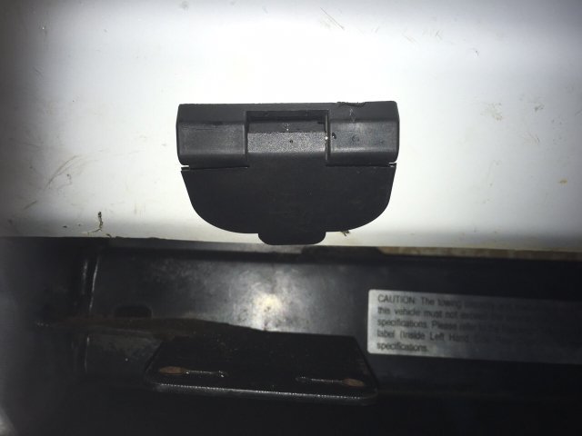

    After repeatedly bending up my trailer socket on the old bracket I decided to buy a new one and put it in the bumper.

    Quote Originally Posted by Skitzyrex View Post
    Mine has been smashed after the trip and i hate the flat plug.
    So will be doing the same and mounting a round plug socket on the bumper..
