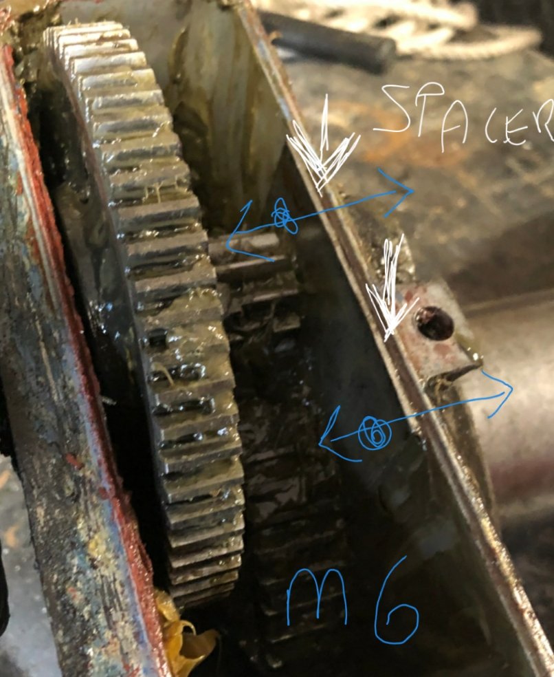

    Extra little mod for you Mark. Sorry just spent 30 minutes looking for a pic but can't find one.
    Drill 2 x 6mm holes through the case below the lip and through the retaining plate when in position. And the 2 x M6 bolts through. You need a 1mm spaces (maybe 2mm. A couple of washers) to space out the retainer so it slots into the top housing groove.
    I have had this retainer Fail. Whole winch us out of action when it does. Easy mod makes a difference.

    Yeah definatly, I did that on mine, quick easy & cheap. .
    Bloody legend you are. Thanks.
