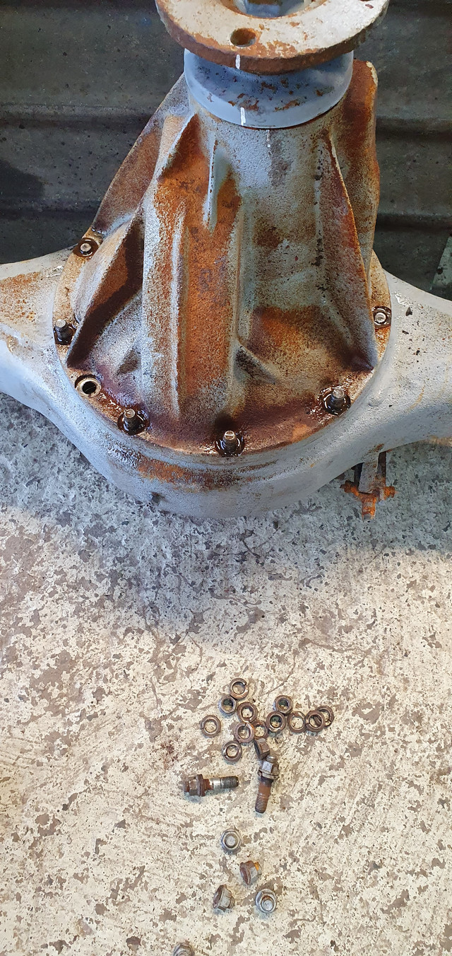

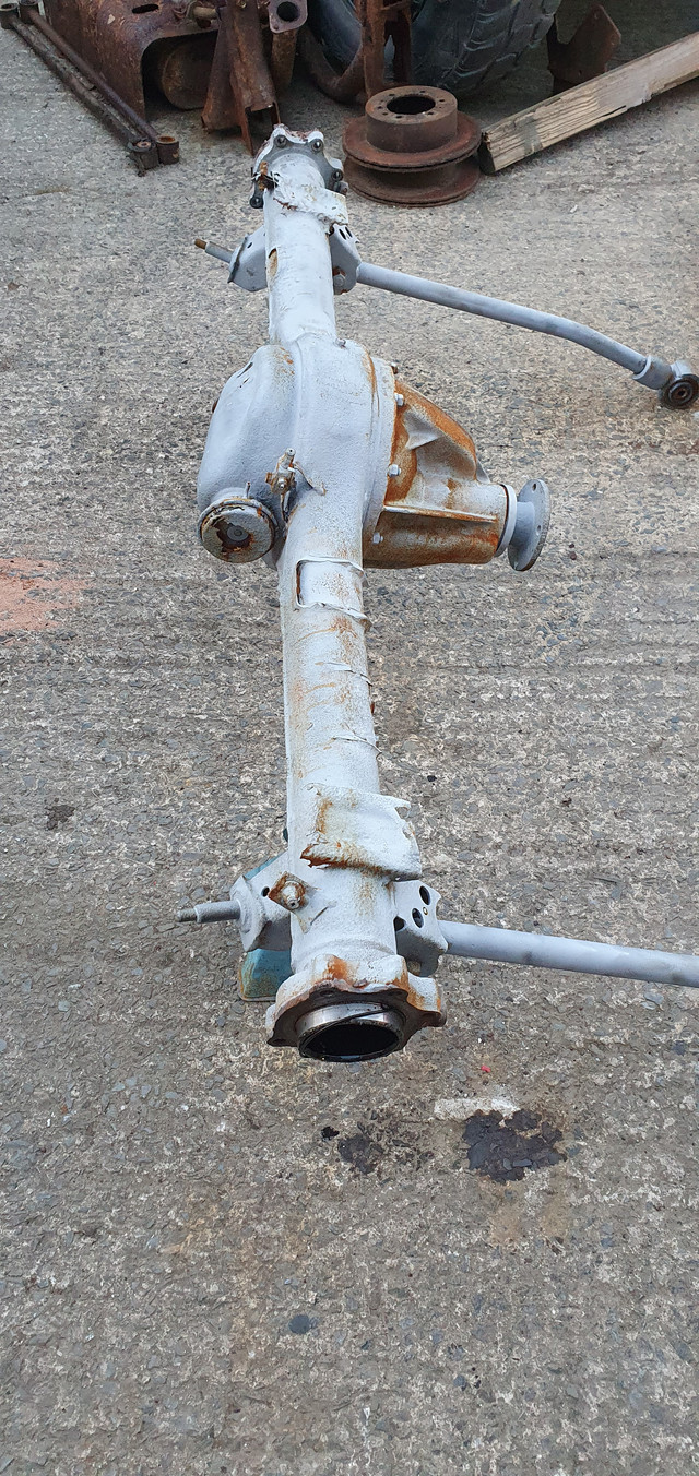

    Axle woes.
    I've had a busy week with life n work but did manage a few hours of axle prep.
    First off I did a ratio check. I bought these Y61 axles years ago and was told they were off a 2.8 So 2 turns at the hub and 4.6 ish at the pinion. I hoped they would be as advertised 4.65 :1 ratio ?? Well it turns out they are , yay.
    After another lot of WD40 and much grunting, I eventually got the half shafts out
    Problems arrived big style on the diff case though ! Very first nut I went for sheared the bloody stud Got a few more off but lost four in total.
    Then I just couldn't bash the diff off the axle. Just how hard can I hit it do you know ?
    Any top tips to get the diff off ? I've got access to some serious heat, and big hammers !!
    For now I've left the studs soaking in WD40
    Onwards

    Looks like someone used some serious sealant when they put it together. Heat may help to break the bond.

    As Bill kindly mentions, mild heat should break the seal/bond surely.
    Extra assistance could be achieved via two pieces of steel, say angle iron, either side of your pinion with ‘all thread rods’ back to your housing. Much like a gear pulling homemade mechanism with Bill’s heat applied around the seam whilst tensioning.
    FWIW: ‘Penetrene’ shits all over WD40 for loosening rusty gold, albeit I too don’t believe this is your current issue now that all the bolts/nuts are gone mate.
