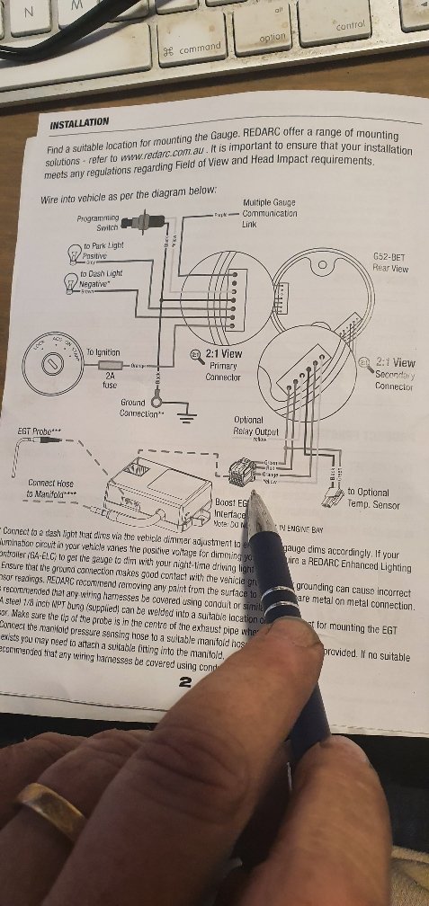

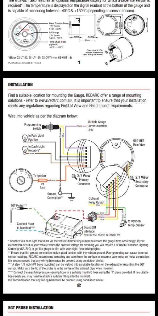

Hey mate, you know how your a bloody rippa Bloke. Did you by chance fit the Black control box for your gauge is an easily accessible location? Yesterday during the install i accidentally closed the bloody drivers door while the loom was hanging out and destroyed the black plug that goes into the black box. damn it. Looking like it is not available and i need to make something work. I was at Gauge Works Geelong today hoping i could just buy a black plug and re-pin it but no joy. He said it may well be a common plug for the back of a stereo and suggesting i go to a wrecker and see if i can find something to suire and then re-pin it.
I really need a couple of photos of it to be honest. and also very important, i need a good photo of the pin layout so i can re-pin it. I think it is a 4 wire but 8 pin connection.
In fact anyone with a Redarc 3 way gauge like this i would appreciate any help you have. Will make a call to Redarc tomorrow but not sure they will help. Surely im not the first person to do this. To my astonishment the plug is made from a very brittle hard plastic rather than a Urethane Resin and has just disintegrated.
Its a Nissan! =====> Its a Keeper!! ....... Got a TD42 in it BONUS!!....... I'm a lucky bugger! I've got 2 of em!
Is this what you need?
You can download the manual from their site: https://www.redarc.com.au/egt-boost-...rature-display
Just underneath the price is the PDF.![]()
