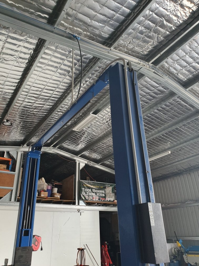

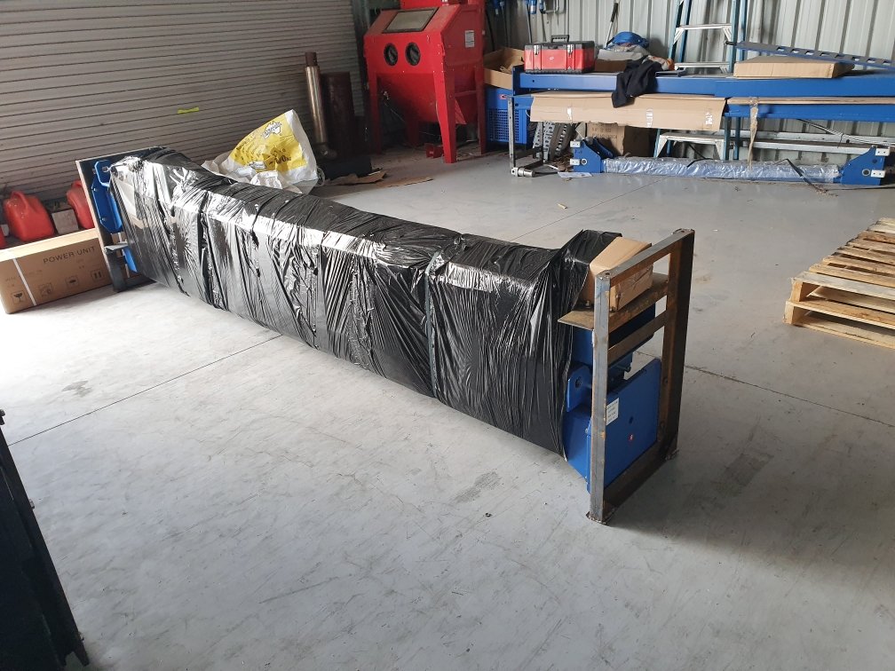

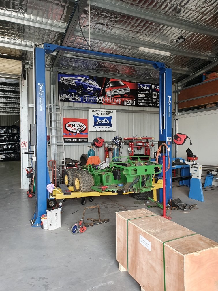

    I am going to fit a 4.5t Clear Floor Hoist from Joel's Garage Gear based in Little River who make a great bit of kit.
    This is Life Changing gents. Merry Christmas to me. Hoists in stock. I will install over my Christmas break.
    Did you increase the slab thickness under the hoist? It is one piece of equipment Mrs mudsane has given me the go ahead for.
  2. #13982
    15,478
    12,370
    333 Post(s)
    Quote Originally Posted by tryan277 View Post

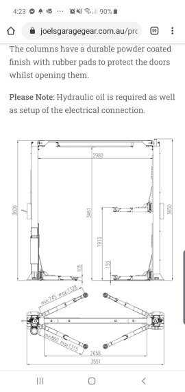

    Are you getting the 600mm post extensions to allow for the height of a patrol with a roof rack etc. These allow the vehicle to be lifted high enough to walk under more easily. My son and I installed a 4 ton lift (not from Joel) with the extensions a couple of years ago at the back of our factory. Makes maintenance on the patrol so much easier
    Trevor
    No I am maxed out with this hoist and have built the shed around it. I have 100mm to play with. I went and saw the hoist today and Joel said at 5'10" I will stand up under the GQ no probs.
    Good for you Darren. I have had my eye on the 5t unit for installation at my brothers place. He had plans for the big man cave etc then the marriage went south. I said 'if he builds the shed I will buy the hoist'. Just heard the shed is going up 'in the near future, but its a chinese jobbie and nothing like the original so the hoist is off the table for now unfortunately. They are a very nice bit of gear.
    Yeah these are bloody nice kit mate. Joel is moving 2 a day! He has about 30 in stock and has 5 going out on Monday. The 5T would be nice but the 4.5T is plenty for me. No hesitation to recommend his kit mate. I'm.impressed with how it looked. I will post some pics I took today.
    Yes I added 1m x 1m pad at 200mm thick for the base of each staunchon. Should be heaps.

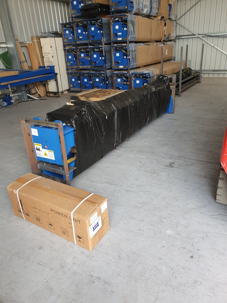

    I went out to Joel's today and had a good look at these hoists. I have to say they are bloody good kit. It weighs 750kg and each staunchon is 300kgs. Good kit.

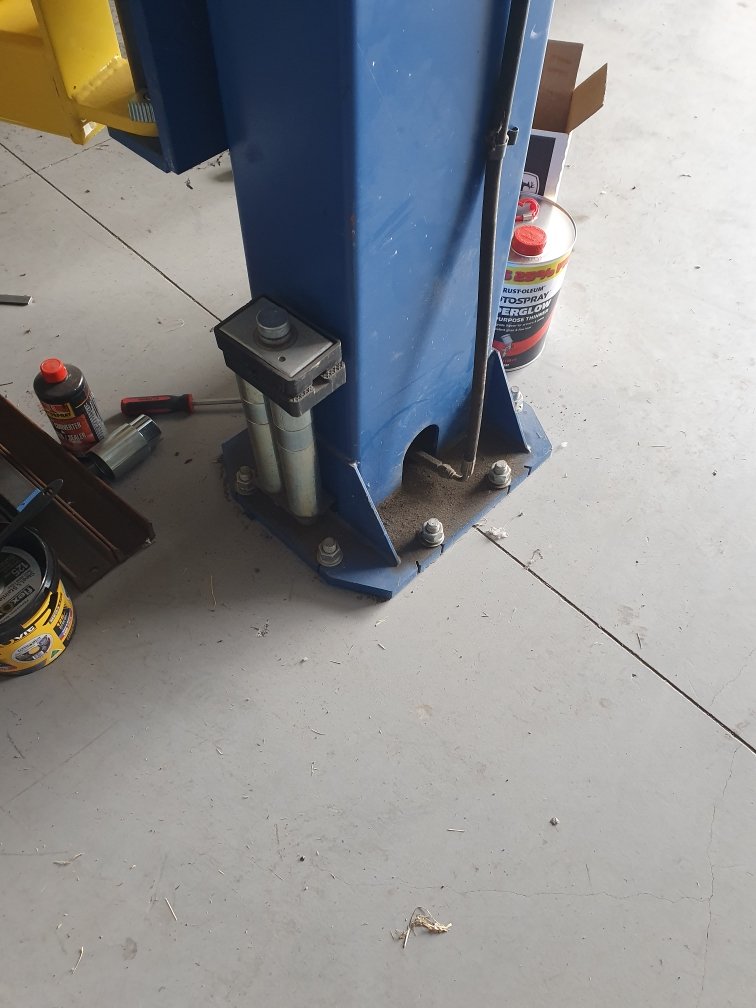

    Been told today though I have to wait 4 weeks to bolt the hoist to new concrete so 2nd January is Bolt Down Day.

    Darren, not exactly true. What concrete strength has been specified by the engineer? For example, the concrete reaches around 70% strength in 7 days then 28 daysfor 100% to allow for the moisture to dissipate. If you are keen for a quicker stand up, simply increase the strength of the concrete and ask the engineer to validate the strength cure curve. What we typically do when up against a schedule, say we need 20mpa concrete we specify 32 or 40 and it reaches the 20mpa level in the first week, so good to go. I also would recommend you use a chemset anchor system as opposed to loxins/dyna bolt or other mechanical anchor, unless yo are precasting the anchor bolts into the slab - which isnt a big deal, just needs a tempate in advance to ensure the distances are correct. The chemset system is miles in front strength wise and will never come loose. Only thing to check with the chemset system is around any residual moisture still in the slab during the process of curing to the ultimate strength.

    We’ve got some Hilti sausages left over from a recent tower project if you need Daz, should still be in date by then
