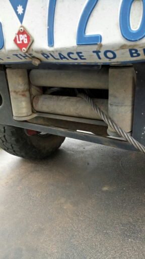

    I think I'll go and see Brett as I don't know how I'll get an aluminium Fairlead in place of the current rollers and still look half decent. Makes it a bit hard when the bar is made for rollers. I sure that it can be done maybe a little more researching.

    Called in to 4x4 obsession today. The only recommendations they could give was to change to nylon rollers or use a mean mother aluminium fairlead with would fit into a arb bar.
    I think I'll go the nylon rollers. If anything I reckon the fairlead would produce more heat and friction than rollers. Rollers would move with the rope.

    OK, fair enough, your call, just a couple of things to consider though. 1) nylon is a thermo plastic and sensitive to heat, be it friction from the load induced by the rope or from the environment. 2) nylon is hydroscopic, it absorbs water and expands. Over a period of time the UV will attack it and it will become brittle and crack, 3) as it swells, it closes up the clearance between the roller and the shaft, 4) as a system nylon rollers are no different in function to the metal rollers. I don't think there is going to be any change in the surface temperature of a poly rope riding over a polished aluminium surface, however two 'plastic' surfaces' are more likely to generate heat. There is a type of nylon or filled nylons that are less sensitive/more heat tolerant, maybe the term nylon is used as a generic term, but if I had to select a 'nylon' it would be a Nylon 66 or a glass filled type - both of which are expensive and certainly well outside of the use in the 4wd accessory world.
    I would stick with the alum hawse and the extension block in all honesty

    OK @PeeBee you have convinced me. I'll call the mob that has the extension block and get some measurements.
