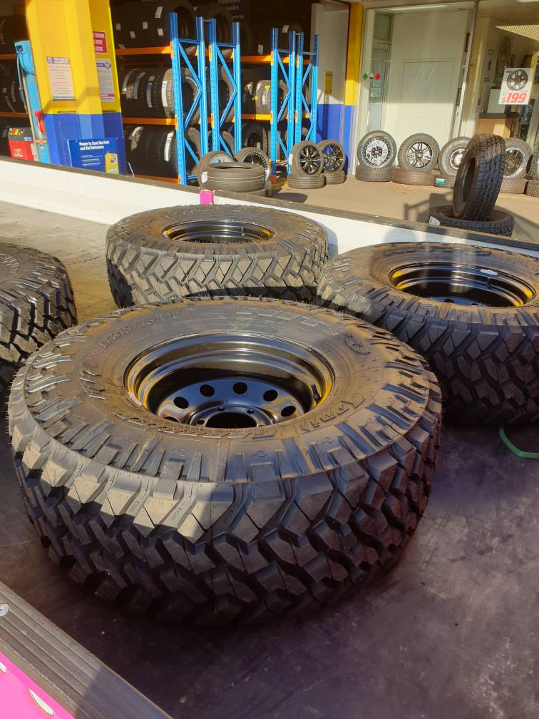

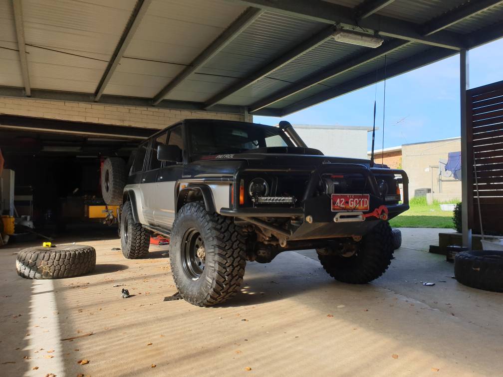

    Got some new tyres today, really keen to test them out soon. Did the guard chop and used RoadRunner flexy flares.

    35’s?........
  5. #1154
    15,847
    7,303
    35’s?........
    Yup. 315/75R16 Nitto Trail Grappler
    You wicked beast - you are tempting me I reckon! The flares look great. My concern is mostly the cracking of the paint when you bend the guard - how did that work out for you? The other thing is my terminal cruising rpm as the chevs can easily bog down and produce even crappier economy than when running at lower revs - not that i am too worried about economy mind you. Its kind of a natural progression I reckon.
  7. #1156
    15,847
    7,303
    I used a heat gun to warm the paint up but it still cracked a little. I masked it up and put some Killrust paint on it before fitting the flares.
