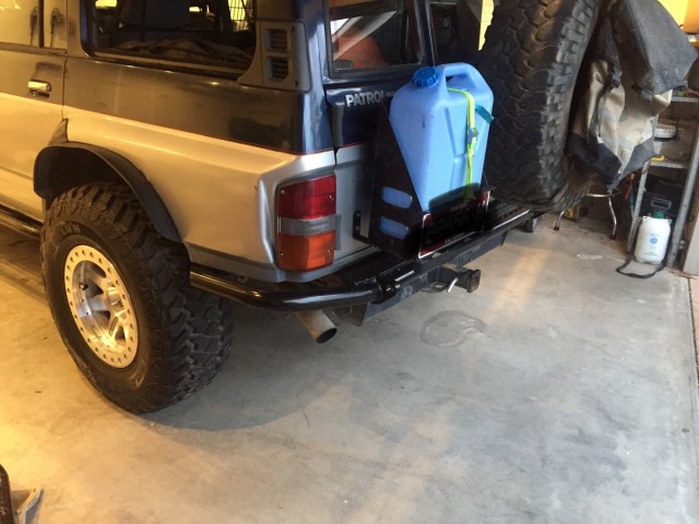

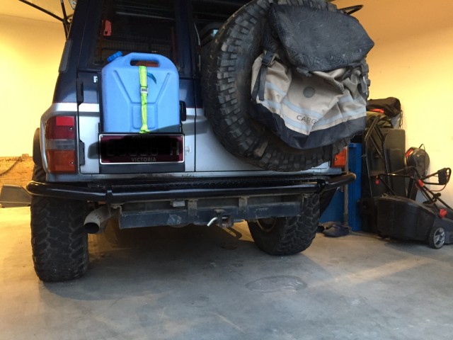

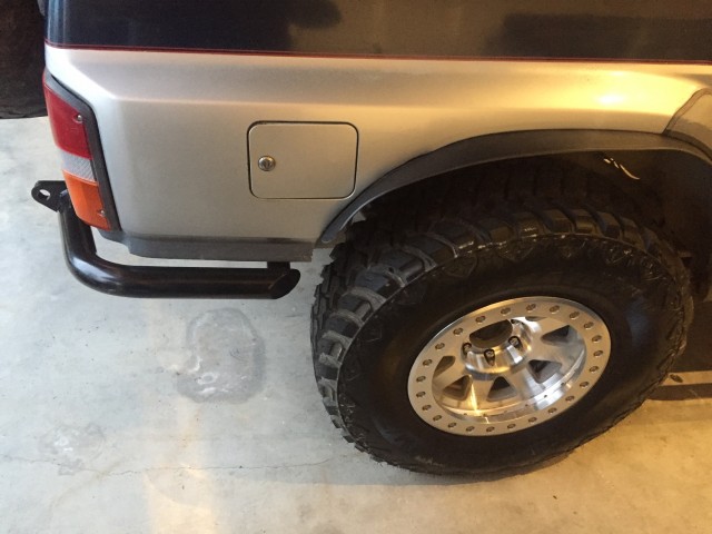

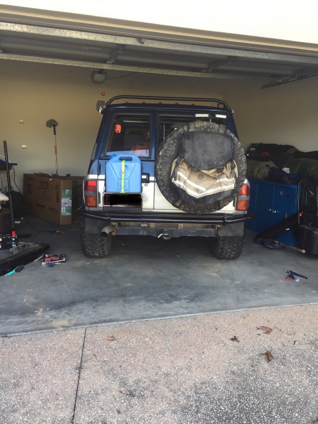

    Wife bought me a new rear bar as an early birthday present!!
    Then had to make new mudflaps , the old bar had mudflaps as part of the bar, I couldn’t really buy anything wide enough without making it look like a Mack truck so hopefully the police will see that I’ve made some sort of effort!!

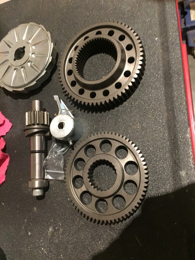

    First round of lower housing high mount winch bits turned up today, Gigglepin intermediate gear, Gigglepin billet brake assembly and brake pawl, Gigglepins new hurricane brake shaft and gear set https://smithiengineering.com/collec...icane-gear-set this set offers extra speed and increased strength, lowering gear ratios and a different spline count increasing tooth contact.
    Ordered +76 air Freespool which should be here next week.

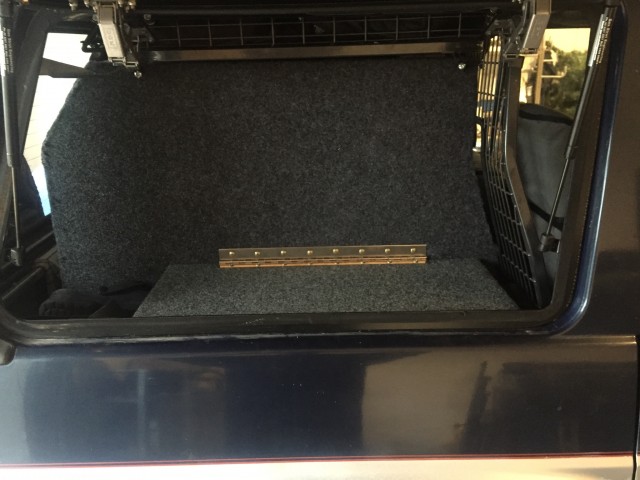

    Added a new steering wheel, put the stock wheel in the bin and fitted this one out of a NX coupe, looks and feels so much better
    Then carpeted the side board I made up against the fridge, then added a hinged shelf to gain more storage and being able to access the wings underneath

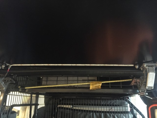

    Then added a strip light under the emuwings

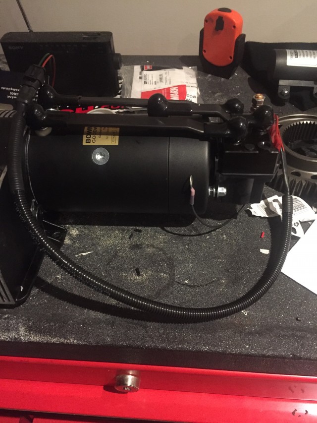

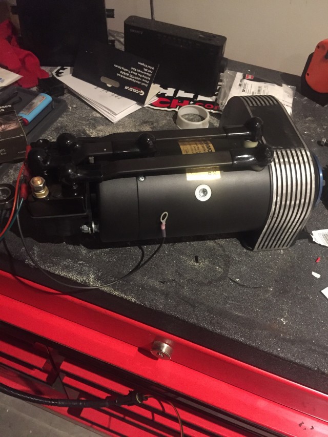

    Round 2 of winch bits turned up today, Bow2 motor, genuine Albright, Albright loom, Bus bar kit and extended bolts to mount the Albright on the end of the motor.
    Fitted up everything to my top hat tonight, the tops complete, just need two more bits to turn up and I can put the winch together and muscle it into the bar.
    The best thing about the bus bars is I just need to add power and earth and the wirings done!!
