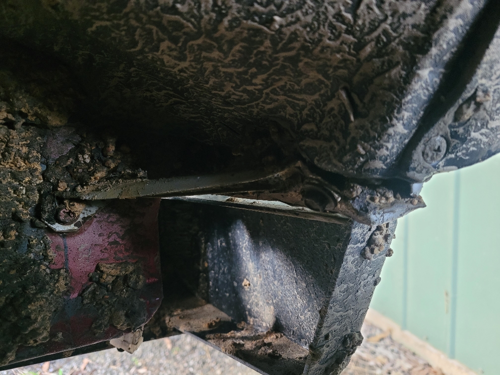

    Hello everyone!
    I noticed that my recently restored front fenders shake and flex too much for my liking when the TD42 is idling, specially after a cold start. Flexing to the point it will definitely crack the fender sheet on the places where I had to weld-fix them. It made me think that this vibration/flimsy is what made them crack in the first place.
    So, looking at the parts diagram online, I noticed three brackets to support the most flimsy parts of the fender, to attach them to the front panel and wheel well or maybe even the chassis. None of those brackets are present in mine and I need to fabricate them here to properly support my fenders.
    So, I was wondering if anyone could take pictures of the brackets on their Y60 Patrols showing the location where they are bolted and provide me a measurement of the distance between the two points of attachment? The reason I ask for the measurement is because if the bracket is shorter or longer it will widen or shorten the angle of the lower part of the fender, since it is very flimsy.
    A picture is worth a 1000 words, so these are the brackets I am looking for. I really appreciate your help!

    Here's a pic sorry she's a bit dirty lol. . Think there's only this one on the GQ, the parts diagram looks like an MQ guard although early GQ ute were a mixed bag of models for a bit. . Bracket is about 150mm long and should be a captive nut on the body end and nut and bolt on guard from what o can see / remember. .

    Here's a pic sorry she's a bit dirty lol. Think there's only this one on the GQ, the parts diagram looks like an MQ guard although early GQ ute were a mixed bag of models for a bit. Bracket is about 150mm long and should be a captive nut on the body end and nut and bolt on guard from what o can see / remember. .
    Thanks Rossco.
    This is most likely it. This seems to be from the fender to the front panel right? Do you have something similar from the back of the fender towards the wheel well?
