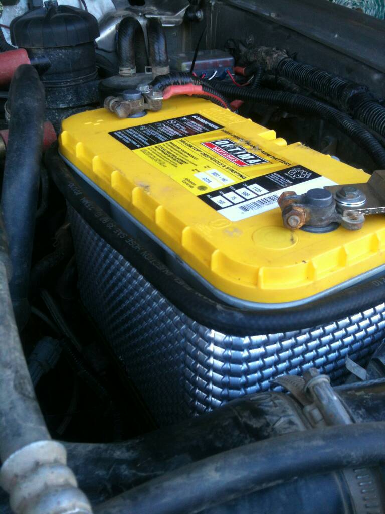

    Here's my basic heat shield. I used the stuff from supercheap. Folded it and secured it to the battery tray. Used some rubber fuel hose to top it off.
