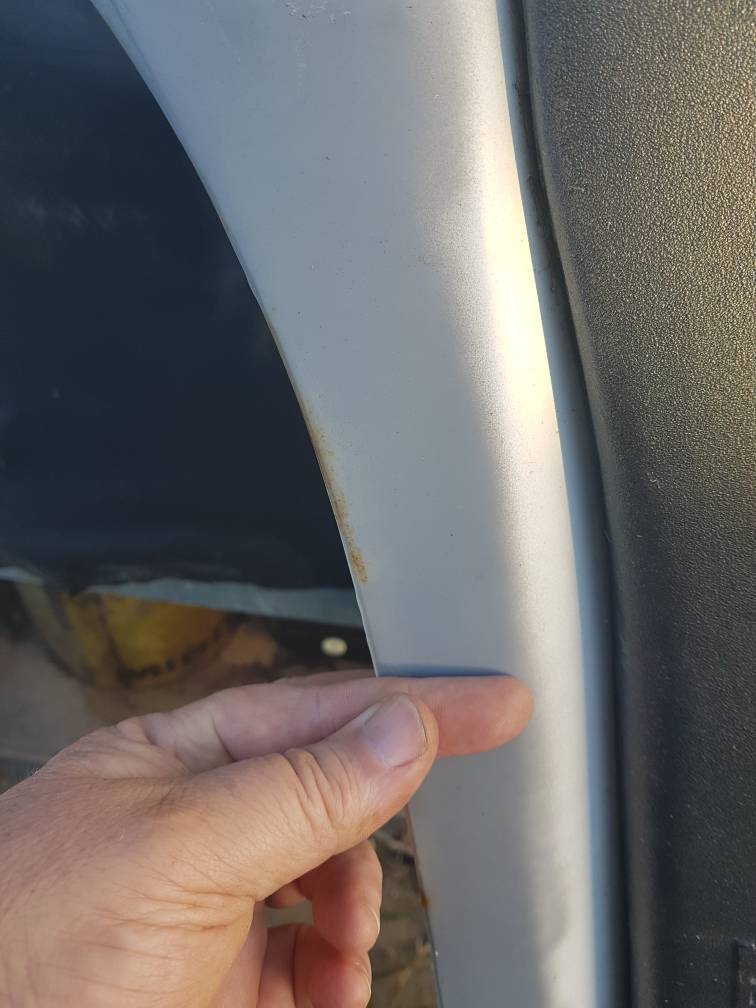

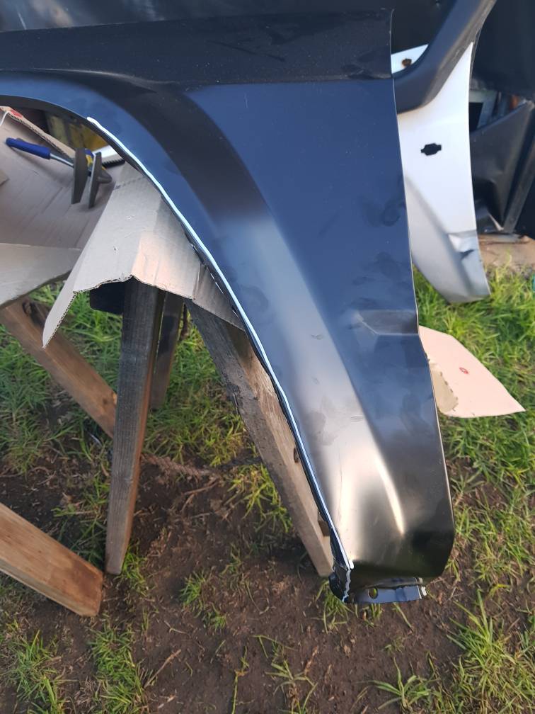

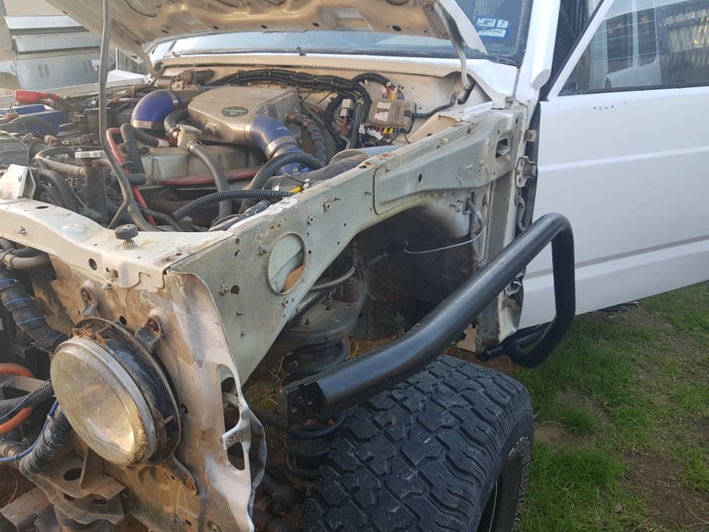

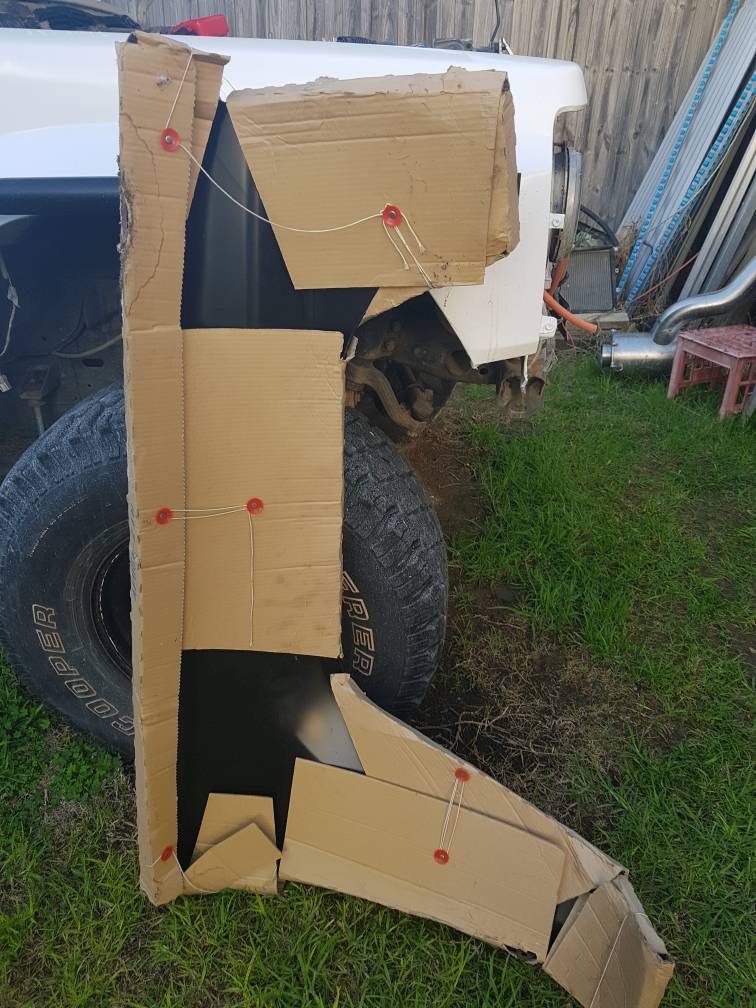

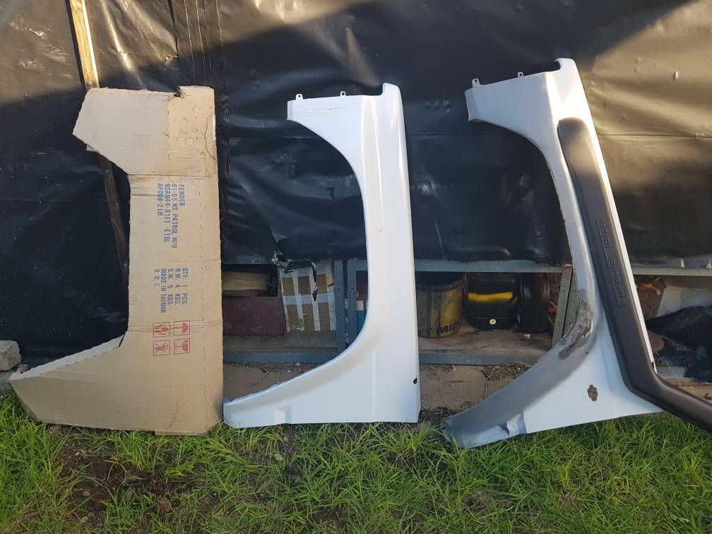

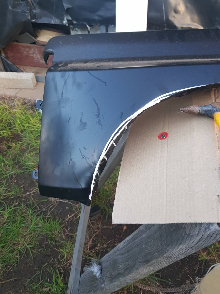

    So this weekend i dealt with a problem i did t really see coming damn it.
    When i went the new snorkel through the bonnet i needed to get rid of the passenger front guard. I scored a black one a coupme of years ago that was in the shed. The guy had already cut it for bigger tyres and it looked straight so on it went.
    When i bolted up the front scrubbies i realized he had cut too much off the top of the arch and my new flares would not go on. Damn it!

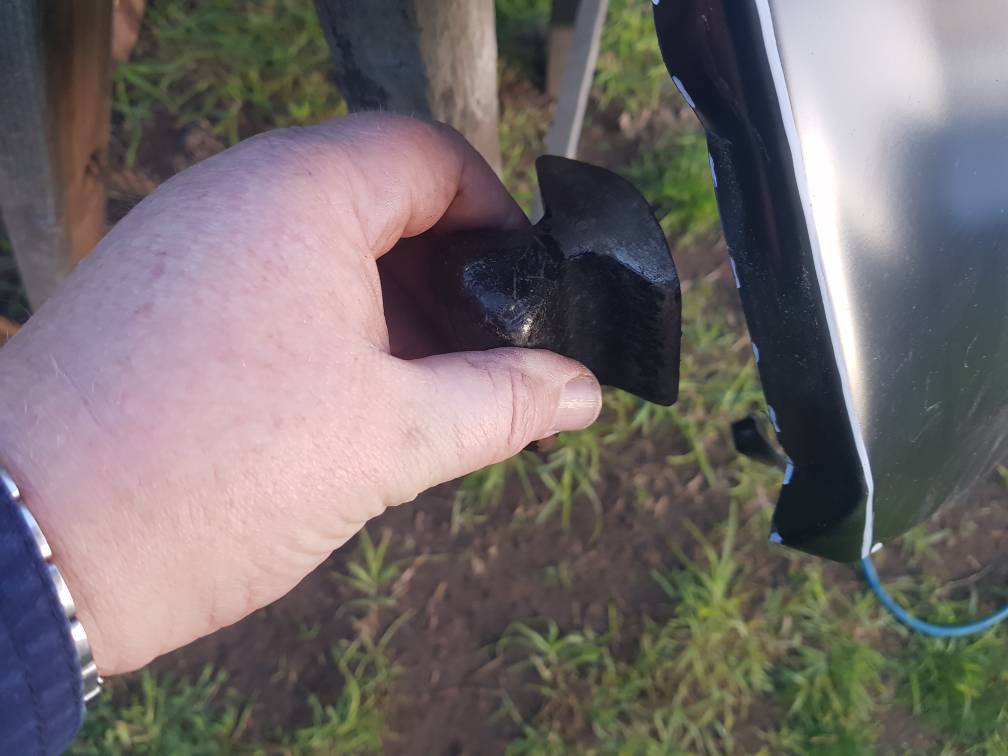

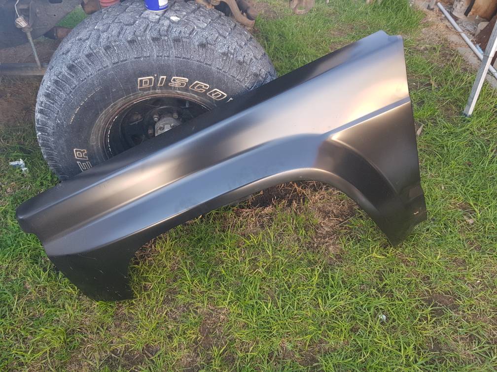

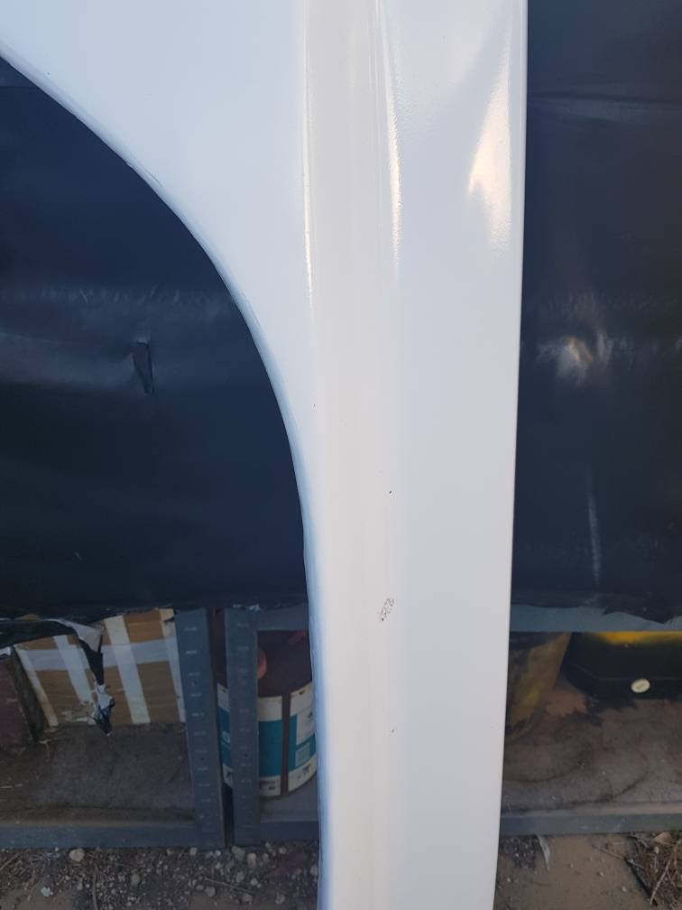

    10 years ago i scored a pair of Brand New guards that have been hanging from the roof of the shed ever since and now is the time!!
    Damn its nice!!!

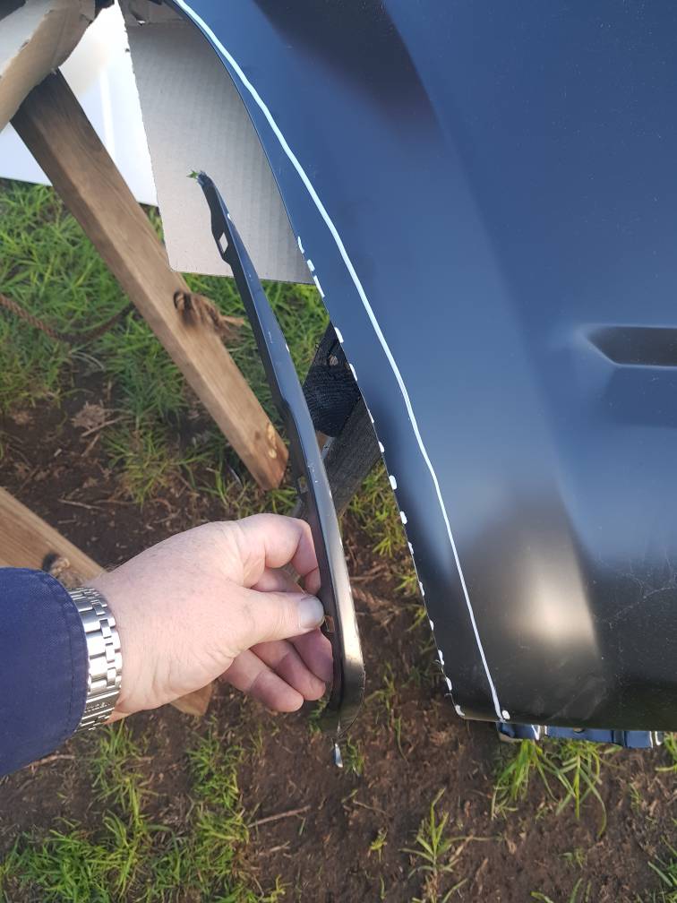

    Felt weird getting busy with a grinder and hammer!!

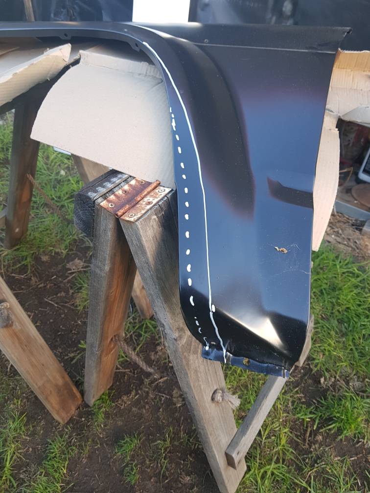

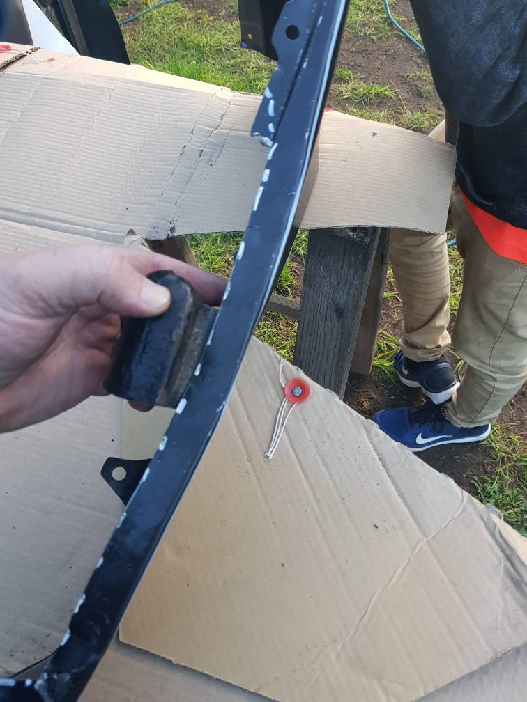

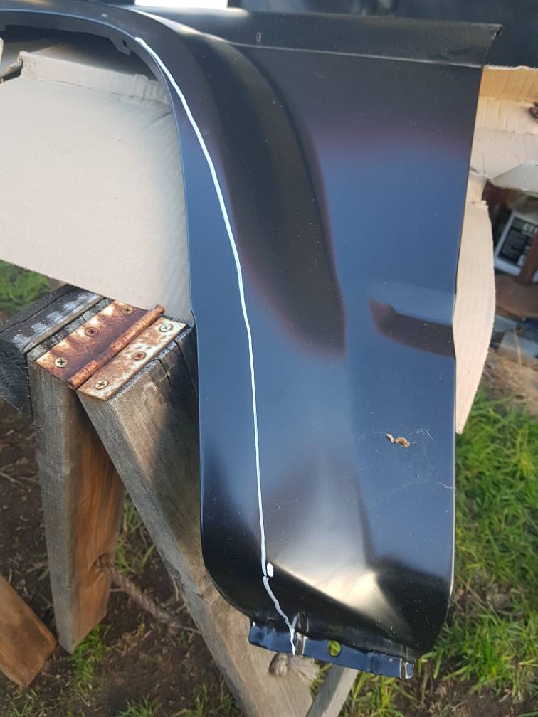

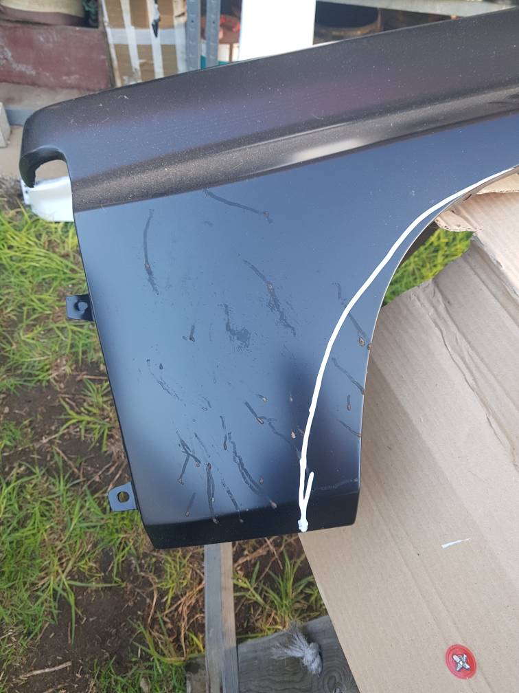

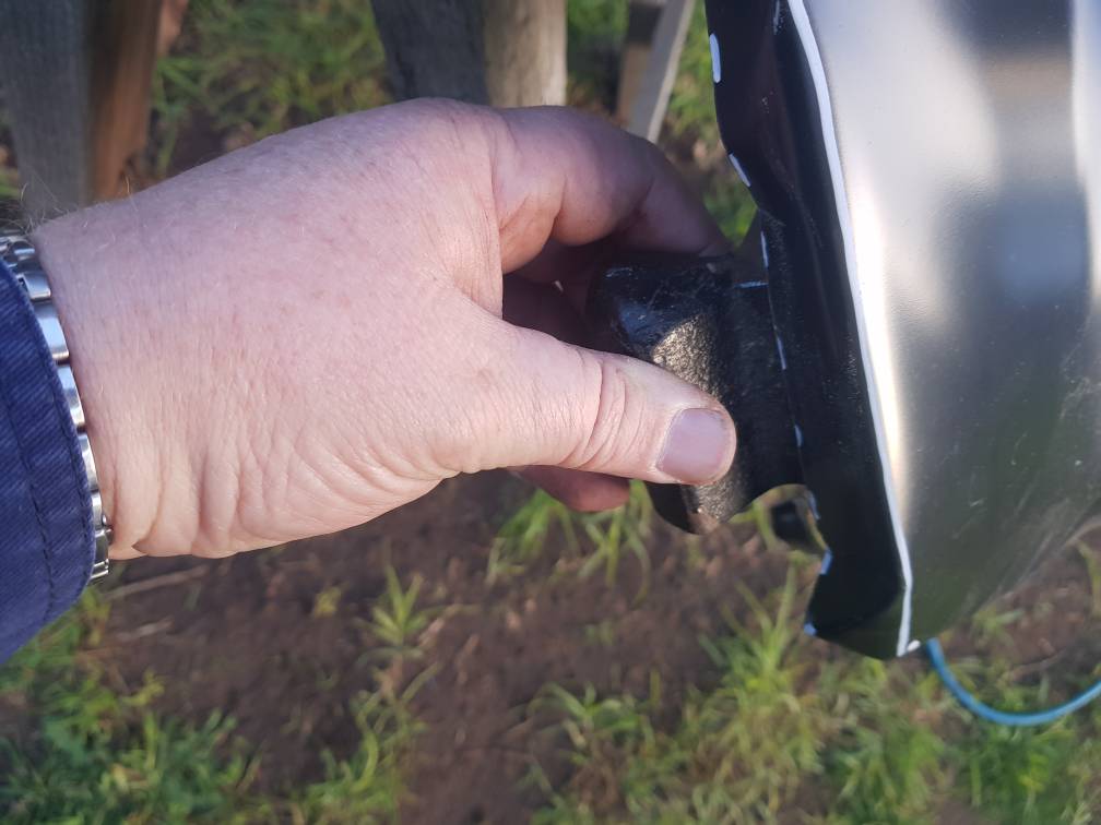

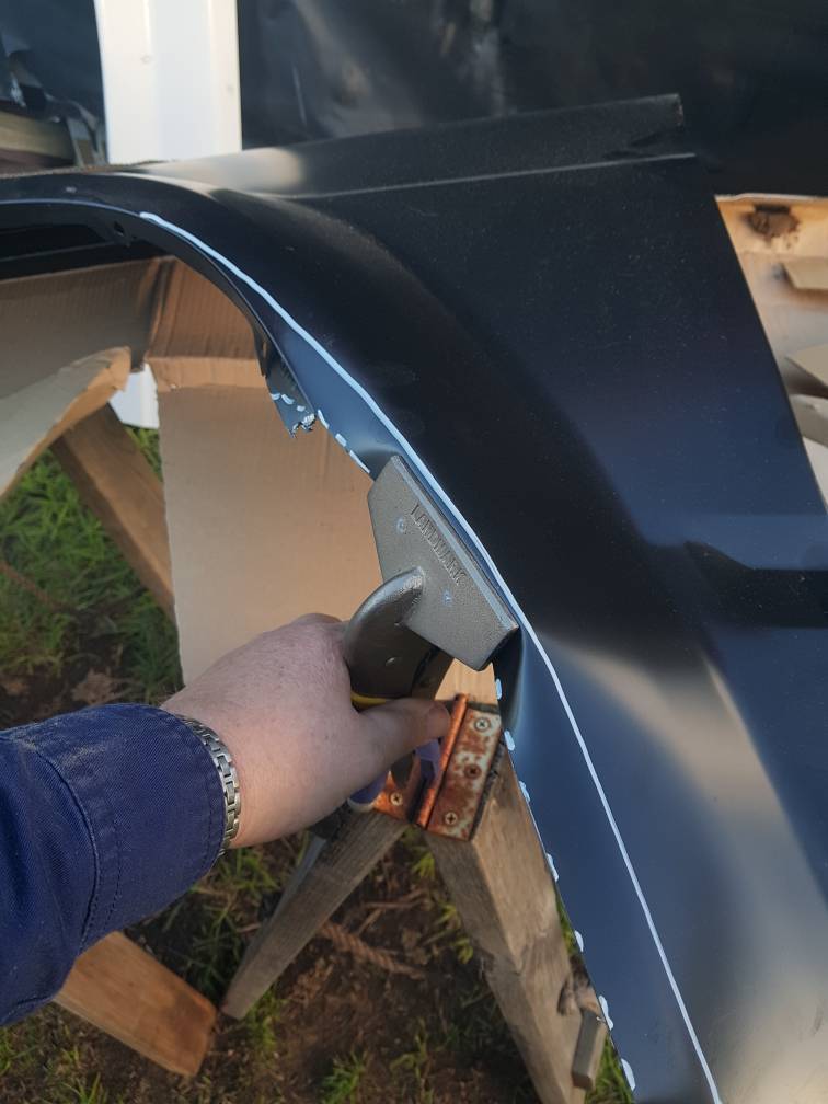

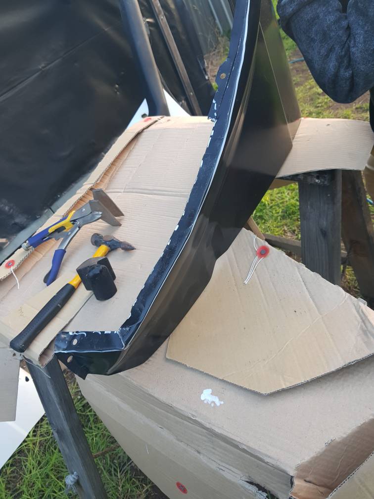

    Measured and marked up for the cut and fold to match the bar work.
    Cut on dotted line
    Fold to solid line.

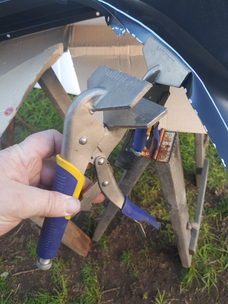

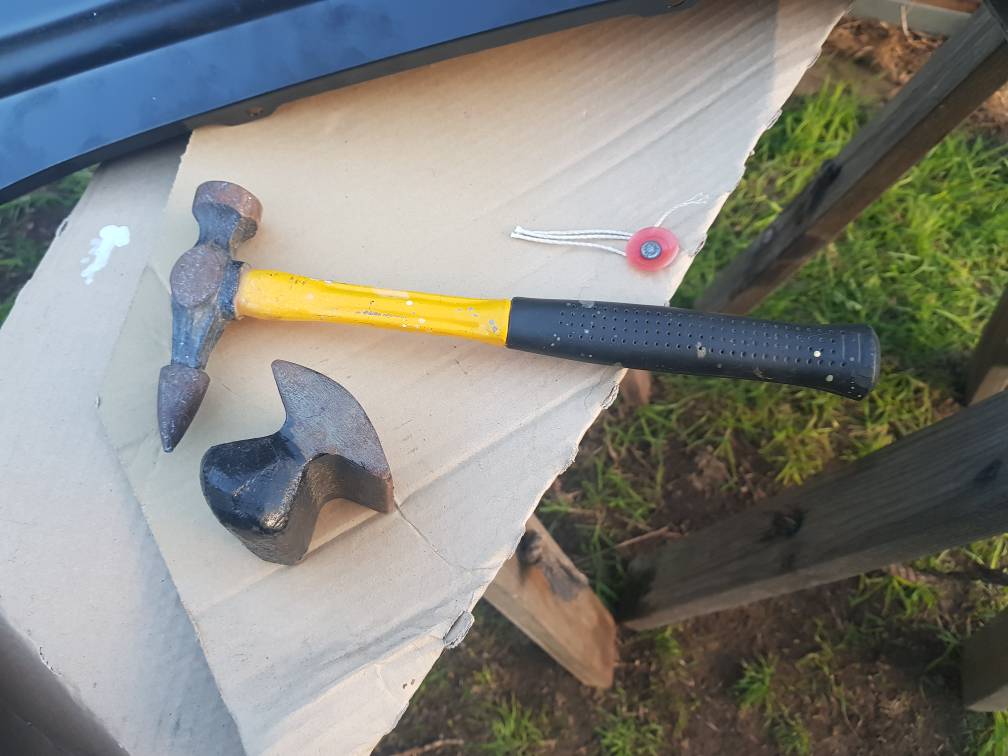

    Hammer and die set sorts out the fold and crease.
