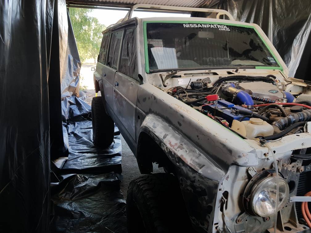

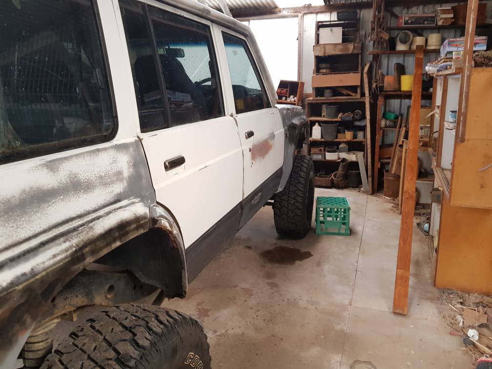

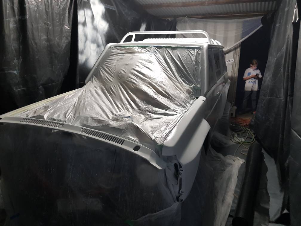

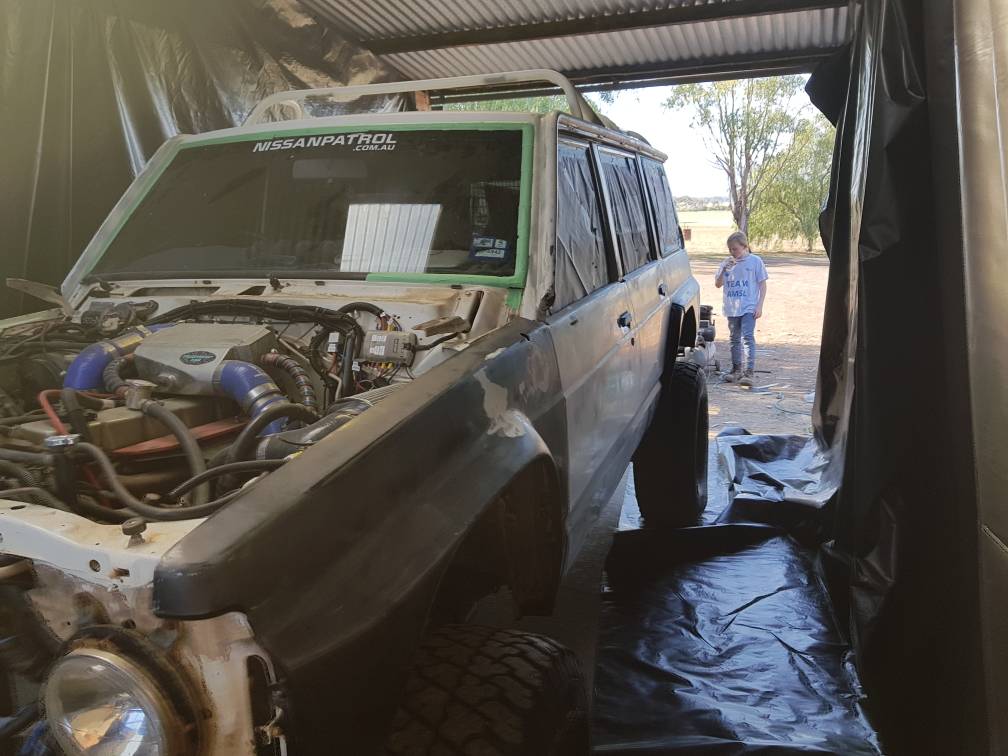

    Righto. Big weekend.

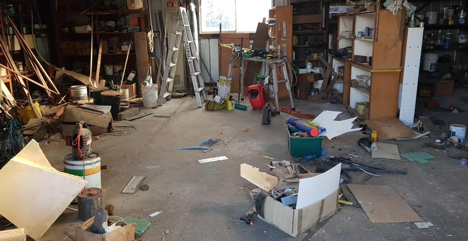

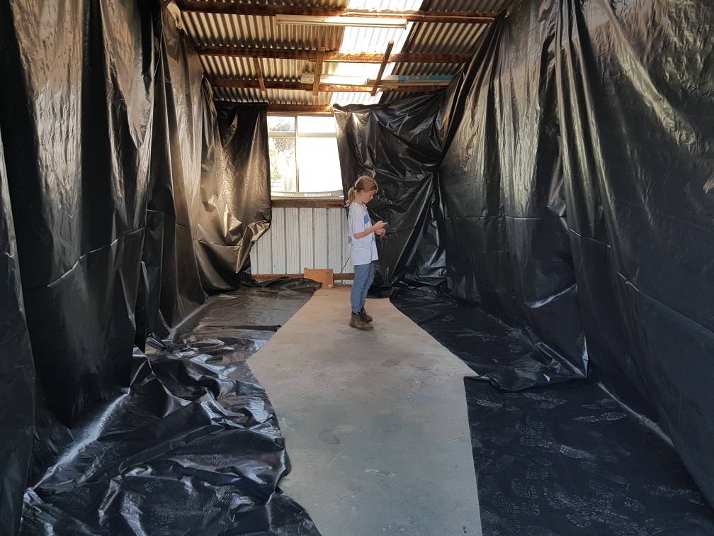

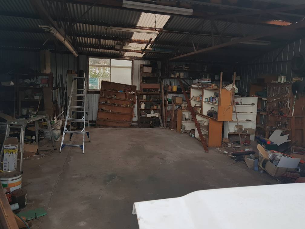

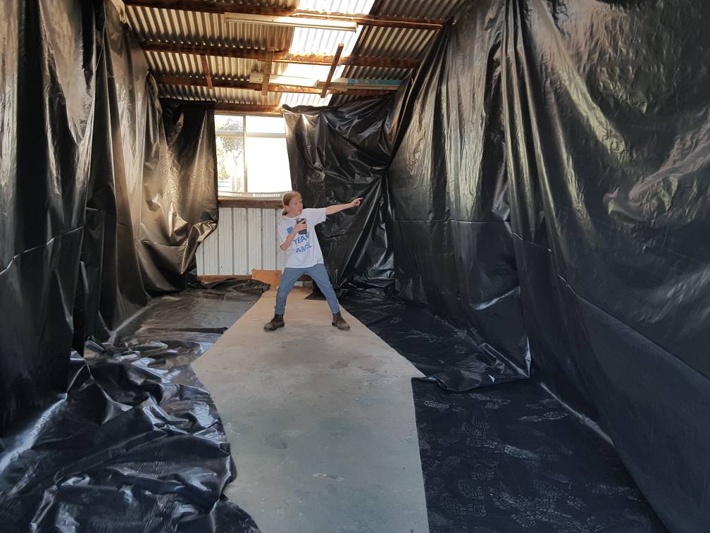

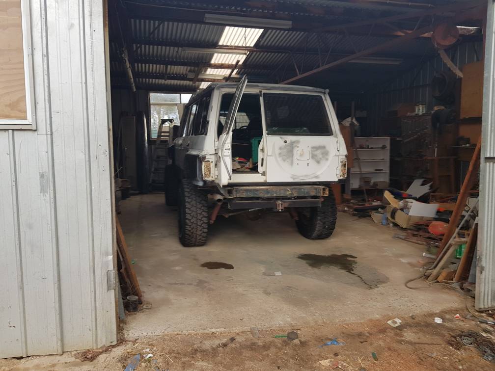

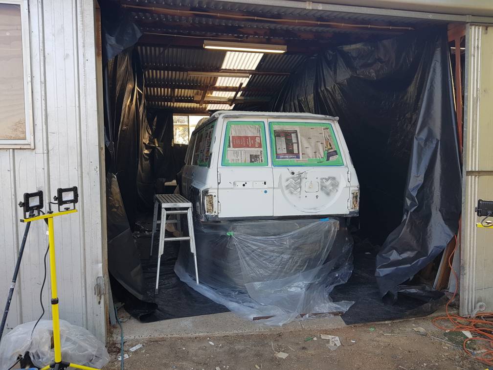

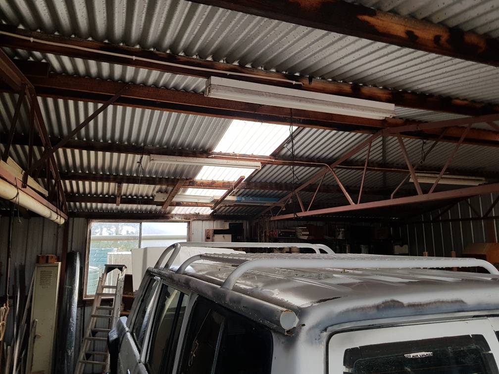

    Drove the GQ last weekend to a mates farm 5 kms down the road where he has kindly offered me his shed to paint the car.
    Needed a clean up but was a space i could work with.
    Got back out there this weekend and rubbed back the car again then had my dad and my sone Zach come out and give me a hand to tape up the car
    The little shit was wearing My Boots!!!! Holy Shit!!
    Spray booth good to go!!

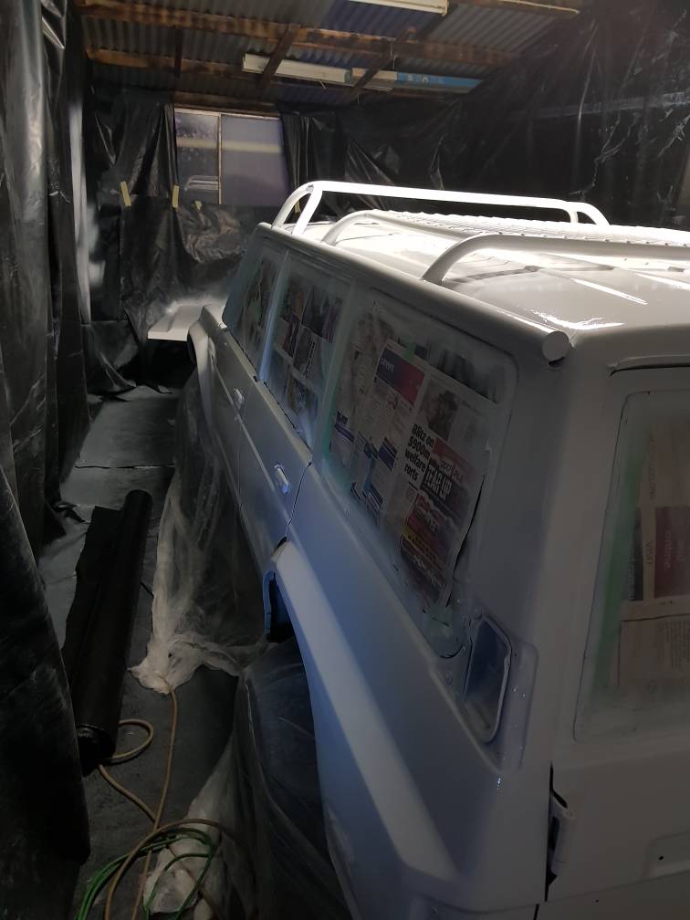

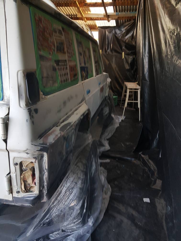

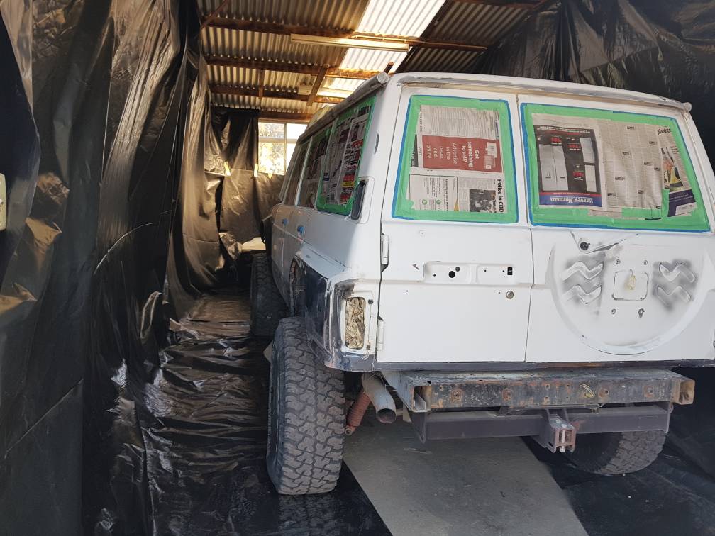

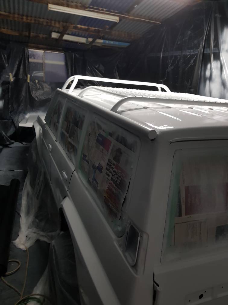

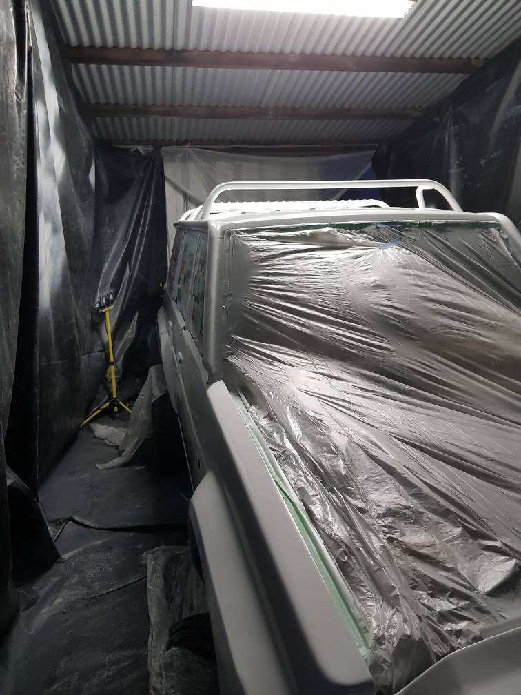

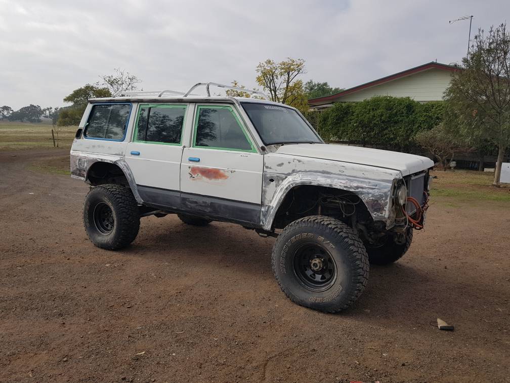

    Back to business

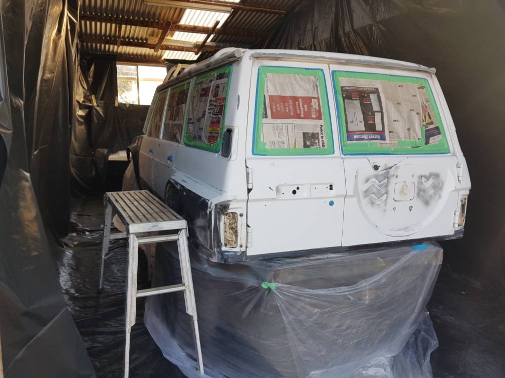

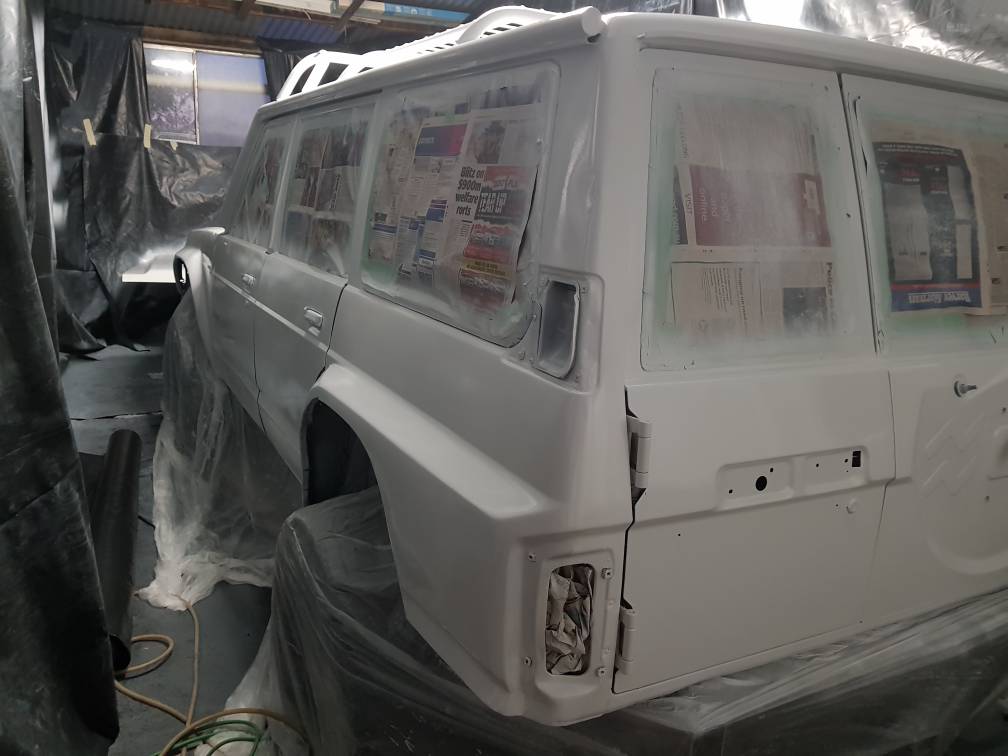

    The car sat out in the sun for a few hours while we set up the booth and taped up. The panels where nice and warm for painting.
    Into the booth and finish the taping and cleaning with wax and grease remover and tak cloth
    Time to get painting. I was a little anxious about painting as the last time was a bastard.

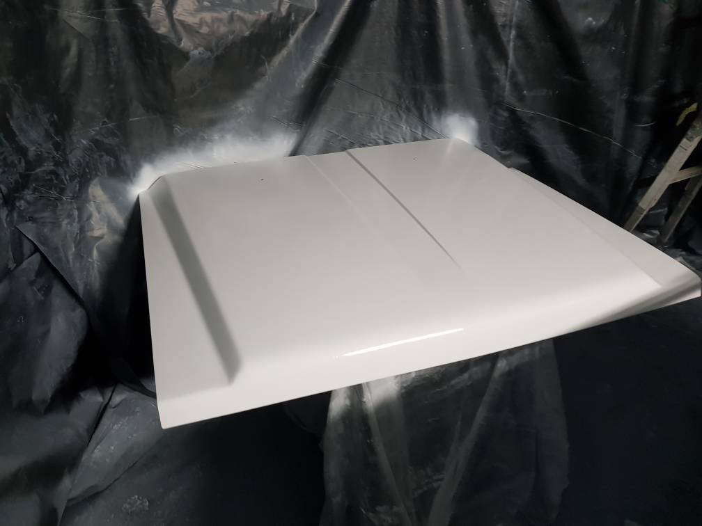

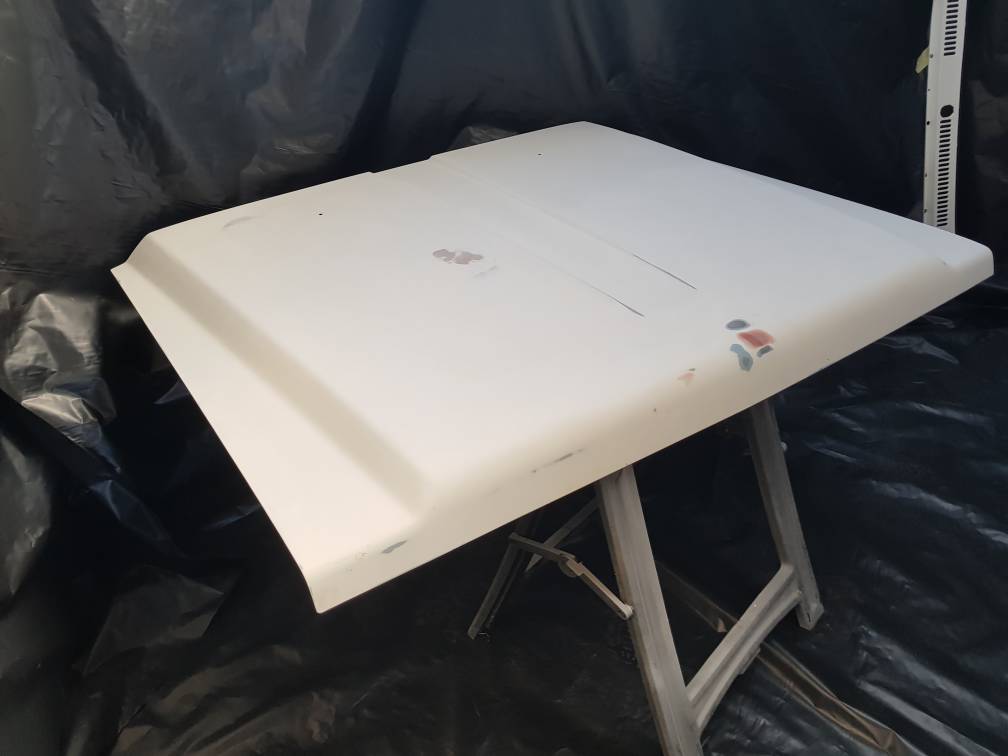

    1 flash coat and 2 heavy coats on the body and 3 heavy coats on the bonnet
    PAINT IS DONE!!!!

    PAINT IS DONE!!!!
    When does the colour go on? Or is it staying liquid paper white?
    Colgate Whitening White thank you!!!
