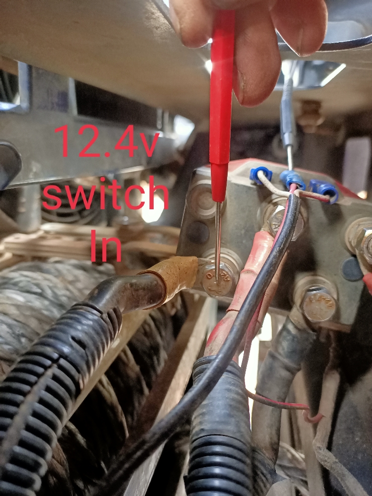

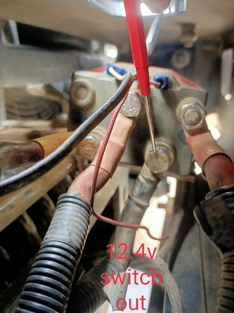

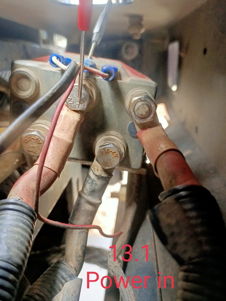

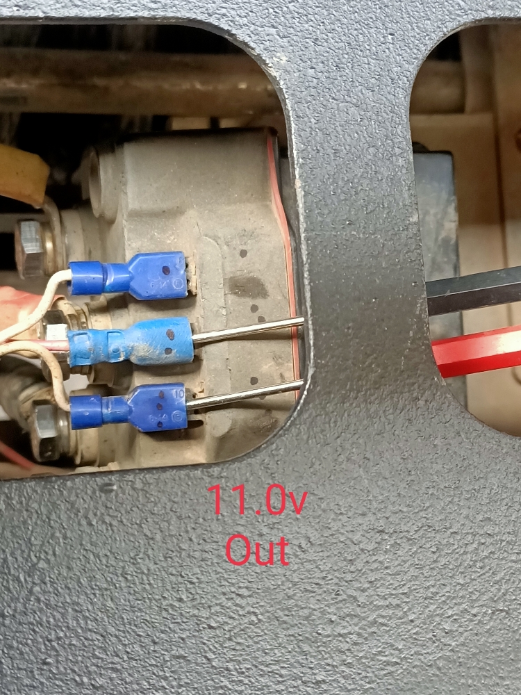

    Did some more testing today.
    1st.
    I tested as per the video that pb put up and no difference.
    2nd
    I tested the solenoid.
    Hope it makes sense.
