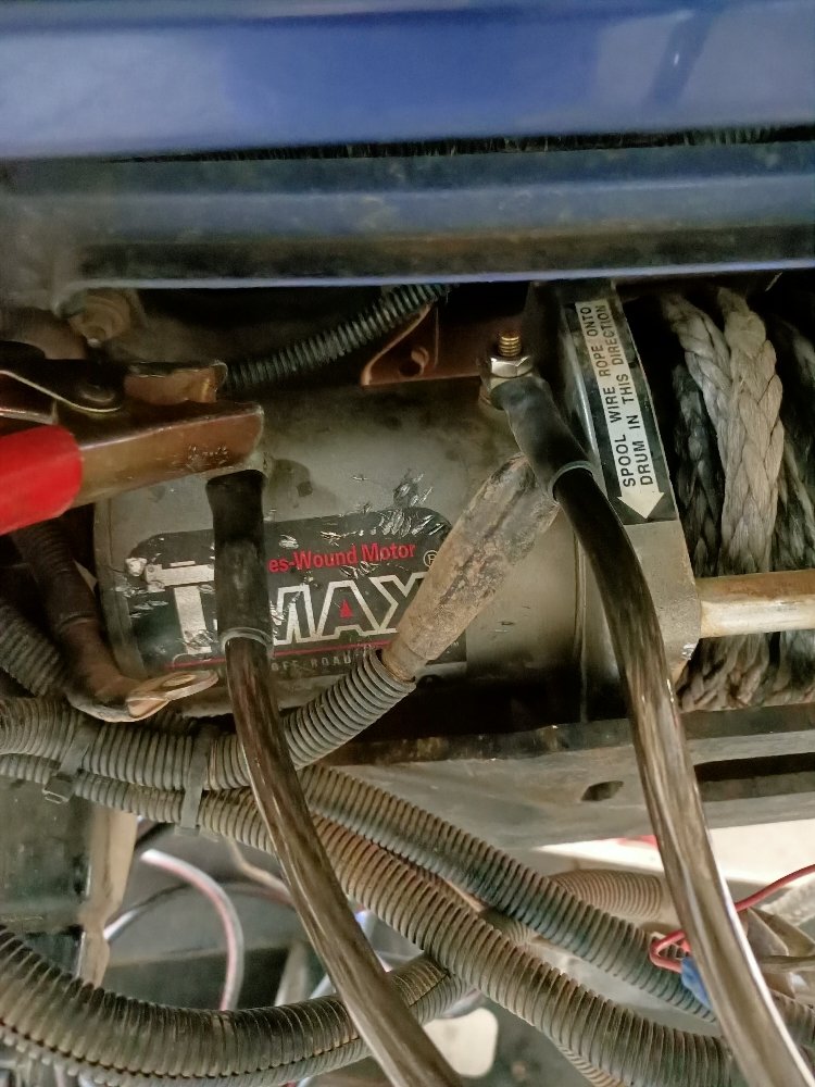

I've disconnected everything going to the solenoid, the neg and the red terminal from the winch do its free on any power. Then I connected a battery, neg to neg on winch and positive to red on winch. Got a little spark on contact, but no movement at all. Am I doing this correct??
While all connected to the external battery it goes from 12.2v - 6.0v. is there not enough juice in the battery to get it moving or is the winch dead??
I think is safe to say that it's dead, If I have done this right.
Tried it again, but this time connected to the car battery and engine running, no difference.
Now if I get a bare winch I run all my existing cables, solenoid and rope everything should fit just a remove and replace yeah....
EDIT....
And I also connected a cable (the brown one in the pic) from the red terminal to the yellow one with no difference.

Looks like I had the power on the wrong terminal.
And of course before I put the bar back on I gave it a go and it worked, not everytime I hit the switch, but it did work and then when it's all put back together, it doesn't work.
I pretty sure that the motor works, it's just that it doesn't work everytime the switch is pushed
PeeBee (17th July 2021)
Is it a wireless controller, or the cable unit? Maybe a wire is loose inside the control box.
