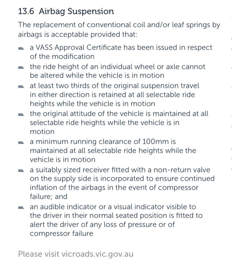

  4. #3
    For us Vic Mexicans:
    https://www.vicroads.vic.gov.au/-/me...319217ECDEDEB1
    If you’re in a rush Tip Mate it might pay to chuck some coils back in whilst assessing/collecting all the mechanical sensors, buzzers, flashers needed for engineering certification
