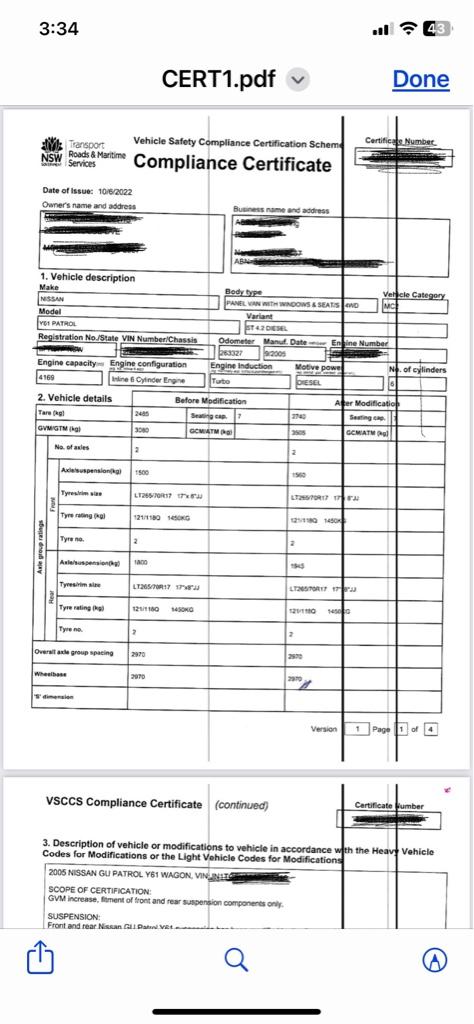

    Sorry I haven’t been back for some time.
    I have had the GVM upgrade and since put airbags in (a new set - as one of the older had a hole)
    I’m more than happy with the outcome, it’s just what I needed.
    Attached is a copy of the compliance certificate showing among other things, the before and after GVM, front axle rating and rear axle rating.
