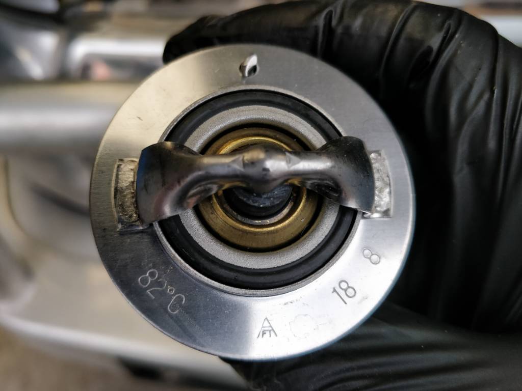

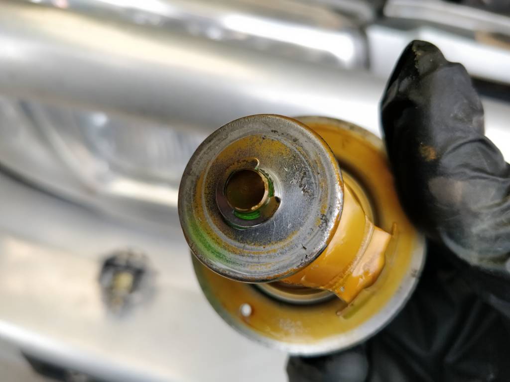

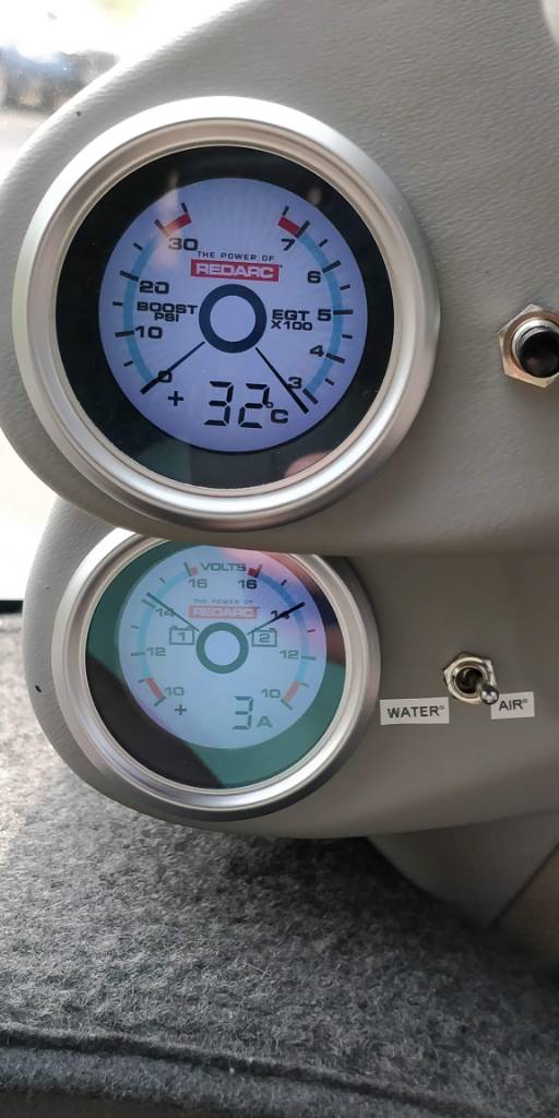

    I replaced my factory 76.5°c thermostat with the 82°c unit from Nissan.
    I drained about 2L of coolant from the bottom of the radiator and that was enough to clear the thermostat housing.

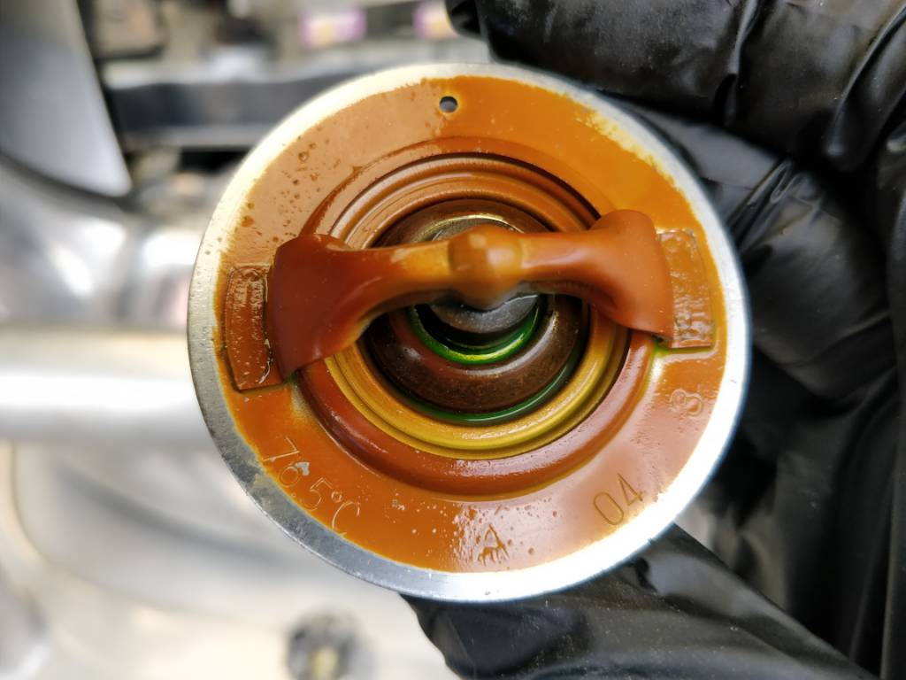

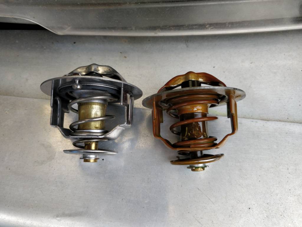

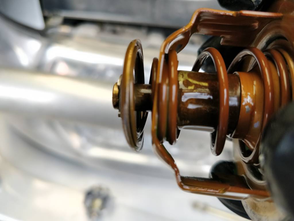

    On removal of the old 76.5 it appeared to be damaged.
    The bottom looked bent and there was a scuff/indent on the base.
    I'm not sure if it was having an effect on the temperatures.

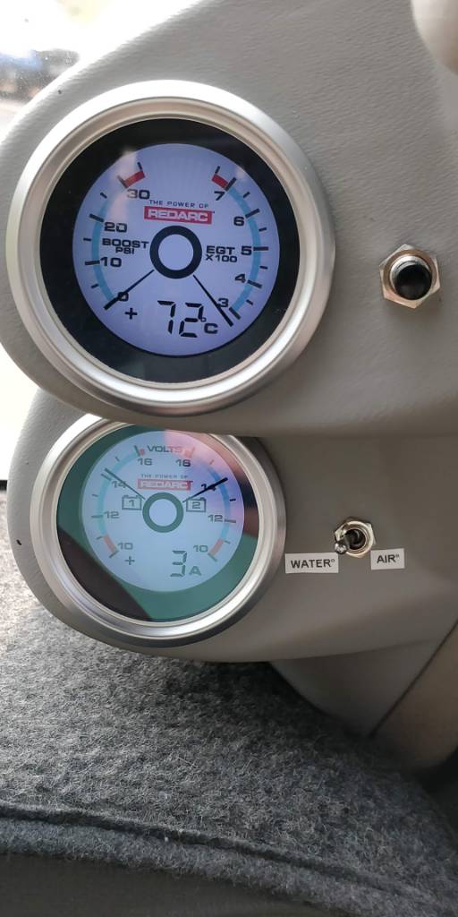

    Here it is in February this year on a day that was about 30°c, stationary, and it was sitting around 72°c.
    Old thermostat.
    New one.
    I'll see how the new 82c one goes over summer as the weather warms up here in Vic.

    Yeh I'll be very interested to see how the fuel economy goes. I've just filled the tank too, so this will be good timing.
    Interestingly I drove it today, unloaded, no passengers, almost no incline in the terrain and it got to 77°c pretty easily.
    Short trip, but I'll test it more over the next few weeks.

    Here is an update of my experience in switching from a factory 76.5° thermostat to a 82° thermostat on my 2004 GU III TD42ti.
    I've been logging the fuel consumption and keeping an eye on the operating/peak temperatures.
    This is the last four full tanks of fuel before and after I changed thermostat:
    With factory 76.5° thermostat
    2020/03/05 – L/100km: 14.27 trip: 562km
    2020/03/19 – L/100km: 13.54 trip: 618km
    2020/05/27 – L/100km: 13.81 trip: 571km
    2020/07/11 – L/100km: 13.16 trip: 608km
    — 589.75km average
    Installed 82° thermostat 15th Oct 2020
    2020/10/06 – L/100km: 13.59 trip: 568km
    2020/12/23 – L/100km: 13.74 trip: 536km
    2021/01/22 – L/100km: 12.87 trip: 621km
    2021/03/01 – L/100km: 12.69 trip: 648km
    — 593.25km average
    These have been general use around town as well as some trips away, but nothing more than 4 passengers and belongings without a roof rack.
    So relatively light load on the vehicle.
    Here are some temperature photos of the water temp and ambient temp with the 76.5° thermostat.
    And the same once I switched to the 82° thermostat with a similar ambient temperature.
