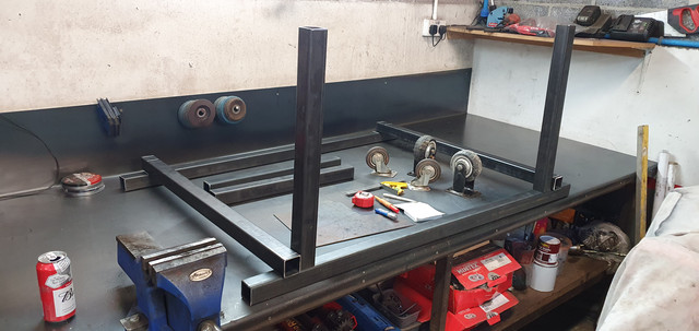

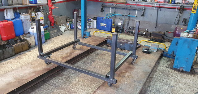

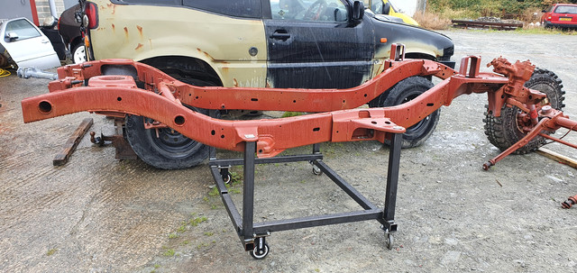

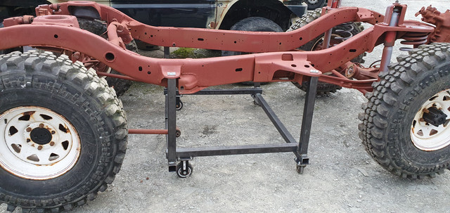

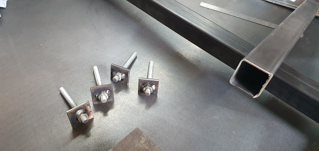

    Things are starting to move again, which is awkward when I'll have no axles in the morning

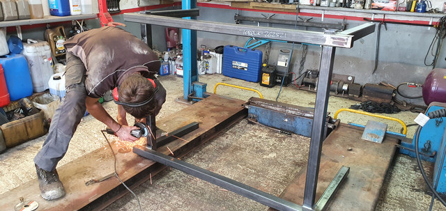

    Decided I better make some kind of chassis dolley trolley thing to keep it moveable. 50mm box and a tape measure to the rescue
    We had a few odd wheels about so kind of worked around them .
    Keeping it simple , I thought simply measure the body mount positions and support the chassis with this frame. How hard can it be

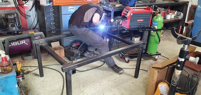

    The boy's got a new welder, so I'm not allowed anywhere near it , lol, shame

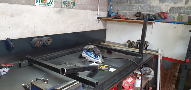

    That's the wheel plates on, now turn it over and weld on the nut caps.
    Spin it over again and bolt the wheels on, oh, wait, bugger, that's on wrong
    Never mind, a quick cut, grind and reweld the plates on the right way round
    Better

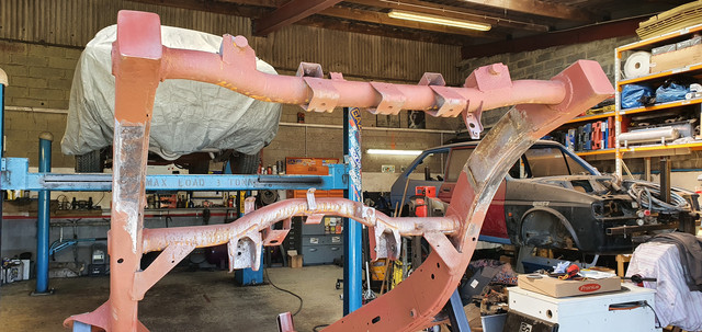

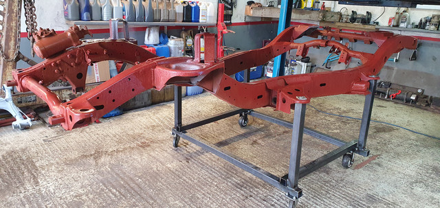

    Then the rather awkward task of wrapping the chassis over the dolley
    Got there in the end though, as I dropped a bollock on my sums the rear needed a quick cut n shut again, oops.
    So tomorrow these axles are off on a pallet to Malta , as you do . Then I get to start bracing my Y61 axles
    Onwards.

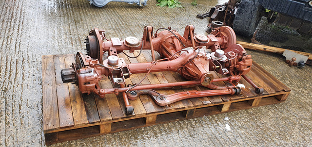

    RAINING, again
    Wet, wet, wet, not the band but my pants, euw but hey the axles are off
    Found a suitable pallet and got the heavy load sorted ready for it's trip to Malta, gotta love tinterweb ££££
    Got the trolley dolley back inside for a dry out

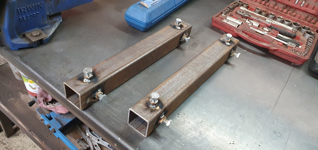

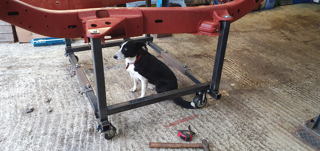

    The frame has a cock up due to my measure error, so decided to fix it by making it more versatile lol
    Got some 60mm box to slide over the 50mm box. Welded on some nuts so now I can vary the width of the frame for some reason that will become clear in some future project, maybe

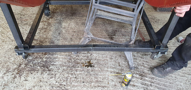

    End result is signed off by the top dog
    Anyway, it's been one of those ideas to make life easier. I thought a couple of hours lol, nope, but hey it's here now and once I've done chassising, it'll work a treat under the shell
    Onwards

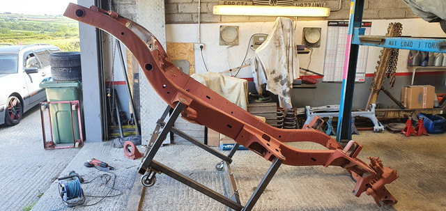

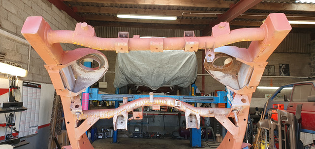

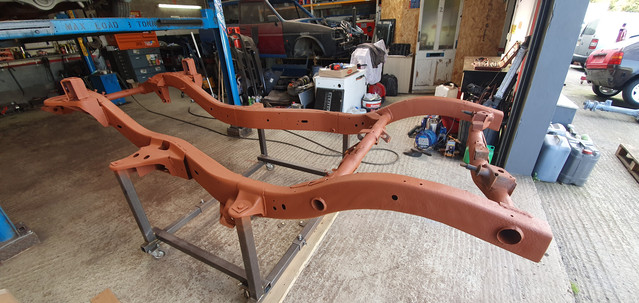

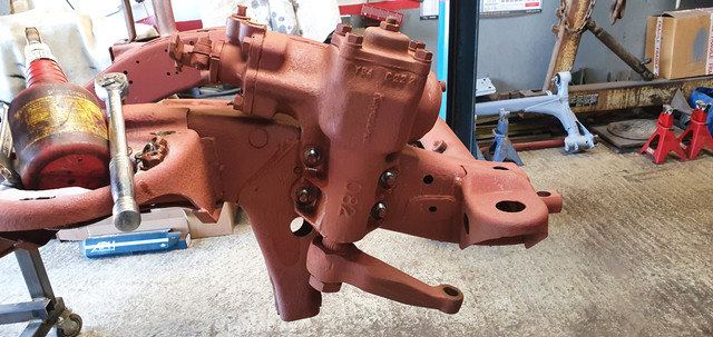

    Sunday and the sun is out , yay. Typical as I'm on paint today
    So my super chassis trolley has another trick. I can tip it up either end and get underneath easily. Just as well cause I'm cutting out the coil towers ready for rewelding them further aft.

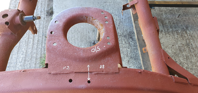

    Took some datum point measurements as reference.
    You can see a lot of surface pitting but probably won't reuse these bits anyway.
    Spring tops and drop link points removed and area cleaned up.
    Now a lightweight chassis
    Steering box was next to go, damn that thing's heavy. Made the whole trolley experience even better though
    At last , I got some paint on. I'm using BUZZWELD rust encapsulator primer . It's almost as expensive as printer ink, so it better bloody work
    It may not look much different but it's safe to go back in the rain at least.
    I've ordered diff case protection as they I think are worth buying. I'll make the rest of the bracing.
    Trailing arm material is proving more difficult to find but I'll get it .
    Onwards.

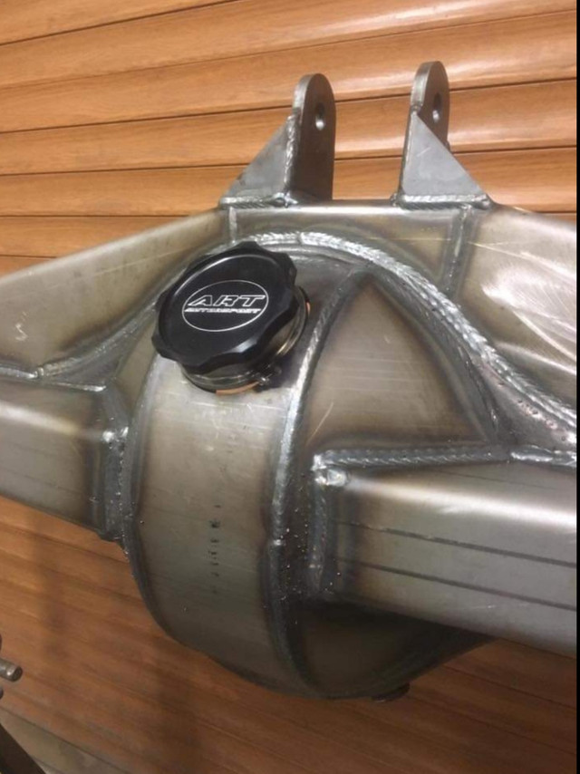

    Diff lock actuator thingy
    I have a snag regarding the diff lock actuator thingy. Mine is goosed
    I'm also fitting diff case protection as below. Do you guys know of any alternative gizmos that will do the job ? Especially one I can incorporate into this casing ?
    Thanks in anticipation
