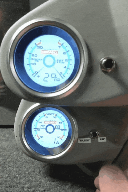

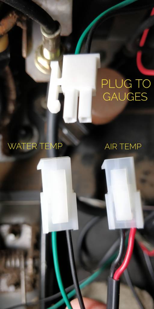

    I had already purchased an ambient temperature sensor with the gauges but after seeing @MB monitoring his coolant temperature I thought that would be more informative and beneficial for the car.
    I had an idea about switching between the two temperature sensors and called redarc to check if that would be possible. They confirmed that it should work and the black wire is the signal wire which makes a reference with resistance to ground and that's what changes the temperate reading.

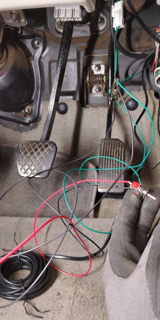

    I fitted the coolant temperature sensor and an ambient temperature sensor and added a switch on the black wire to the gauge. (For some reason the water temp sensor had a green positive and black negative bit the air temp sensor had a black positive and red negative, of those even matter with a temp probe?)
    Here is the ruffing in to test it works.

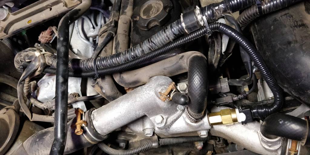

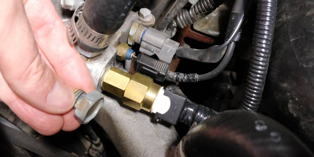

    The coolant temperate probe goes into the thermostat housing. I bought the Redarc GS-OWT1-4 which is a coolant or oil temperature sensor with a 1/4" NTP thread. I also needed a metric pipe reducer M12 x 1.5 to 1/4" NTP thread. I had to grind down the length of the thread on the reducer so that it screwed into the housing all the way.
    I fixed the air temp sensor next to the headlight on the drivers side.

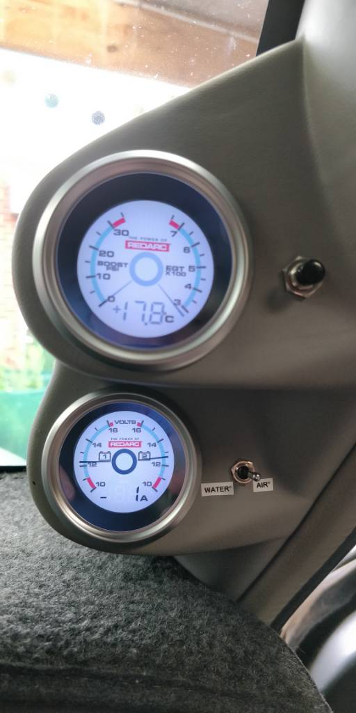

    And here is the switch mounted next to the gauges. I had already drilled a hole for the programming switch, which I didn't need next to the dual voltage gauge, so I used that to mount the toggle switch.
    Here it is in action

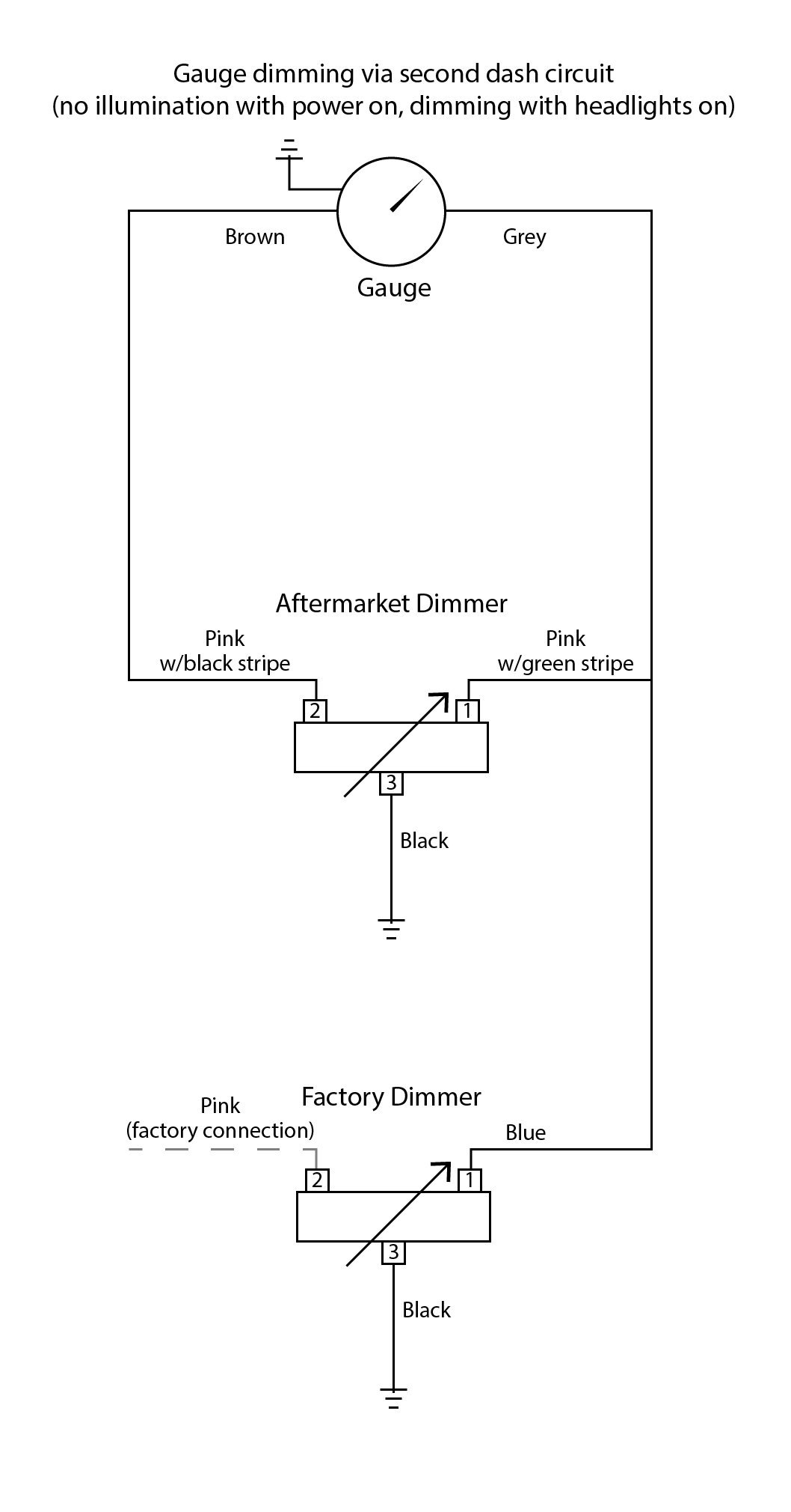

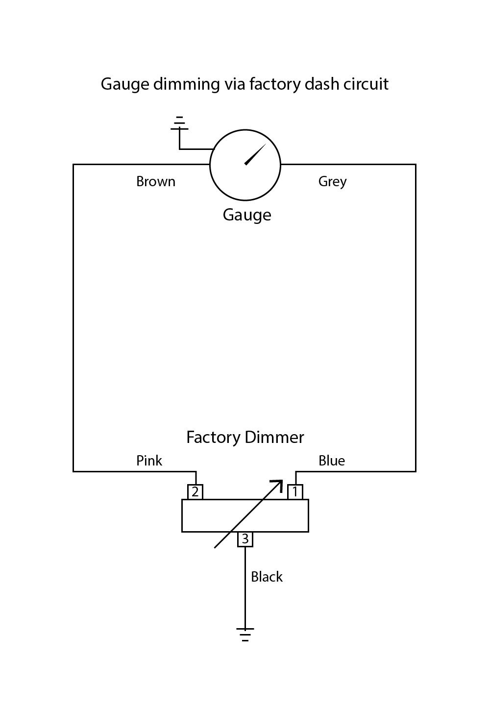

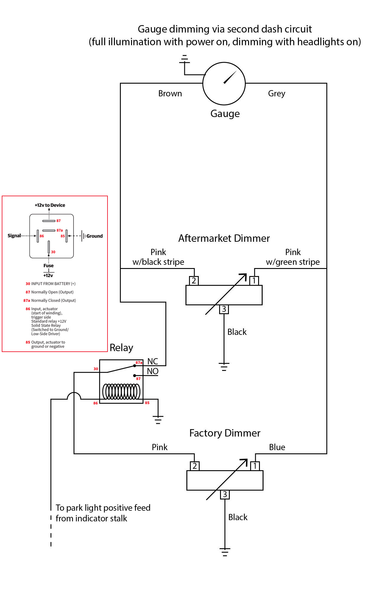

    I also wanted to add an independent dimmer switch for the gauges as they were too bright at night. I had them hooked up to the dash dimmer successfully, but when they gauges were a good brightness at night the dash was pretty much not illuminated.
    Getting the second dimmer to work with the gauges did my head in. I literally spent hours trying to work out how I could get a dimmer to do what I wanted.
    Originally I thought I could add the second dimmer after the first and reduce the voltage to the gauges, but this didn't work.

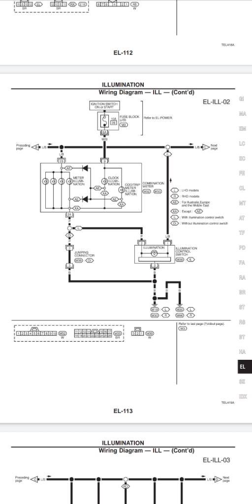

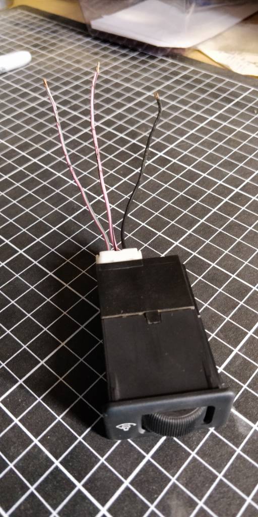

    Looking at the wiring diagram in the workshop manual (sm7e-2y61g1 – el.pdf) I worked out that the illumination wires feed into pin one and two on the dimmer switch. Then the earth from the dimmer grounds the connection and completes the circuit.

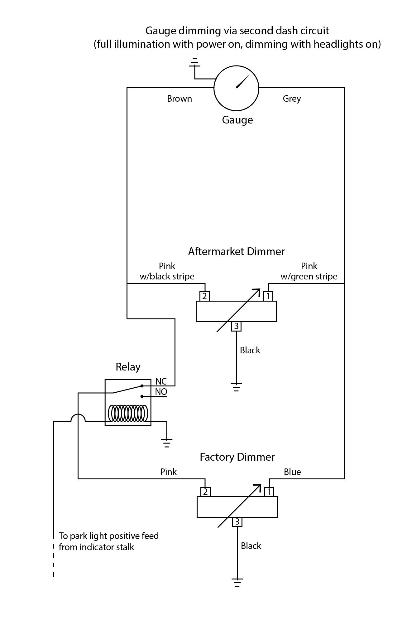

    I ended up taking a positive feed from the blue wire going into the factory dash dimmer switch and connecting that to the positive wire on the second dimmer (pink with green stripe in the case of the plug I got with the dimmer) and also to the grey wire on the gauges. Then I connected the brown wire from the gauges to the second wire on the dimmer (pink with black stripe) and the third wire on the dimmer (black) to earth.
    This dimmed the gauges when the parkers/headlights were on, but didn't supply illumination to the gauges when the headlights were off but the ignition on.
    I needed to connect the brown wire from the gauges back to the dash light negative (the pink wire on the factory dash dimmer) but doing this would basically hook the gauges back to the factory dimmer switch like I had working originally.

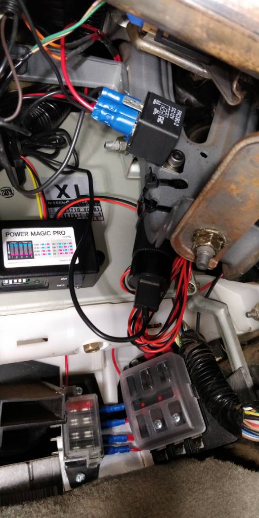

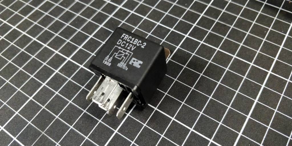

    I needed to cut the dash light negative when the headlights were turned on to separate the circuit for the second dimmer so I used a "normally connected" relay triggered by the positive wire from the parkers on the indicator stalk.
    This worked perfectly!
    Here it is wired up under the dash.
    Here are the wiring diagrams of each iteration

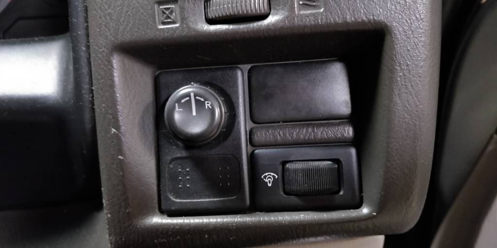

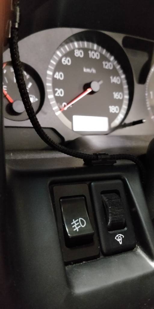

    So now I have the factory dimmer for the dash lights on the left of the steering wheel
    And a second one on the right next to the rearview controls that just adjusts the brightness of the gauges
    Here it is in action - full brightness all the way to no illumination (but the gauges still operate).
