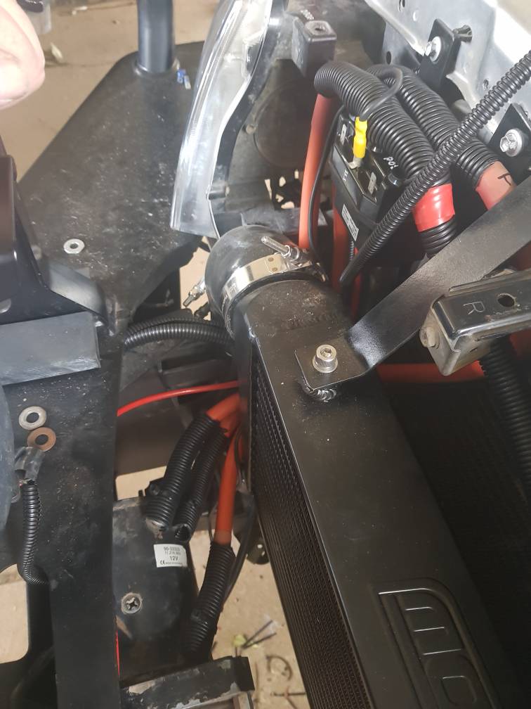

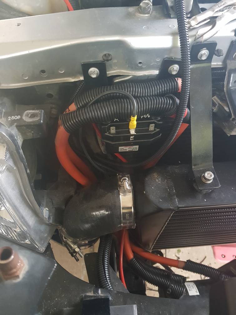

    So weekend just gone i had to refit the winch and re ran Ll the wiring and changed everything out to 70mm/sq. I also had a gigglepin Solenoid ready to go so took the opportunity to fit that into a permanant place in preparation of a himount i might have in the shed waiting a rebuild.
    I also ran the airline and wiring for the front airlocker i added a couple of weeks ago and wired into the mounted compressor in the back drawer wing. Switches also mounted in the dash (no pics sorry gents)

    She's turning into a beast Daz, love the front mount engine bay looks heaps neater. .

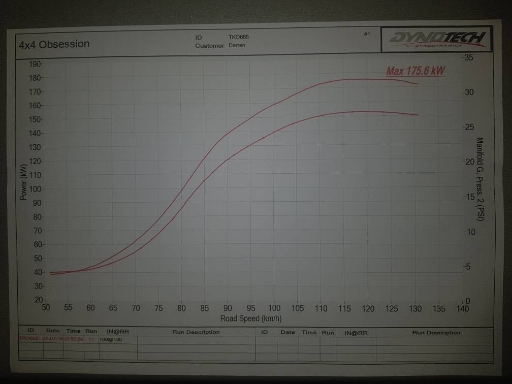

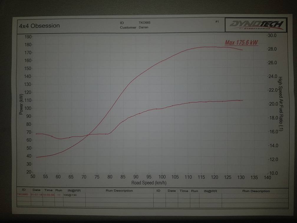

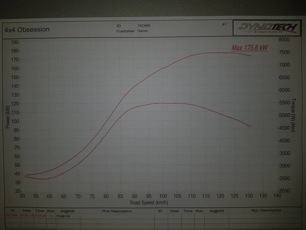

    And today is the day. Brand new Terrain Tamer Excedy Tuff Clutch
    On the rollers. They we te e not prepared to do a pre tune roll because of the big fuel big boost he didnt want to risk damage which i appreciated.
    Roll off
    176rwkw.
    550nm Torque
    AF of 21
    Max EGT of 550.
    Speaking with the Tuner tonight and he compared the result to a UFI 18g but with a better AF ratio and lower boost. He was very please.
    When it was tuned by deiseltec Andy re removed the boost controller ans tuned the boost off the Actuator which he set at 27psi. 4wdObsession didnt want to change that setting so gave me a safe tune with what i presented.
    Roll On Power is kind of crazy in 5th and plenty of punch in every gear.
    Very happy. Clutch feels weird but once im used to that I'll be stoked.

    Keen for a drive of the beast at Licola mate lol

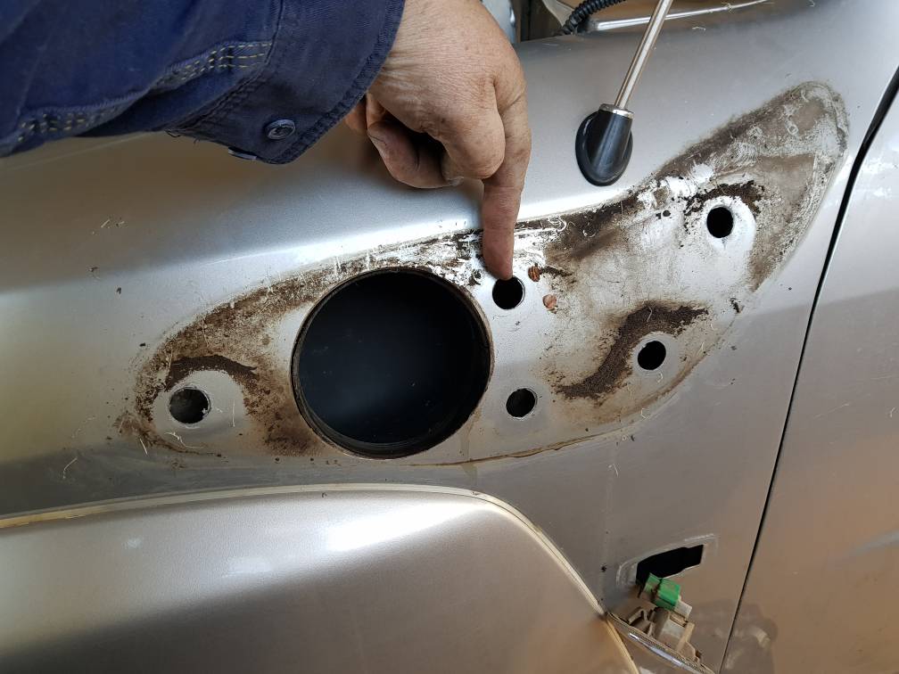

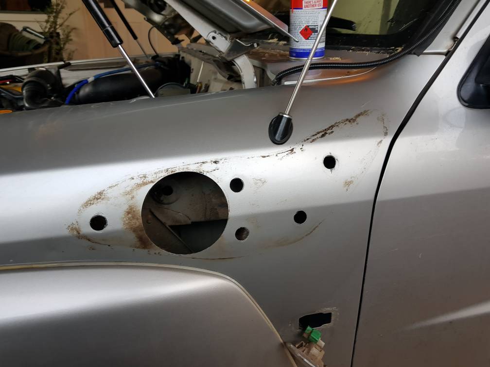

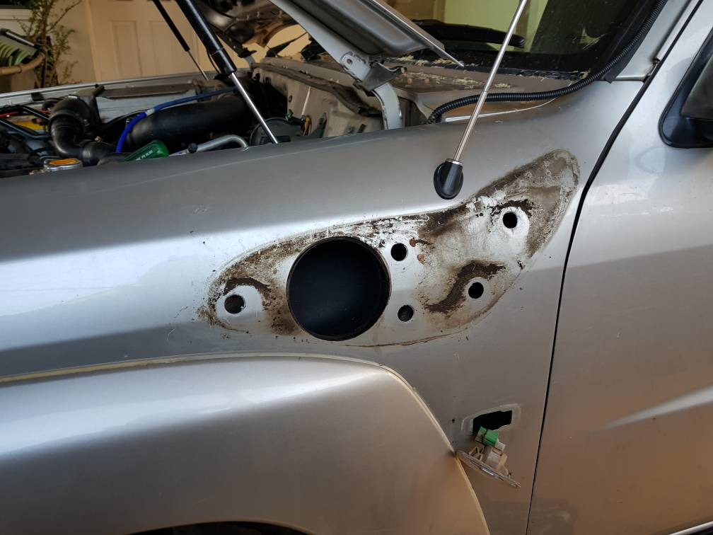

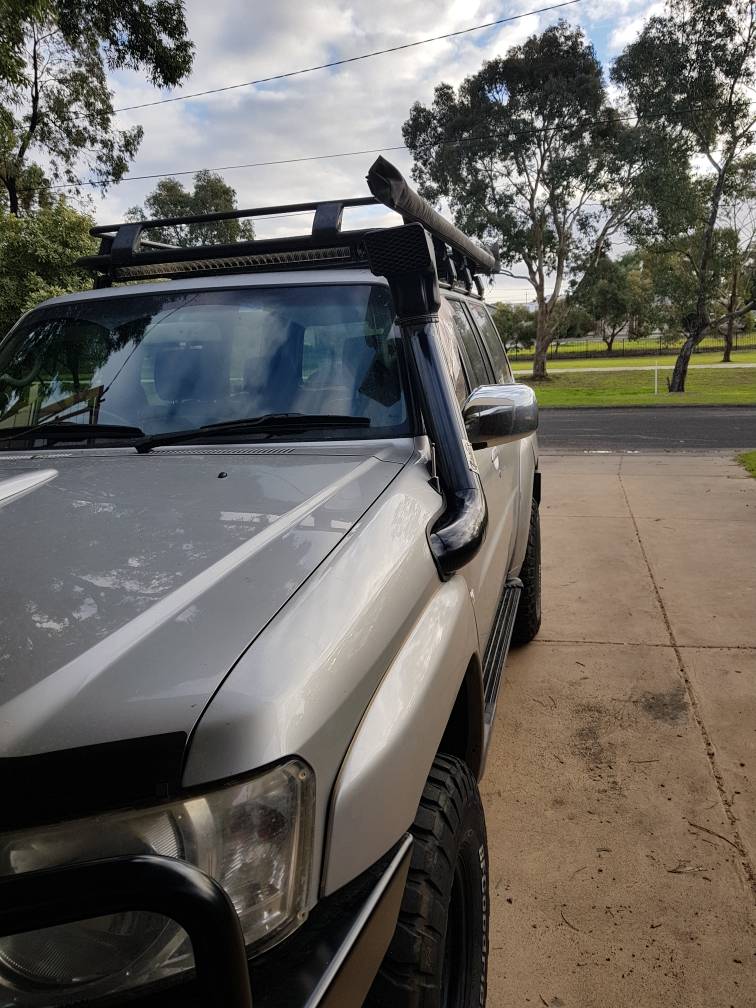

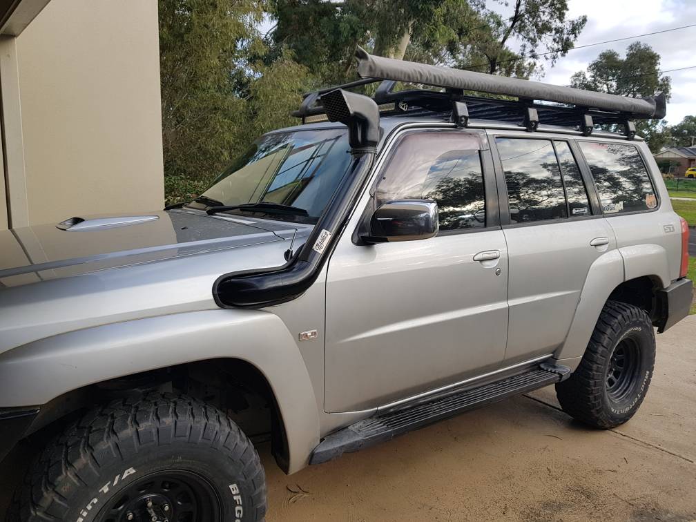

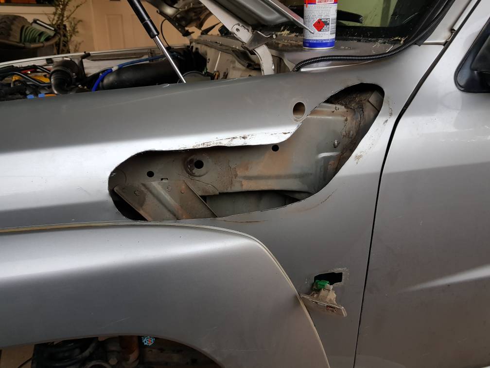

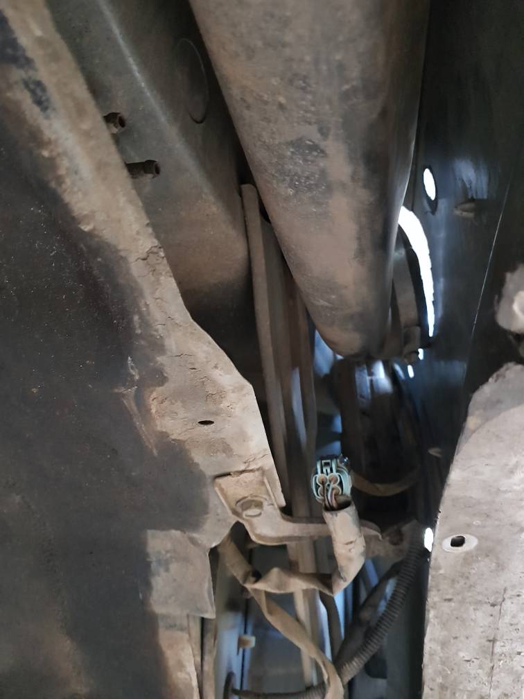

    Here are a couple of pics of the Snorkel fit up. I scored a second hand Radius Fab snork and airbox for a great price i could bot pass up.
    Came up a treat.
    Ok Snork pics
    Yes it was Real!!!!!

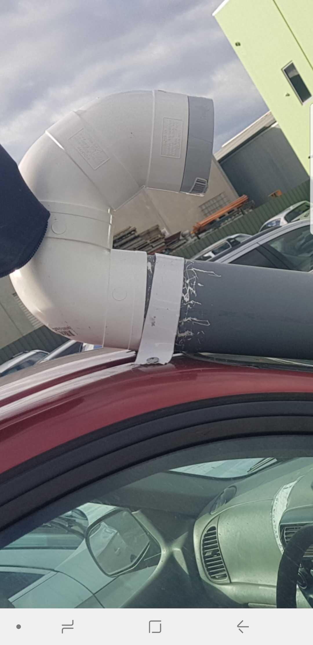

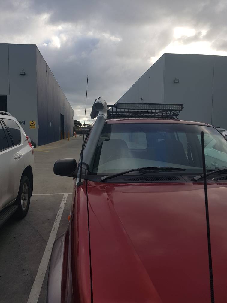

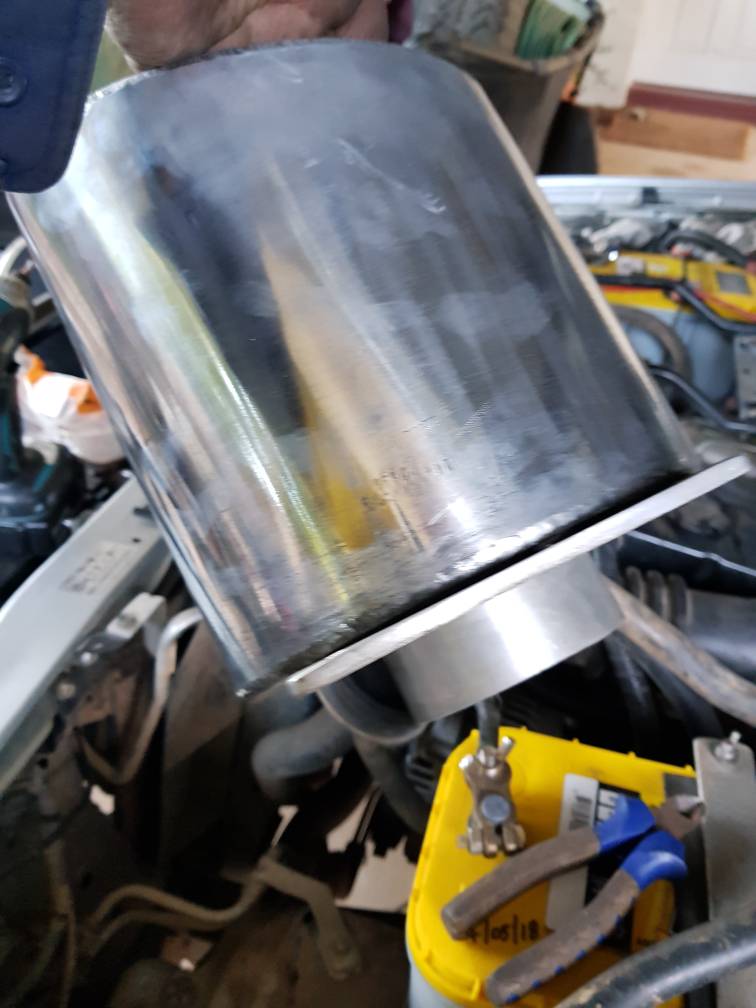

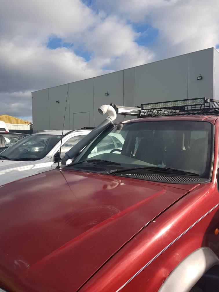

    Now my snork which i fitted the day before i saw this and thought id done ok but that bloke was next level!!!!
    This bolt was a bastard!!!!!!!
    No guts no glory!!
    Gained 5psi and a Growl of intake induction noise!!! Sik

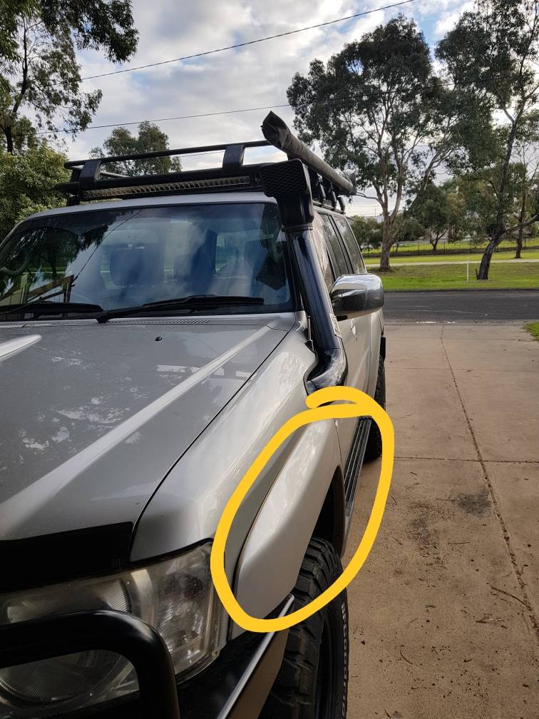

    Seen this on the weekend, looks pretty nice. Looks different in person though, especially this spot
